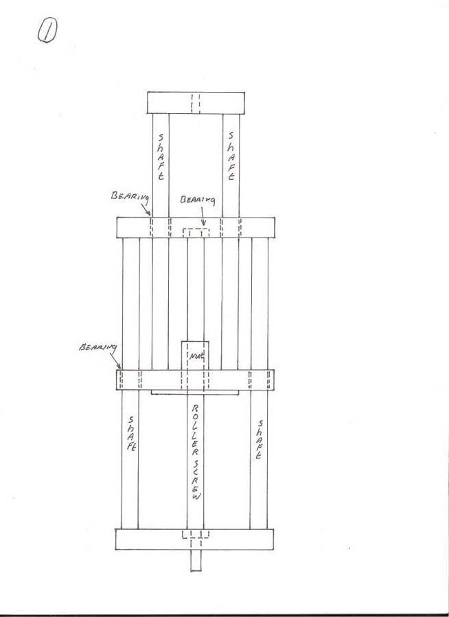

    If we really would like to work out another actuator, the concept has to be really sophisticating this time. I dont want to make another toy, that looks pretty cool like our stepper actuator, but ends up in being too slow and too weak.
    I dont think that we will be able to achieve speeds above 150mm/s with metric screws and steppers.
    Your concept for the linear acutator seems to be good, but you wont be able to use steppers, if the screw pitch is 5mm.
    In that case (5mm pitch) you have to use fast DC motors, and gear them perhaps via a belt and pulleys probably.
    I think you should go for DC motors, and try to assemble such a linear DC actuator with metric or screws. As well the interface (Thanos AMC1.5), to control them, is available yet.
    If you rather want to use steppers, then you should use ball-screws with a pitch >10mm.
    I know the specs of the FD and SCN5. I just wanted you to see what you have to achieve, when you want to build something serious.

    First off all, the screw pitch can't be more than 10mm fore a scn5.
    Rolling reducers are the best but you have to stall,with sliding ones you can stall,but they are less efficient so you
    need more power.
    With sliding screws you must stay under 1500rpm,so you need lever arms to speed up (2e drawing)
    The more lower rpm the better it is.

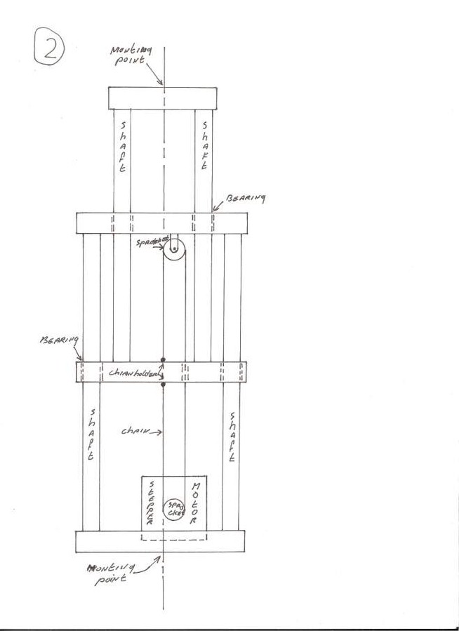

    if we want to talk about 300-600cm linerar acutators, and if we want to stay under 1500rpm, then the calculation is the following:
    max 1500rpm/60 -> max 25 rps
    25 rps * P-5mm = 125mm/s -> quite slow
    25 rps * P-10mm = 250mm/s -> ok for GA flight sims
    25 rps * P-15mm = 375mm/s -> good
    25 rps * P-20mm = 500mm/s -> very good
    25 rps * P-25mm = 625mm/s ~ speed in the FD league
    Either we use higher rps, or higher pitch. Higher pitch requires alot of torque. Higher rps causes alot of mass inertia. -> Dilemma :D

    I made some drawings from some ideas i have
    Drawing 1: ballscrew actuator, motor not worked out.
    Drawing 2: Chain actuator ,far cheaper, meaby stepper range.

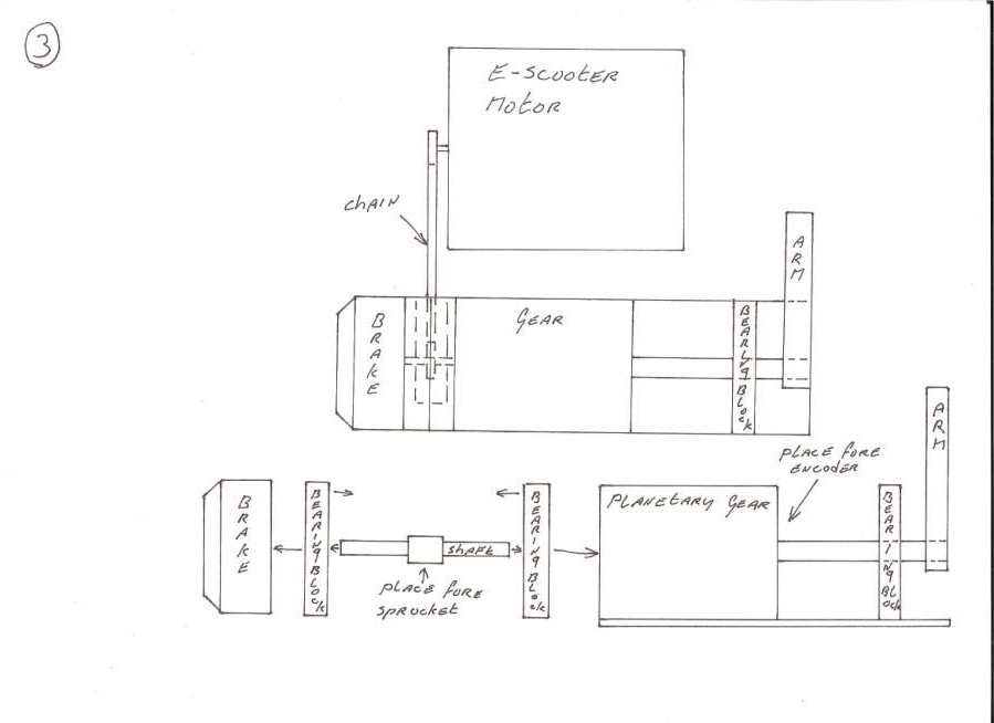

    Drawing 3: gearbox option with brake.
    Fore this i used the Banebots planetarygears they can handle 115nm max.
    They have great shaft options, and support blocks and are cheap.
    http://www.banebots.com there big series.

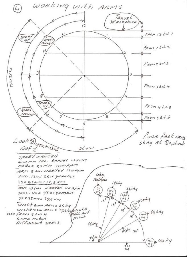

    Drawing 4: Some explaning when you,re working with arms,there is a catch with it, i hope i made it clear
    with the drawing
    I did some asking about steppermotors, they lose speed on load,ther torque curve is inportend
    need to be flat fore accelaration.
    They told me ,allways take far more force than needed ,and you wont get disapointed.
    Whit this in mind i did take a look @ nanotec,And find low cost planetarygears (30nm max) fore 90,00 euro
    They have more steppermotors options fore the gears,And come to 30nm holding force (30kg on 10cm arm)
    and 10nm by 60rpm (10kg trust with 600mm sec ,10cm arm)fore 125,00 euro Gear and stepper.
    I cant tell you how fast they will accelarate and brake, but you have fare more trust than needed fore a simforce gt.

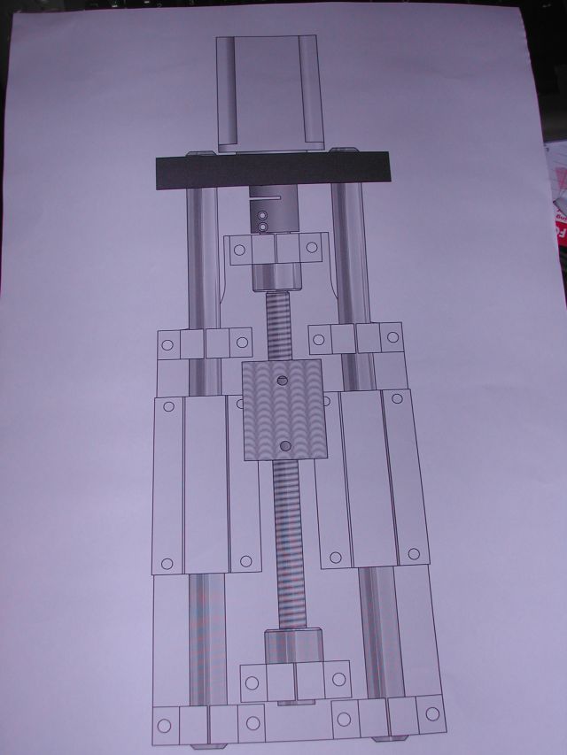

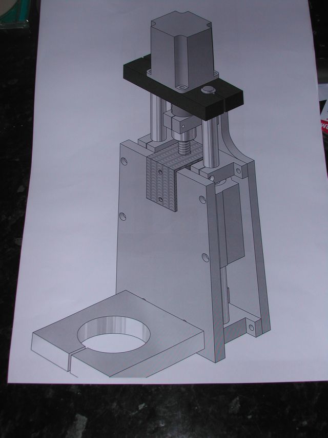

    :hi: Ad Glad to see you back here ... nice concept drawings .. becuse of the work i did making my cnc Router iand looking ofr a better DIY actuator for initially my Fight Simulator i also designed a Actuator similar to your 4 Skecth but came unstuck when i read the stuff you wrote explaining the limitation of stepper motors speed and power wise :( but i will post my autocad inventor drawings when i get back to work on tuesday... the other design that caught my eye was the one with the chain drive, Ian at Builtforfun has published plans for this design for free and i looked at that and was trying to combine thw best elements of bothe designs into one ( with DIY Building in mind ) will post Picyures of my Z Axis of the CNC machnie later today. if you look at it and remove the stepper motor and substitute it with a DC servo Motor then i think we would get better performance and get around the problem of backdriving ( Freewheeling with power off ) gonna go take some shots to post .... Nice work

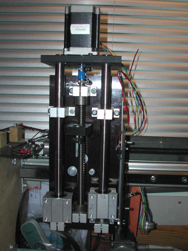

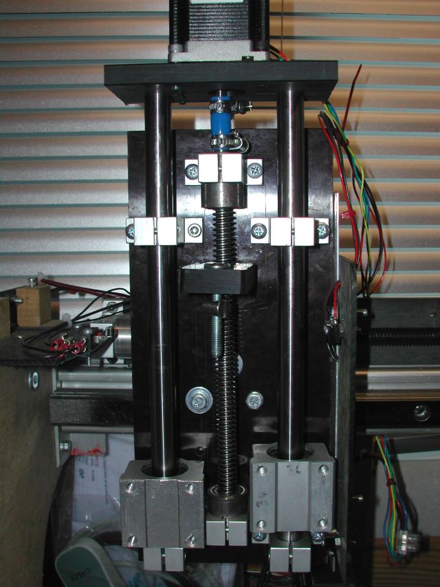

    Photos of Z axis to show were not far off in Similar design ideas but you understand the maths better and thats what missing for me :uups: for the DIY builder this design is made up of mainly off shelf items ( CNC Linear rails, Mounting blocks,and ACME leadscrew ) would like to take on board your ideas and replace the stepper with a DC servoMotor arrangement as i belive this would make this a workable option for stronger and quicker DIY actuators... Feel free to voice any opinions or problems with the deisign ( CAD drawings will be posted when i get back to work ) Just re-read your post and can now see your approach makes sense . i also checked out some info on me=oer expensive linear actuators and most if not all them seem to use DC SERVO MOTORS .. question is this the missing link? as you have showm stepper motors can be cost effective but not quick enough or at top speeds they loose too much torque and can skip pulses.. is there any way we can hook up a Stepper motor with feedback to make them in effect a DC Servo motor? or is it better to just get a scooter Motor with Position feedback and gearing to give us the speed/ power we need to make the leadscrew /nut option work as in skecth 4 :highfive:

    I am looking out fore your cad drawings.
    One thing to keep in mind.
    Making a actuator ,you must allways stay in line
    When you are going out of line stay in balance (thats why i use 2 pushrods)
    Ian made this mistake :explaning:The single pushrod carrys wight and pushes down,The shain is,nt inline and
    give forces to the sky,RESULT,the wooden slider want,s to turn, the holes in it will wear out, ore wurst the wood
    will split.
    Your nice cnc axis,is out balance and line to,Result it,s want to bend ,the bearingblocks will get big hits.
    The outside shafts must only be fore giding nothing more.
    Regards Ad

    There is nothing wrong with your z axis
    Force = speed x wight
    There is no speed with cnc
    It means only ,when you cut to much at one time,you wont be precice
    Regards Ad
