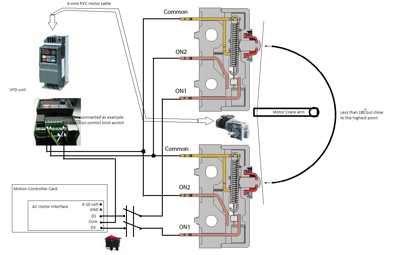

    Hello again Speedy,
    Wow. Thanks for the very detailed drawing.
    Correct me if I'm wrongs here.
    1. TWO push-button switches, PER Gearhead, one to reverse at top of stroke (If gearhead goes past 180 degrees) AND one to reverse at bottom of stroke (If gearhead goes past 0 degrees) ?
    2. These push-button switches are normally open, closed if gearhead goes past the 0 or 180 degree on axis.
    I'm going to do a "mock-up" of my motor placements and post a picture - showing pots and crankarms - let you folks see if I'm making a mistake / or / need to modify. After I get these in a
    mounted, solid and stable position on the platform base - then I'm going to have to come up with some type of "fixture" to hole the switches.
    Thanks - I have saved the drawing to my "build pictures" folder - named the pic "Speedy's Limit Switches"......
    Tom

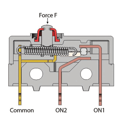

    Correct but there is a big deference between limit switch and the push button ... they are made with a lot more acurate and spics ... life saving switches you can say ...
    plus limit switch are two way "electrically " always closed on some direction ... Normally closed for a default direction [Common & ON1 ] ... then ... if motor is OFF working area then [Common & ON2] ...
    Applying-mechanical-limit-switches_Figure_01.jpg images.jpg facn_wilbrecht01_oct2009.gif

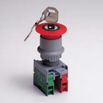

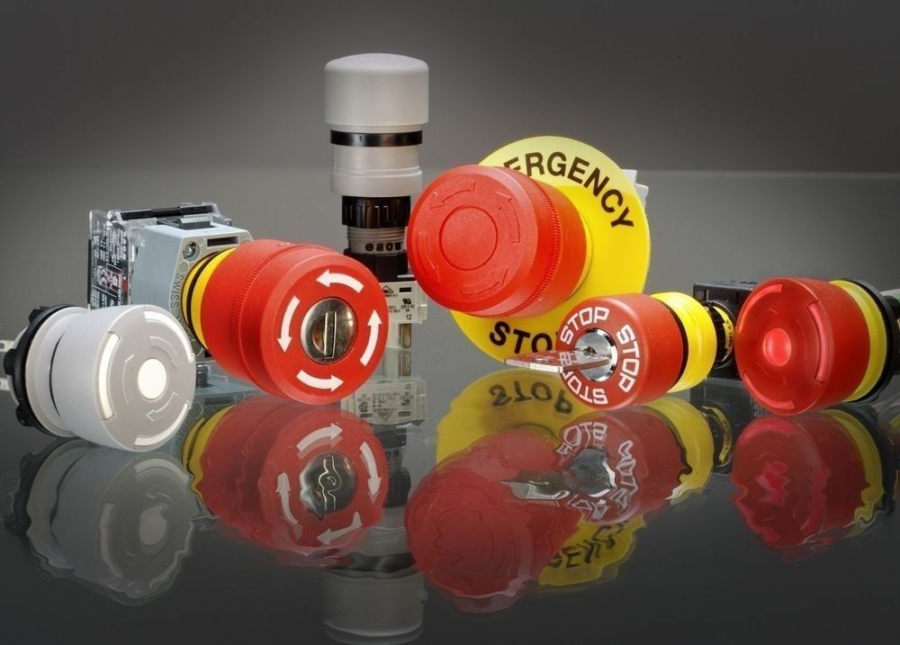

    So here is my suggested additional Panic Switch connection ... down there "the red small switch in the next picture " sorry there was no room to put it full size .
    here are some Decorative/Industrial examples of a Panic, Kill, Emergency, Stop ... switch .
    1fd08252-b7b7-4f9a-9212-c58247d697da_eks.jpg emergency-stop-push-button-switches-9307-2606973.jpg
    doh.gif Edit: Question ... How we are going to use one switch for a three VFD's?

    Hi Speedy,
    THANKS friend. Those are the type of "Panic Switches" I've seen on most of the professional ones over the past three years.
    As I asked in post#106, What do the professionals use - I've never seen even one using the STOP Switches on the lever arm as you have outlined.... IF they were using internal encoders on the motors, would
    this be the way they are doing it??? I'm reaching here, as again, I'm in an area that I know minimal about.
    Speedy, just due to mounting issues ,(am I am NOT there yet - but looking and speculating), I still like the idea of one KILL SWITCH mounted beside me on the platform top. I know you said it would take
    two seconds for the rascal to stop by using only this method, but "me thinks" that would be ok......AGAIN, "me and me only, thinks".

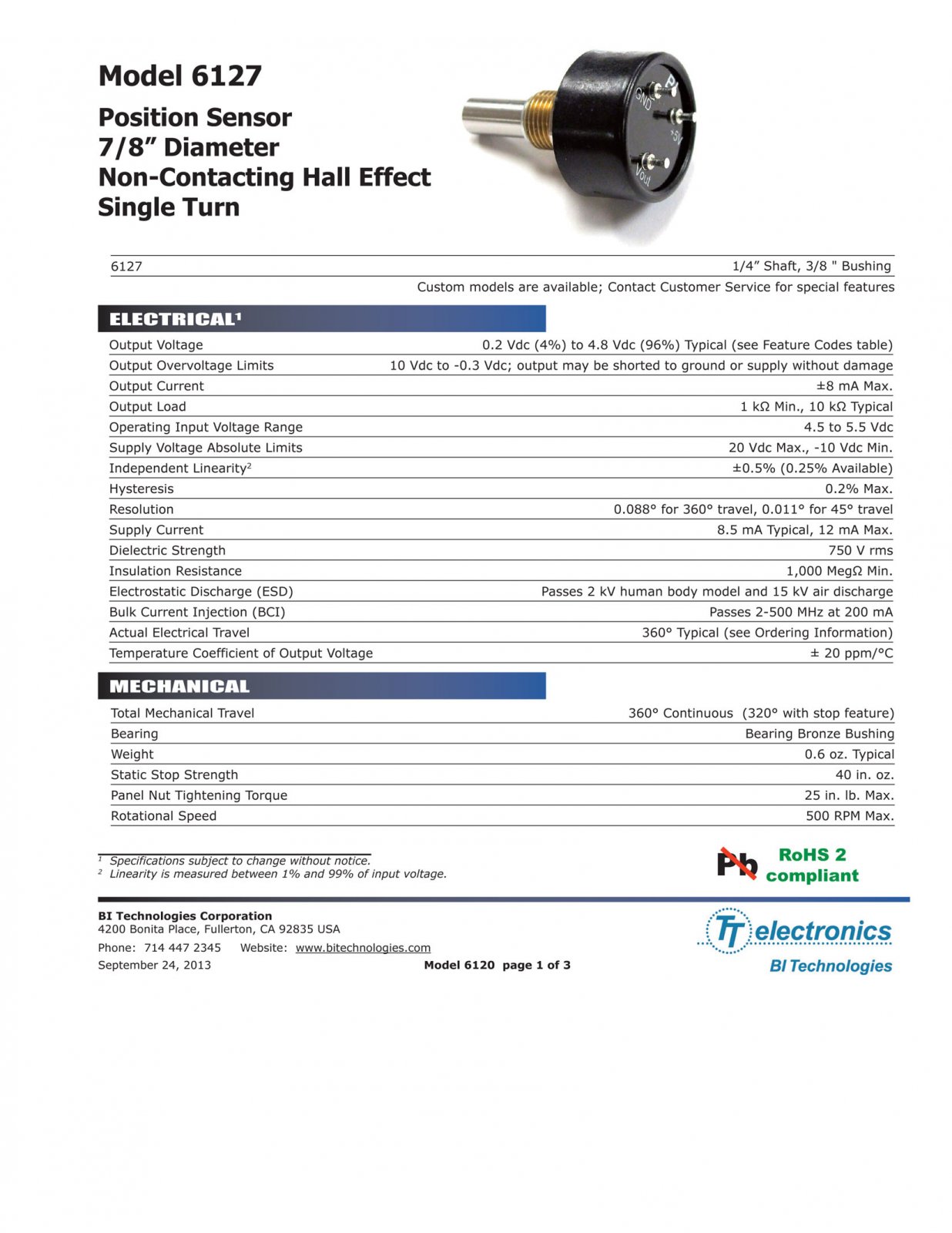

    Attached is a pic and info of the pots I have purchased for the gearheads - Simple ?? - What type of "connectors" are used on these type of male terminals coming out of pot???? I've looked and not found
    them or even what type they are called.
    Your continued help would be appreciated.
