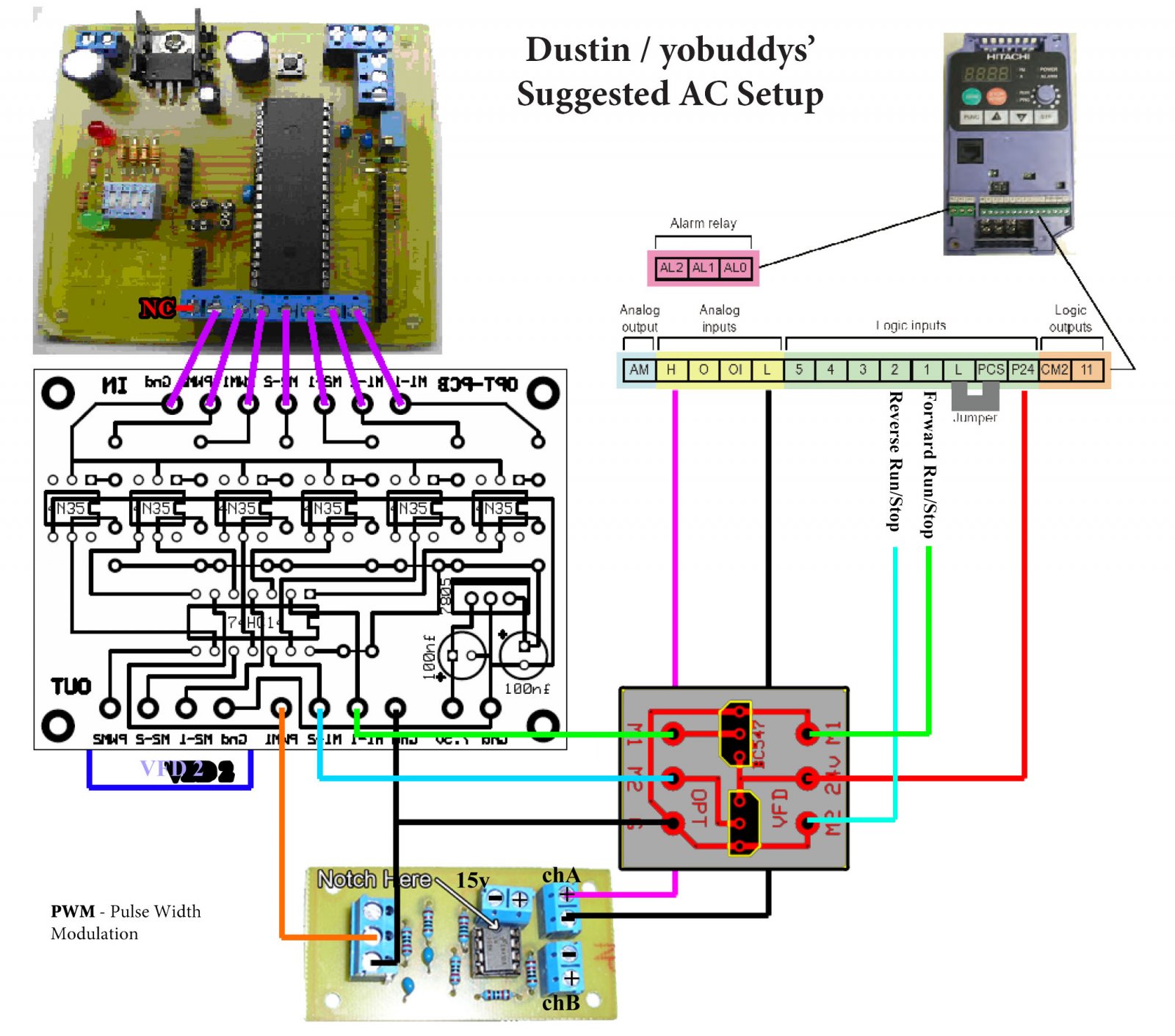

    Guys again,
    You all just have gotten me too excited.
    Yobuddy, hopefully, with your permission, I'm going to place your wiring diagram picture here - KEEP IN MIND friend, THIS picture is what got me off my butt and building - All your wonderful fault.
    Thanks to all,
    Tom

  17. yobuddy
    51,533Coins
    +5,204 / 19 / -0
    Incase you guy's didn't notice, the controller in the wiring diagram above has the AMC EZ in it and not the SimAxe.
    The AC electronics should work with the ARD, SimAxe, AMC EZ etc…
    It should work with any controller that has one pwm and 2 dir outputs per motor channel.
    I believe I have finished a PD and full PID firmware for the SimAxe. But it is pretty much untested and I would not want to test firmware for the first time on a high powered AC rig.
    No matter what we use we would want to setup everything without the motors connected to the top of the base. Then we can visually check the output before moving forward.
    So while the AC extra stuff needs to be built, we could try an ARD, AMC EZ, and a SimAxe to see what works best.
