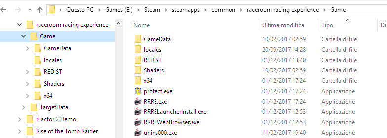

    Raceroom had a big update also adding a second .exe for 64bit and now we got no motion on either, just letting you know they broke the plugin :(
  10. yobuddy
    51,739Coins
    +5,205 / 19 / -0
    @Daguru
    Does SimTools ever turn blue when the game is launched?
    What are the new exe names buddy?

    There's a new folder for the 64 bit (x64)
    32 bit is still in Game folder

    Yes it turns blue for a second on the original RRRE.exe and the extra .exe is called RRRE64.exe hope this helps
