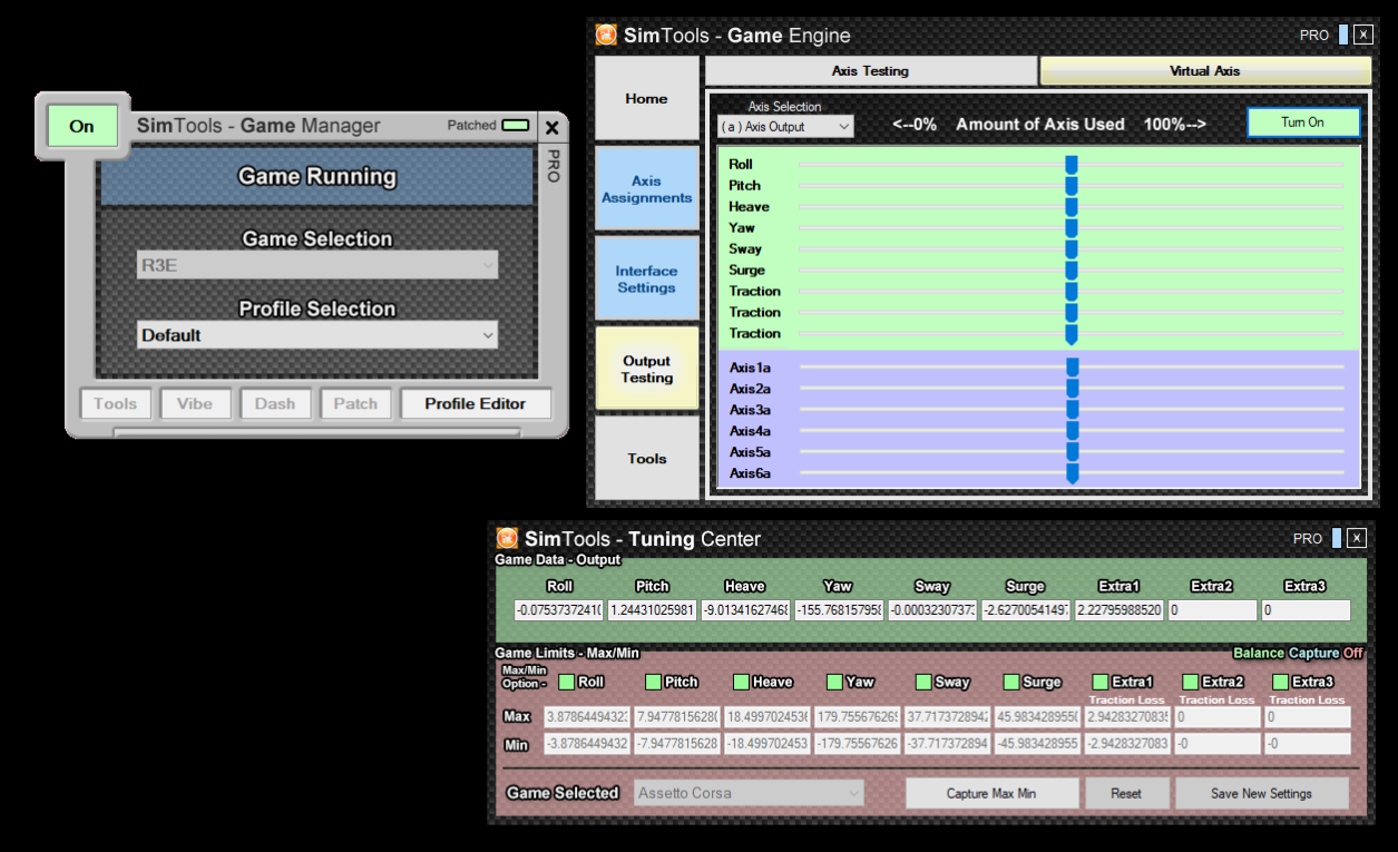

    I have a strange issue today (ok, yes I have strange issues everyday).
    In R3E I get wildly fluctuating game data output. This flickers my axis back and fourth so fast that I popped a 20amp fuse in one motor. And this was while driving in a straight line (yes, I can drive in a straight line....sometimes).
    Yesterday it was fine, nothing changed that I know of.
    Here is something very odd; notice in the tuning center that it says that the game is Assetto Corsa?
    I tested Assetto Corsa and capturing Min/Max in R3E does indeed change Min/Max for Assetto Corsa.
    Assetto Corsa is not showing any unusual behavior.
    Ideas? Did I screw something up (again?)
    EDIT: I rolled the plugin back to the pre-vibe version and still am having the issue.
  9. Historiker
    2,163
    9,212Coins
    +2,177 / 19 / -1
    Update: I manually deleted all plugin information in user/[name]/appdata/local/simtools and reinstalled the plugin. That fixed the issue.
