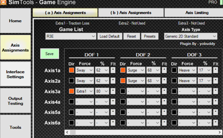

  18. Ahmad Said
    Ahmad Said New Member Gold Contributor
    Dec 11, 2016
    17
    Malaysia
    208Coins
    2DOF, 3DOF, SCN5
    Hello, Need a little help on setting up traction loss (extra1). I did this before but had to reformat windows and redo everything. In tuning center, I am having some values from Extra1 when the car is at the pits. THis makes the traction loss wobble back and forth. Below is the screenshot how I set up Axis Assingments. everything works in Output testing the way it should be. Is'nt Extra1 suppose to be dead 0 when the car is not even moving? even when moving in a straight line no?
  19. noorbeast
    22,202
    154,675Coins
    +11,209 / 57 / -2
    You likely need to refine the Tuning Center values, do Extra1 by itself, with all other axis turned off, see tips here: https://www.xsimulator.net/community/faq/traction-loss-in-simtools.175/
