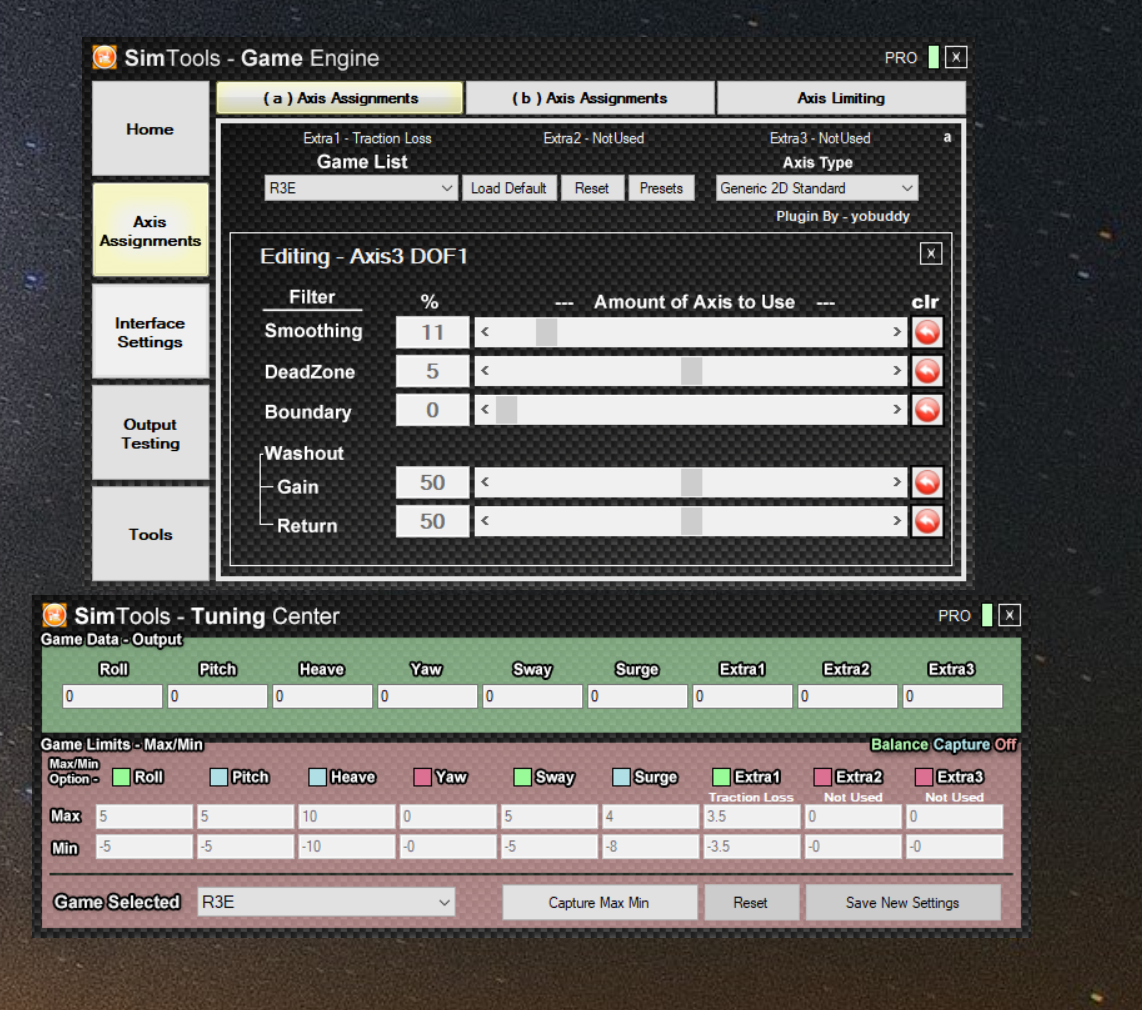

    I got it to work somehow. fiddled with the limits a little made it behave. When capturing max/min in Tuning Center, I got the Values to be 15/-15. But this has less effect when driving, had to really put an effort to bottom out the TL. I end up using 2/-2 for extra1, this makes the driving experience super sensitive, which I very much like. I am using 3 x scn5 btw. Cheers

    all other effect are 20% ?
    roll 20%
    pitch 20%
    heave20%
    yaw 20%
    sway 20%
    surge 20%
    100% max per axe

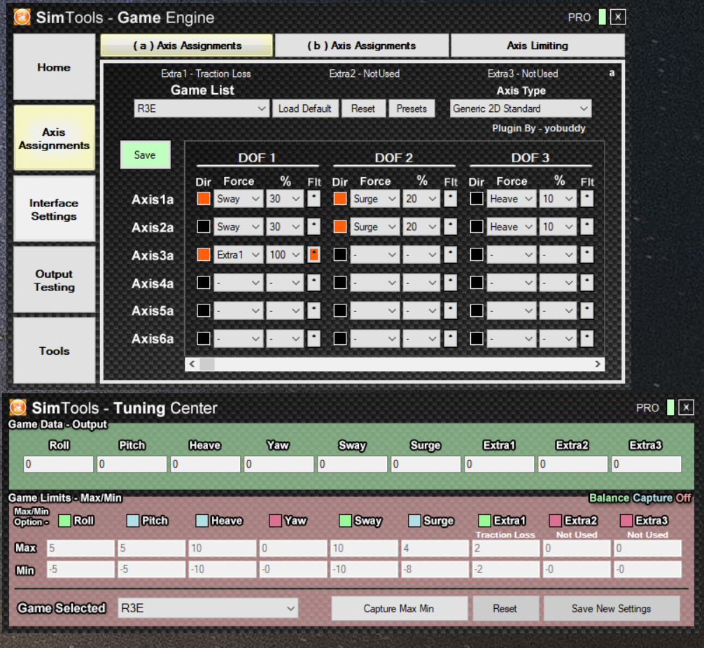

    This is how I do it (see picture) Roll and pitch are both 10 each btw.

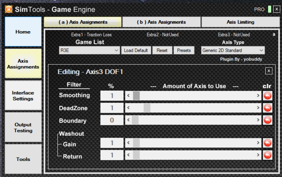

    I ended up using this
    roll 20%
    pitch 20%
    heave10%
    sway 30%
    surge 20%
    extra1 100%
    exta1 Filter:
    Not sure about the washout as I think I need to play with it more. But overall now I like it. I am using VR and it is really difficult to tune TL while in VR

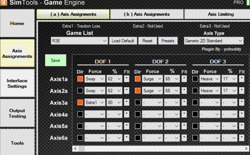

    This is I think the setup I like after a few hours of experimenting with extra1 filter (below). Hope this can also help others like me out there with similar setup as mine
