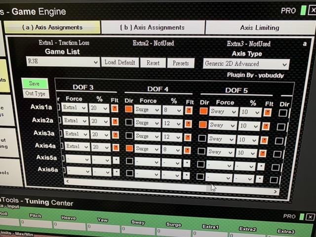

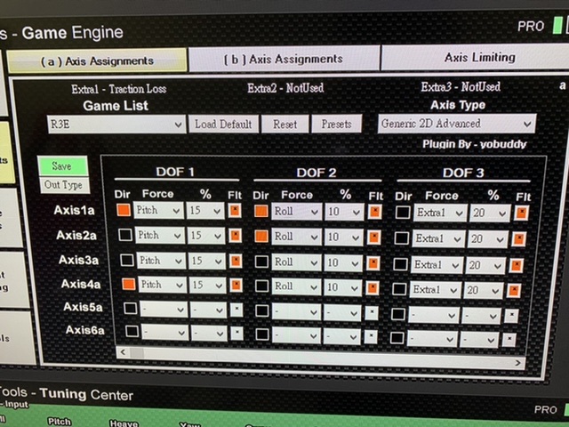

    But it seems lack of nose dive when braking, whatever I set the surge with different direction, gas and brake are always dive into same direction which is not correct, please fix it

  14. JasonHim
    JasonHim New Member Gold Contributor
    Dec 21, 2018
    14
    186Coins
    Here they are
    F67201D4-C1C0-4557-AAD9-B56D8ABCE5CE.jpeg 7409ACE8-6EE4-400F-A85B-6F797E2FB62E.jpeg 115D5706-E793-49C8-AA2B-E3ECCF786818.jpeg

    If there have been significant game updates @value1 may need to review the plugin when he gets a free moment.
