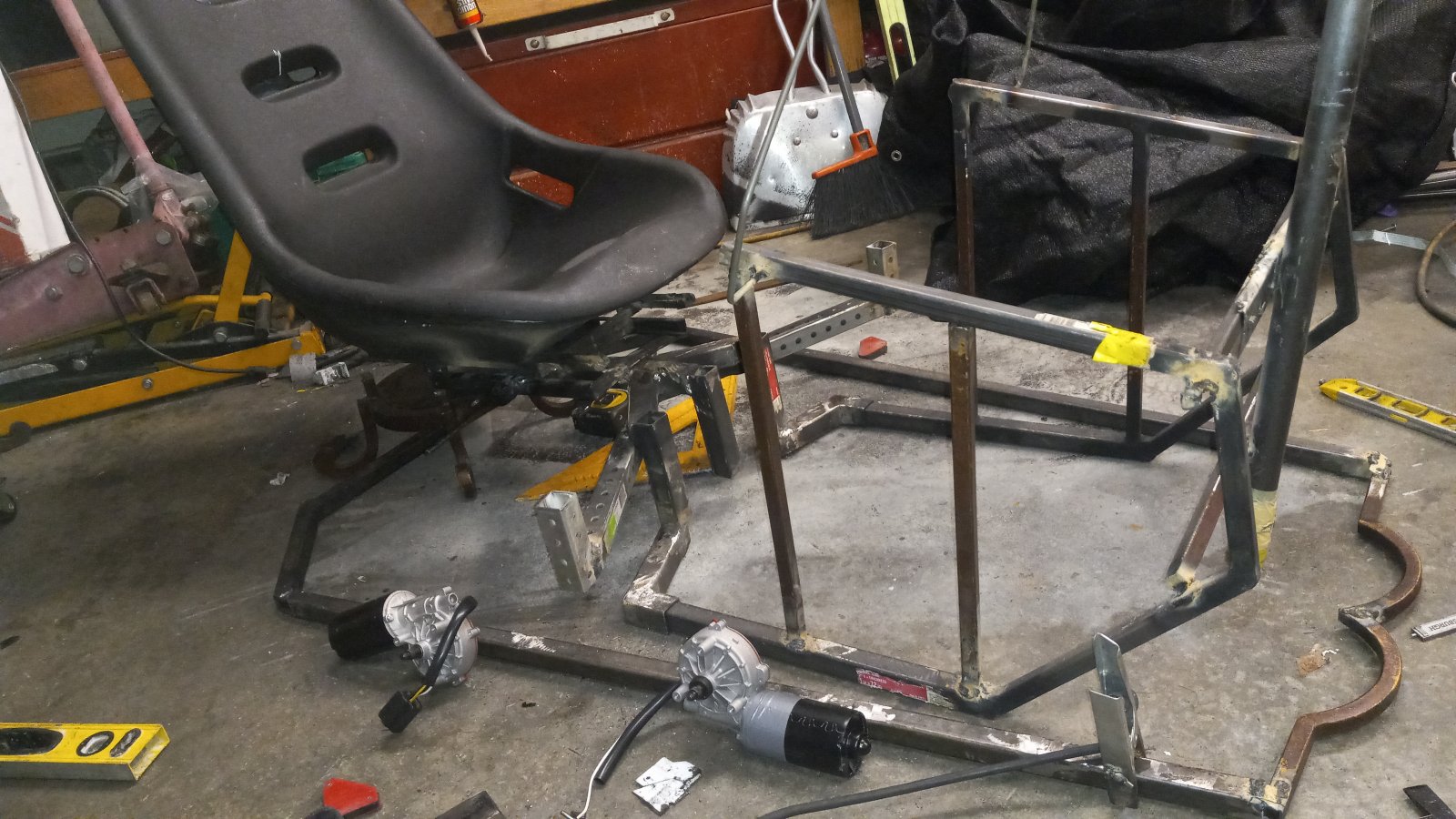

    Ya your right. Ok thanks an 20220214_222208.jpg yway. Heres my progress so far. Im just gonna use brand new mercedes wiper motors till I can get some DC motors. I had already bought 6 of em from ebay when Id asked you ;)

    my first sim was a 2dof
    for the 6dof I decided on the floor frame size and just went ahead and built it
    i figured i had spent enough time thinking about it, i just needed to get on and do it

    I use 2x 24v motors 800w for each actuator

    6 x 800 watts
    I use 2x 12v car batteries and a 25 amp 24v power supply to keep them topped up
    the motor drivers are 100a each and can handle 200a for short periods of time

    most modern 12v batteries are sealed and do not give off any vapour
    I did use some powerful sever power supplies, but they did not like the regenerative loads. I even tried a snubber diode - it got very hot !
    you can buy a 12v car battery brand new for very little money, I always seem to have some lying around.
    I used a set of jump leads to provide the power to the motor drivers - again very cheap brand new, available in long lengths and up to 500 amps.
