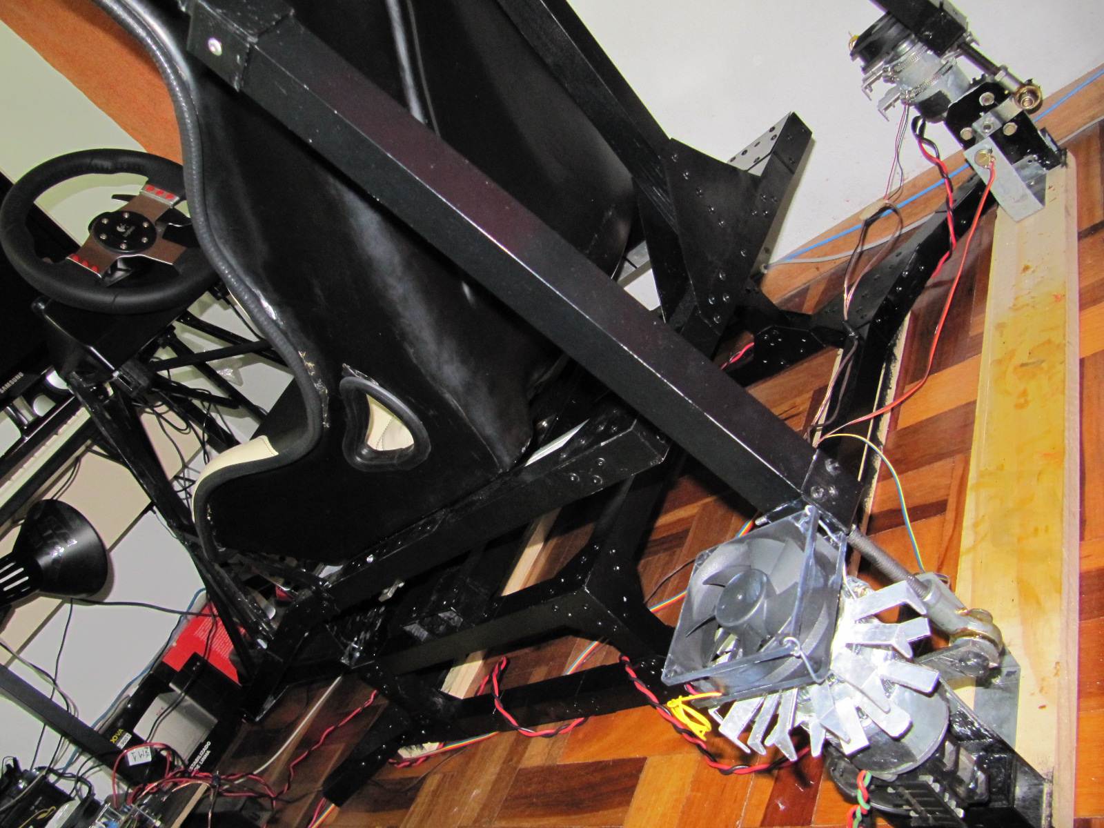

    Hello!
    I saw here in the forum one thread where someone placed on case fan over the wiper motor for cooling it (I can't remember who did).
    So as I am improving my profiles (thanks to Nima!!!) it started demanding more of the engines and the heat has come together!
    So I decided to place one heatsink on the motor plus the fan.
    It works very well altough I was out of aluminum so have just a few of it.
    In my first tests (one motor with and other without) temperatures drop from 75ºC to 45ºC average. And I believe that with it done better (entire pieces not the scraps I made) temperatures should drop more. Even a third row could be there.

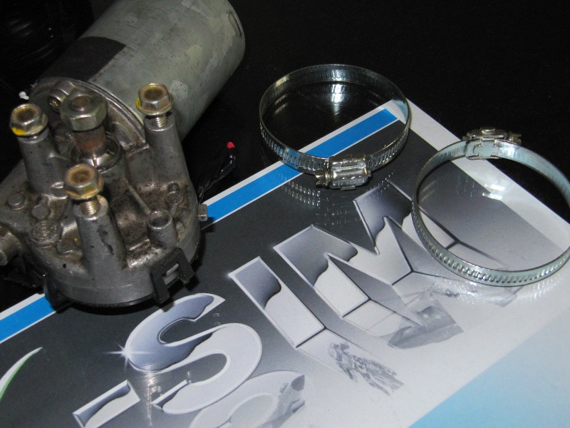

    You will need:
    thermal paste (put loads of it so buy the cheap one), peaces of aluminum, brace clamp, and the fan.

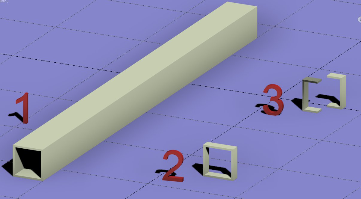

    This picture shows how to cut the aluminum to have the best layout:
    regards!
