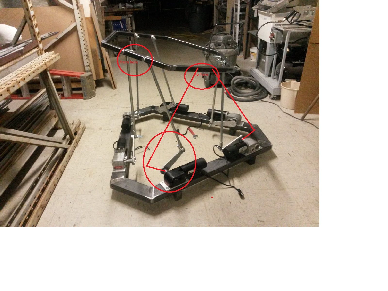

    i would suggest flipping the levers 180 degrees to the outside. this will give you more stability, leverage and will lower the platform some. although ill bet you have to still trim the rods by at least 1/3. looks good so far tho. i like the custom aluminum work, very fancy.
    EDIT: I see that flipping the levers would change the orientation of the upper platform. I do believe this is necessary. the connections for the motors should be parallel. this would reorient the top about 120degrees in either direction.

    also those heim joints will wear fast introducing slop. i suggest tie rod ends from the auto industry. I started with heim joints and quickly wore them out.

    Thanks @bruce stephen! We chopped the rods down quite a bit and also made the upper platform a little smaller (we still have the original just in case). I was going to go with tie rod ends until I found these heim joints from QS Components. We might end up with tie rod ends anyway. Should be pretty easy to switch over.

    I have 12mm heim joints and they have been working great for over 18 month ;) No slop and nice and sturdy

    You can tell why there haven't been many updates, but the progress has been tremendous. We have taken advice from the group here and shortened the arms and flipped the motors. It is incredible how stable this thing is now. We have fully tested the new controller design and it is amazing to say the least. We opted for individual cut-apart controllers printed on a single board. This allows us to keep the power supply leads and motor leads very short. We used 100 amp FETS on the H-bridge and it still contains the majority of features that the previous board design had. WiFi communication on this thing is near flawless.
    We made the levers 6 inches instead of 8, as we were blown away by the amount of motion that 8 inches brings. I think many of us started with this thought: lets make the levers as big as humanly possible to get crazy motion. Well.....DON'T. Not only is it not necessary, but it is downright uncomfortable. Also, don't fall in the trap of saying: we can make the levers huge, but we can tame it down in software... that's just a waste of precious power.
    With the current setup, we are able to lift well over 300 lbs and the power supplies, motors, and controllers don't care. We have not found the upper limit to how much we can lift, and probably won't any time soon. we allowed for a 100 pound cockpit, but using aluminum box tubing, I have that number down to 20 pounds on just the metal. Add another 20 pounds for the TV, 13 pounds for the seat, and around 15 or so for wheel, pedals, shifter ETC. That's 68 pounds with plenty left over for a human!
