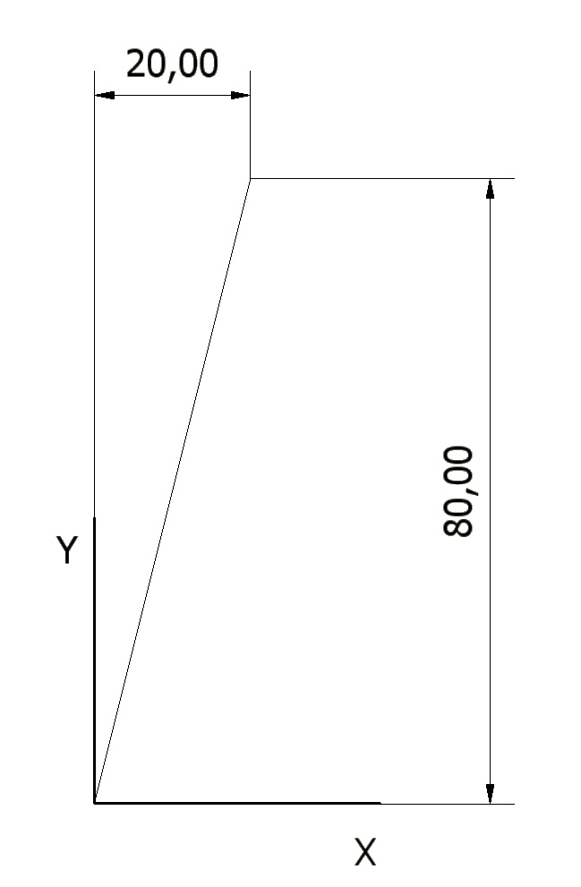

    And some another small OT,(its hard for me to describe it by englis so please be patient with me) (its probably no problem for simple or symetrical sim) i try to describe it on example of cnc machine, if you have linear motion like on picture pohyb.jpg than move in X and in Y has different speed to stop in final point simultaneusly. How would X-Sim deal with it ?
