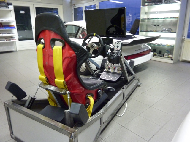

    Ik zie dat je de neus van je 959 instelbaar hebt gemaakt met een stoel slede.

    Dank je Ad, wat bedoel je met 959?
    Moest wel iets verstelbaar maken anders wordt het zo lastig met lange mensen ;D

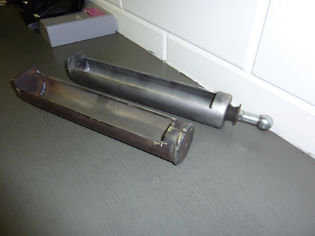

    Hi Mike..
    Finally the pic of the scn5 holder..
    Put a rubber in and outside.. I have some different rubbercompounts to test..
    Can also faster the nut to set the rubbers stiffer.. First need to test..

    Nice work Ralph. That looks like it's going to workout really well.
    Thanks for sharing.

    Do you want to capsulate your actuators complete? When you do that, you should think about a cooling solution. After some hours of driving the actuators could become hot and shut down after a critical temperature.
    I am also interested if your SNC5 holder reduce the noise of the actuator. That yould be a big advantage! So keep us updated :cheers:

    No I don't capsulate the whole cilinder.. Only half.. I put some foam in the tube for the sound.. maybe it works...
    I'll keep you updated..

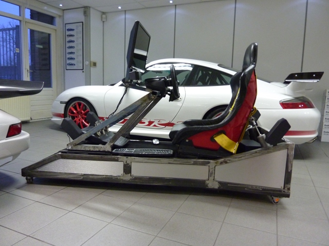

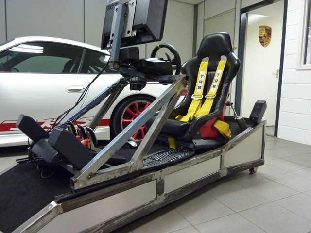

    Update;
    Hi Guys,
    Here a update
    Put some brushed alu plates around it
    Logitech x540 surround set
    Replace the monitor mount for a nother one.
    Computer build in
    Floorplate with some carpet en a little door in the front for the computer.
    I think te next week will the scn5's will come.. (waiting now a month) :eek:
    Some special backgrounds for chris!! srry! :cheers:

    Looking good Ralph :)

    Looks good.

    Nice work...i would paint it in white ... with red stripes ... that fits perfect to the GT3 in the background :D

    I have to say, I'm a little concerned about the placement of the SCN5's on your design. They seem way too close to the pivot point. You'll get a lot of speed, but not enough power I think. You may be in danger of over stressing them.
    Have you considered using SCN6's instead? They might be much better suited to your design.
    Also, after looking at your holders for the SCN5's, you may run into trouble getting to the back 2 bolts at the top. Consider cutting large access holes (enough to get a hex wrench in) to ease installation.
    All together it's a great looking design. I definitely see some Motion Pro II design cues in there...... :)

    If you are looking to Nima's (niels) his old sim the scn5's are standing al most 90 degrees.. I tested his sim.. It was working realry great.. First i wanna test my design with the scn5's...(I thinks this week they will come) I'am just 60kg, I think that will be good for the power.
    Let you know the test results..
    The Design is a little from your Motion pro 2 and a little form this forum and a little from myself.. :)
