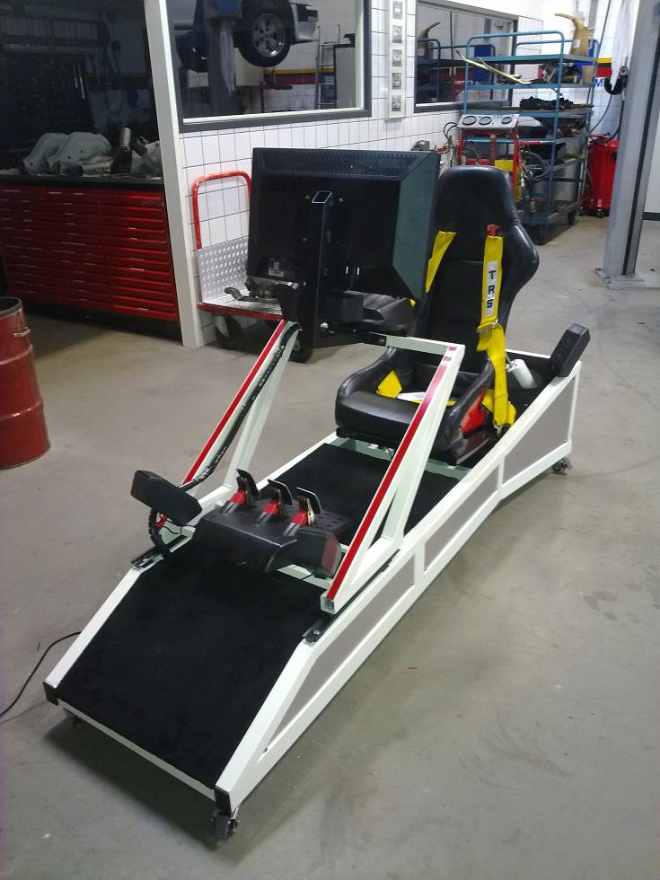

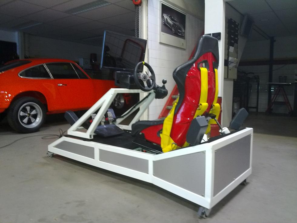

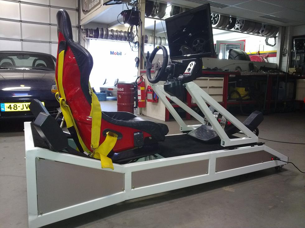

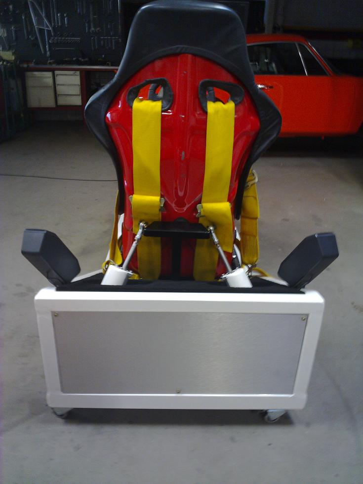

    Hi Guys...
    Today I finished my sim project... Was a little busy with working the last time..
    Here the final results pics;
    Feel free to comment!!
    Do someone have experience with the fantec GT3rs wheel and clubsport pedals?
    Maybe want to buy a set...

    Jakob:
    The seat is a original 993 RS seat.. It's hard to find... If i found a nother one.. I let you know...
    Mike:
    That's the plan... but it cost a lot of money.. maby two more 24 inch's.. but i think that will be to small.. like your screen set up..
    I have also a AP pedal box left.. maybe build that on.. or the fanatec clubsport pedals.. do have anyone experience with those pedals?? I have now put a stronger spring in my g25 brakepedal.. feels a lot better but not realistic enough...

    @mike
    I put my pedals on a angle.. not straight.. I feels okay for me.. (see pic)
