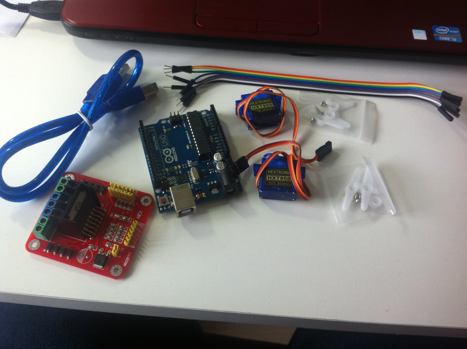

    Sorry not sure if total understand what you are trying to say, possible you could show a pic or two, better than words.
    9v's attached to RC servos will kill them, if using a 9V psu please only plug this into the ard and the +/- ve of the servos will need to plug into the 5V and the GND of the Ard as per my picture.

    rsrsrsrs! I said u would be working with me! I see what you mean ... I do not connect 9v direct the servants but in Ard ... can let follow your instructions!

    That's what we are here for Mate , follow my simply wiring diagram on first post and plug the 9v into the Ard via its jack and all will be good.
    The Ard has its own 5V regulator on it which will filter the 9V to a steady 5V that the RC servos need.
    Do a Google search on RC Servos connected to the Ardunio for more information, plenty out there.

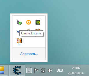

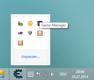

    Hello @ value1. I can not open the GameEngine and GameManager ... I installed the plugins, and shut the PluginUpdater when I click on the icons appear on the answer "GameManeger is already Running!" and stands, not opening any other screen. This also happens in GameEngine contecendo ... what is or what should I do?
  12. value1
    Jan 9, 2011
    2,192
    Zug, Switzerland
    14,297Coins
    +3,363 / 13 / -1
    RTFM! :grin
    The programs are hidden in the task list.

    hello @value1. I'm building a prototype controlled by servos. I followed the instructions from the startup tab, but I have the following problem when I do the test in GameEngine, the servos do not move, I am using the wiring diagram suggested by @eaorobbie, with Ard and 2 micro servos, because when test the cursor movement which nothing happens ..... Ard code should I put in, because I installed the ones that are available here in the post, but were not successful.:think:think

    @eaorobbie and friends! Proptotipo gained my life! the servos are working and the first tests were a success! I'll ride the mechanical part of this miniature and put videos of him working! Thank you for helping me .. I am very happy and excited!
