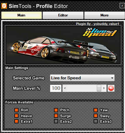

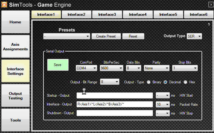

    Hello everyone and thanks for helping with the info. I am new to this fun hobby and I did finally made servos to work with Output testing on Sim Tools.
    But when I start running Live for Speed game, I received no signal from the game at all. Could you please tell ? I notice the Arduino's Rx LED is not lighting up when running the Game.
    22,208
    154,711Coins
    +11,212 / 57 / -2
    Just checking have you patched LFS for motion in Game Manager?
    Please post some pictures of your model and all SimTools settings.

    yes please see.
  12. noorbeast
    22,208
    154,711Coins
    +11,212 / 57 / -2
    From the screenshots it does not appear as though you have patched LFS for motion in Game Manager. You use the Edit Path button to select the install folder for LFS then patch for motion.
