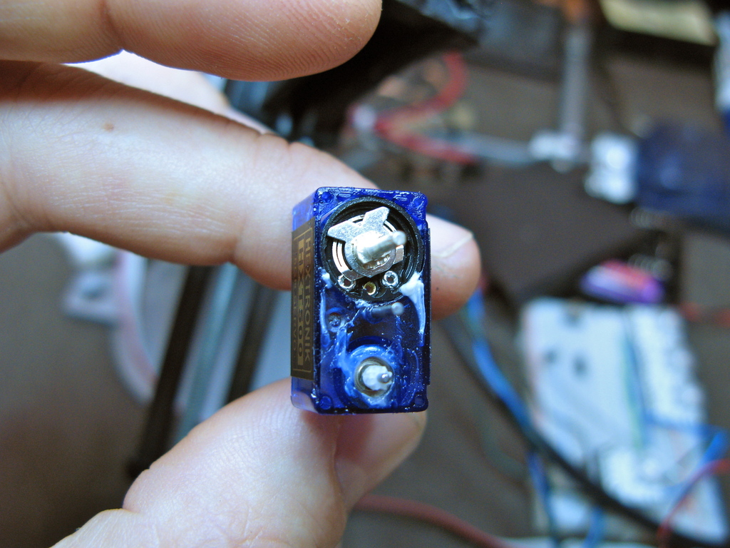

    Servos also use potentiometer to calculate position. :thumbs

    @Jun if that is the case than how come @eaorobbie's circuit on first page does not have anything going to analog input on arduino? Unless the servo has its own feedback loop?

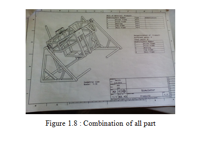

    3DOF, Arduino, SimforceGT, Motion platform
    this is my model for three axis..roll yaw and pitch...how can i got the coding using arduino ?

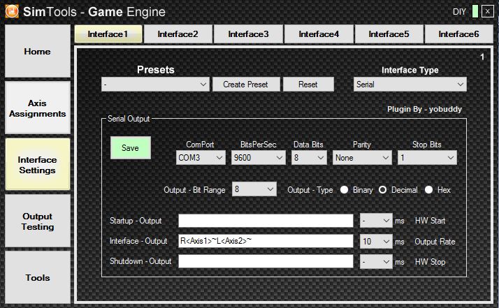

    I seem to have trouble getting any noticeable movement from my servos. Sketch is running with no errors, wiring is correct, but the only thing I am unsure about is the Axis Assignments and the Interface settings.
