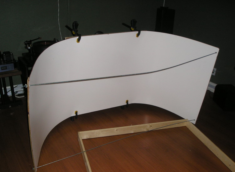

    Well the Sol7 worked as it should and the results have been very favorable.
    I will post a short video on YouTube tonight of the screen vs. the three monitor set up.
    I do have a question I am using a 60 X 48” whiteboard as my screen test material and have it bent in a smooth 180 degree curve.
    The focus is acceptable across the screen but how do I get a wider FOV from the car on the screen the PJ is putting out a 6 X 9 ratio but I can only see the windshield and not the side windows.

    I already tried just bending the edges leaving the back flat but I have found the whiteboard is not flexible enough I had to jump through hoops to get a flat back and curved edges I will post the video tonight.
    I did however take a suggestion from the wife (I hate it when she is right) and went to Fast Signs and picked up a 96 X 48 1/8 white plastic signage board for $25. It is super flexible and according to the sign guy I just need to score it, gently heat it and bend and it will keep that shape.
    I tried with an off cut he gave me and it looks very promising.
    I need to decide do I go with a gentle bend or score the sheet and make a sharp corner bend?
    What I have found is the 180 degree total curve does not work, not just the warping but loss of depth and focus on the leading edges. It is just too aggressive for a single PJ.
    I think I can go with a 30 or maybe 60 degree angle each side and retain the depth of the image and focus.
    In addition use a ratio of 40% area for the back of the screen (the front view) and 30% on each side.
    I would be most grateful for get any suggestions on what ratio to use?
    I don’t want to bend this sheet then find it is proportionally wrong, trial and error is not really an option as once it is bent you cant get it back to flat, more so if I score it to make a sharp bend it is ruined,
    Another question is does a game need a PJ with 1080P as I was going to try a short throw NEC 500WS but it only gives out 720 I only have 6-7’ throw distance for the PJ.

    nah you don't need a 1080p project, hell and 800x600 would work. computer games can output any resolution. sometimes there are problems with widescreen support and such though.
    i personally would go with the soft bend. i feel it'll keep the image more naturally flowing.
    try the projector with the soft bend and increase the fov and see what that looks like. having a higher fov should help the distortion as in my mind its gonna really make the longer image fit on the screen. curious to see the vid. definitely interested in something like this.

    You could cut into 2 or 3 rectangular wooden plates the shape you want your screen to be, and then pin the white board onto. Hammer the pins then a little into the whiteboards surface, and cover it with some white wax.

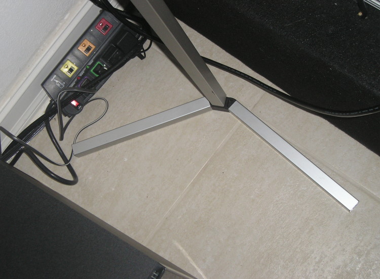

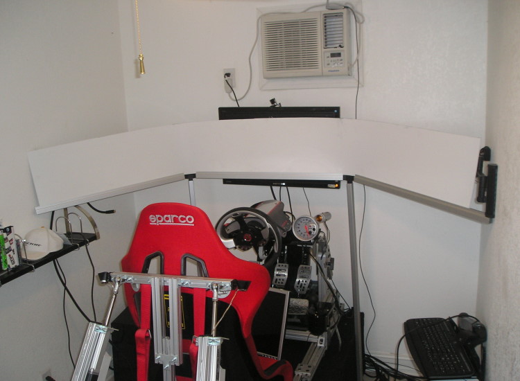

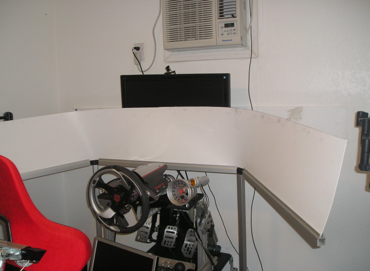

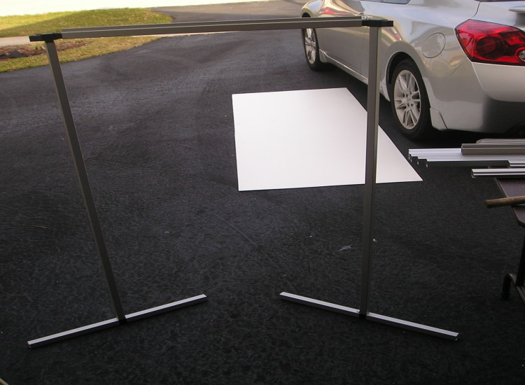

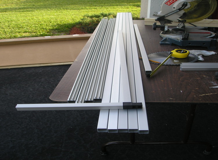

    Ok got the 8020 Frame Extrusions and started to build the screen. Exrutions.jpg
    This was the prototype but the white board was just to hard to work with. Prototype.jpg
    I used the off cut from the 4 X 8' plastic sign board to see if I should use a 30 degree connector Set up 30.jpg
    or the 60 degree to get a good angle on the sides of the screen. Screen 3.jpg
    I settled on the 60 hopefully it will not be to extreme for the PJ.
    I did not need to heat the plastic sheet as it holds in place as it tries to snap back to straight, I may try a little heat just to ease it into the bend when I use the full size sheet as I am sure it will be a little more challenging to work with.
    You will need to use an angled connector for the feet as I tried using T connectors but as you see from the photo they did not work as I did not take into consideration the angle of the top connectors.
    So I used the 30 degree connectors I was going to use for the screen they worked perfect
    Next step is to trim the extrusions to the correct length and build the rest of the frame to encompass the 8' X 3 screen.
    I am also going to build a PJ stand instead of hanging the PJ from the ceiling as I have a fan just where it needs to go also I can position it at just at the right angle and distance by using a movable stand.
    I will post a parts list when I have finished so far about $200
