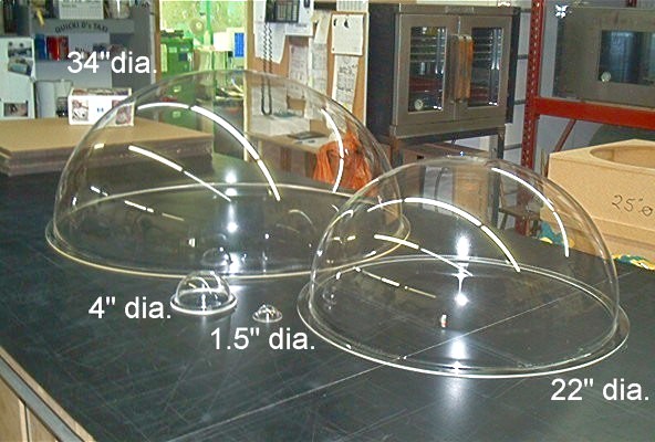

    I'm the person who has been discussing this acrylic dome display with Brightonuk...
    The size of the half-dome mentioned is 60 diameter x 30 high. Which would give 60 wide x 30 high x 30 deep when chopped into a quarter-dome like the Frex CanopyScreen. That's plenty big - in fact, I think it's actually too big and the 48x24x24 version may be better. It's also cheaper - this smaller one would work out $125 per quarter-dome and it's still bigger than the Frex.
    I have no experience of the application of rear-projection paint, but I'm sure this is the same problem faced by any surface you're painting it with?
    One question I have about the acrylic domes is how the thickness affects the image. Apparently the Frex screen is around 2mm, whereas the domes we are considering are available in both 4.7mm (3/16) and 6.35mm (1/4). Which do you think would be best?

    I Need Advice Guys
    I am fighting trying to figure what I am going to do I realy really need some advice on what direction to go.
    My two choices thus far is ether a Dome (cut in half) or an oval dome an encapsulate the whole sim.
    If I go with the 1/2 Dome I Place it in front of the sim and have a curved view (Projecting from the front) easy and fool proof.
    I was figuring 40 X 20 High
    http://www.cleardome.com/cddn.jpg
    If I go with a oval dome I have a much more aggressive curve at the front but have the option of adding two more PJs at each side to get a close to 360 degree image and an encapsulated sim.
    The size will be the 28 X 46
    http://www.cleardome.com/cd2846.jpg
    Do you think the oval dome will work? as this seems the way to go it is more challenging with the projected image and the curvature of the dome but if it works it would be an upgradable project.
    The 1/2 oval is a sure thing IMOO easy to project below are some links to the two options I am contemplating.
