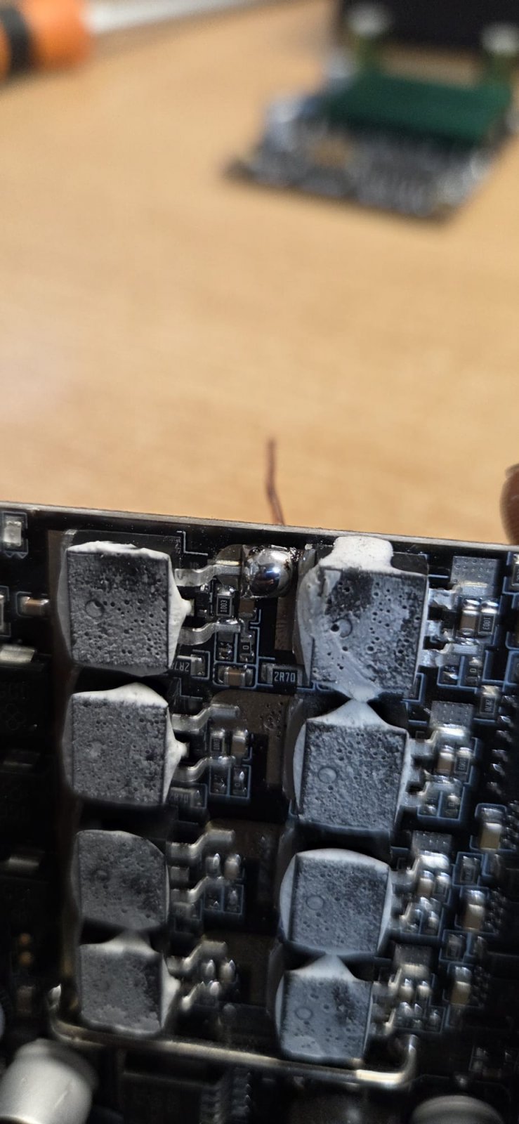

    I have two of these boards and they both have the same result no function on channel 2 channel one works fine. I’ve even tried a second Arduino i’ve also tried moving the pins from channel one which works to channel 2, and it will not work

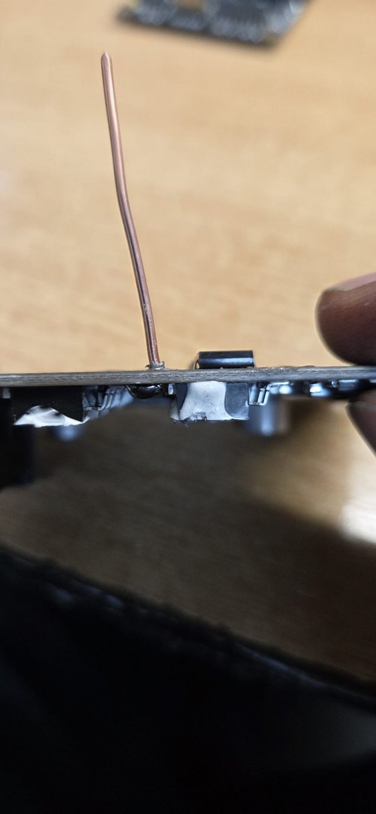

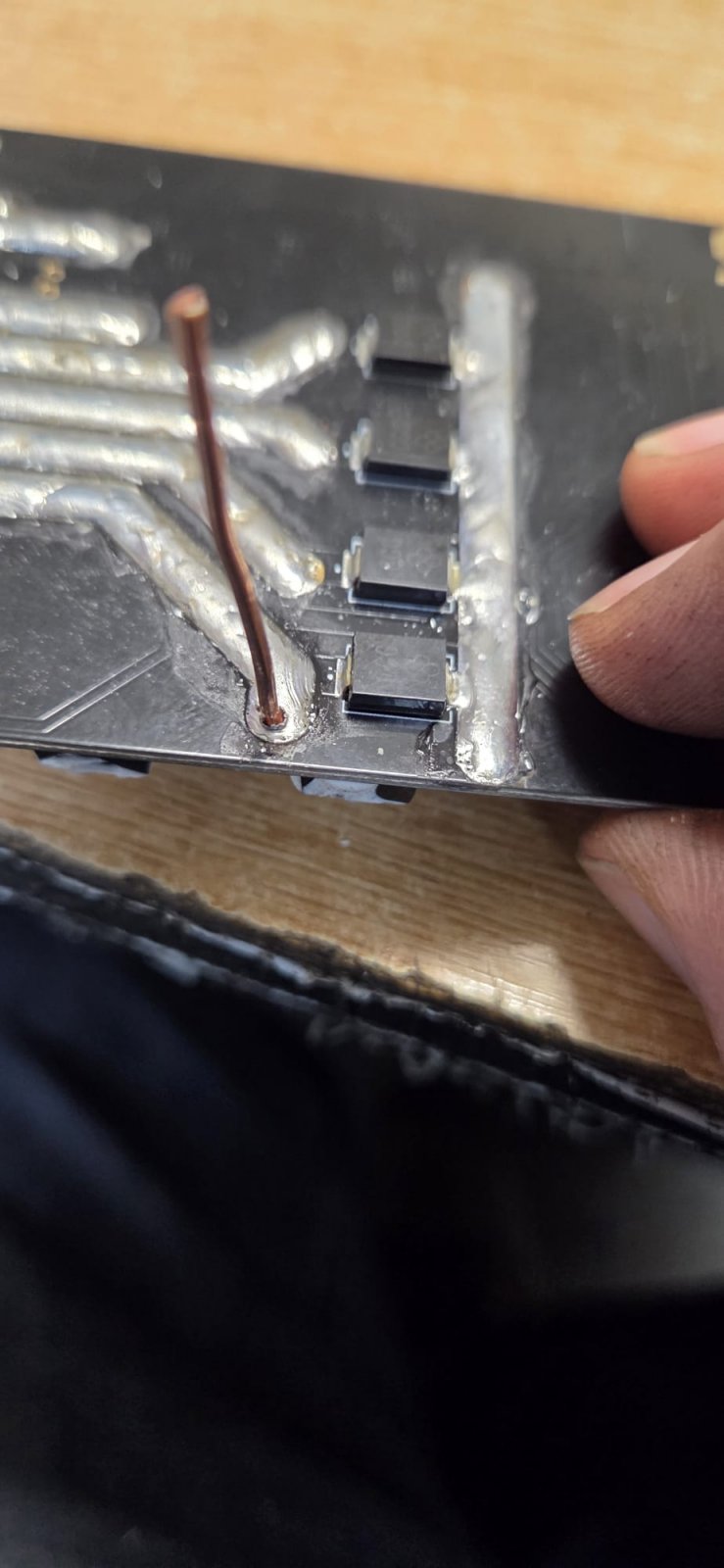

    i ordered up some new drivers for a different project and guess what channel 2 is not working !
    Sadly it appears somebody has robbed the quality control failures and is distributing them to suppliers !
    however the fix is pretty straightforward
    we drilled the through hole and fitted a copper wire / rod
    Its so sad that a great little driver board has been a target of dishonesty :(
