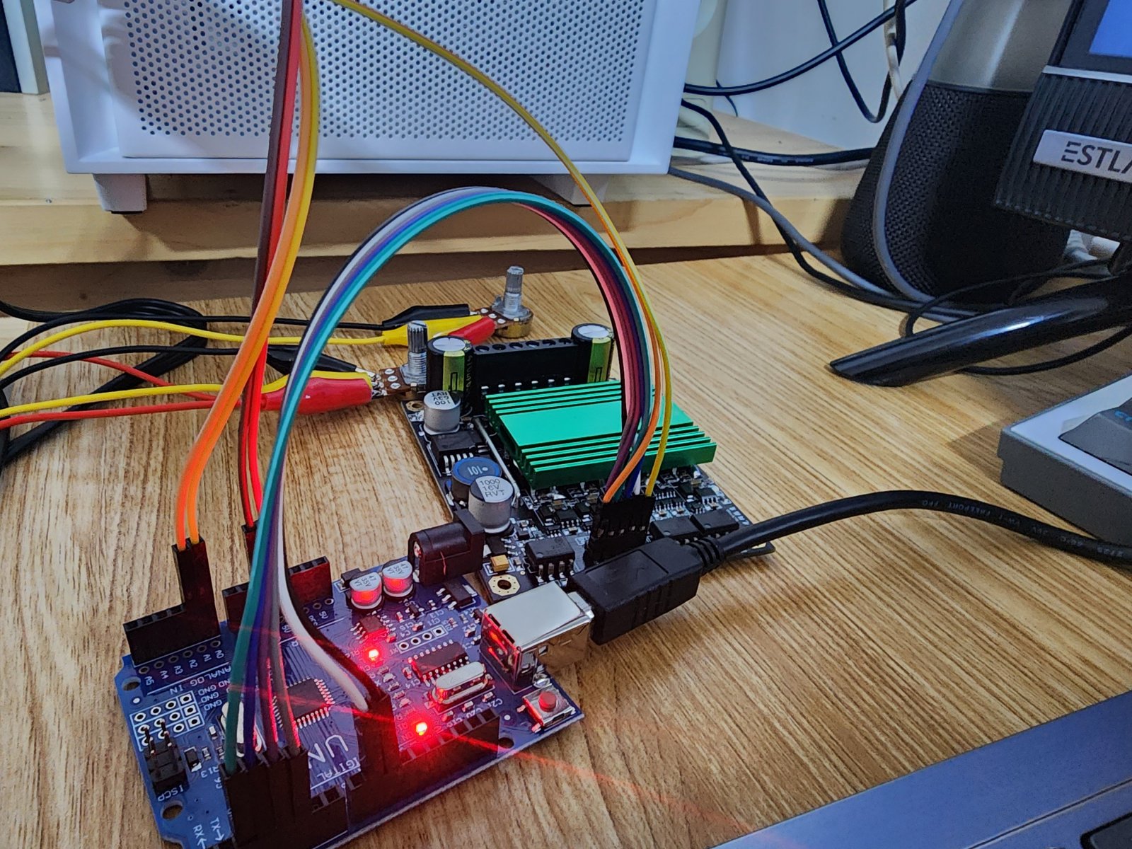

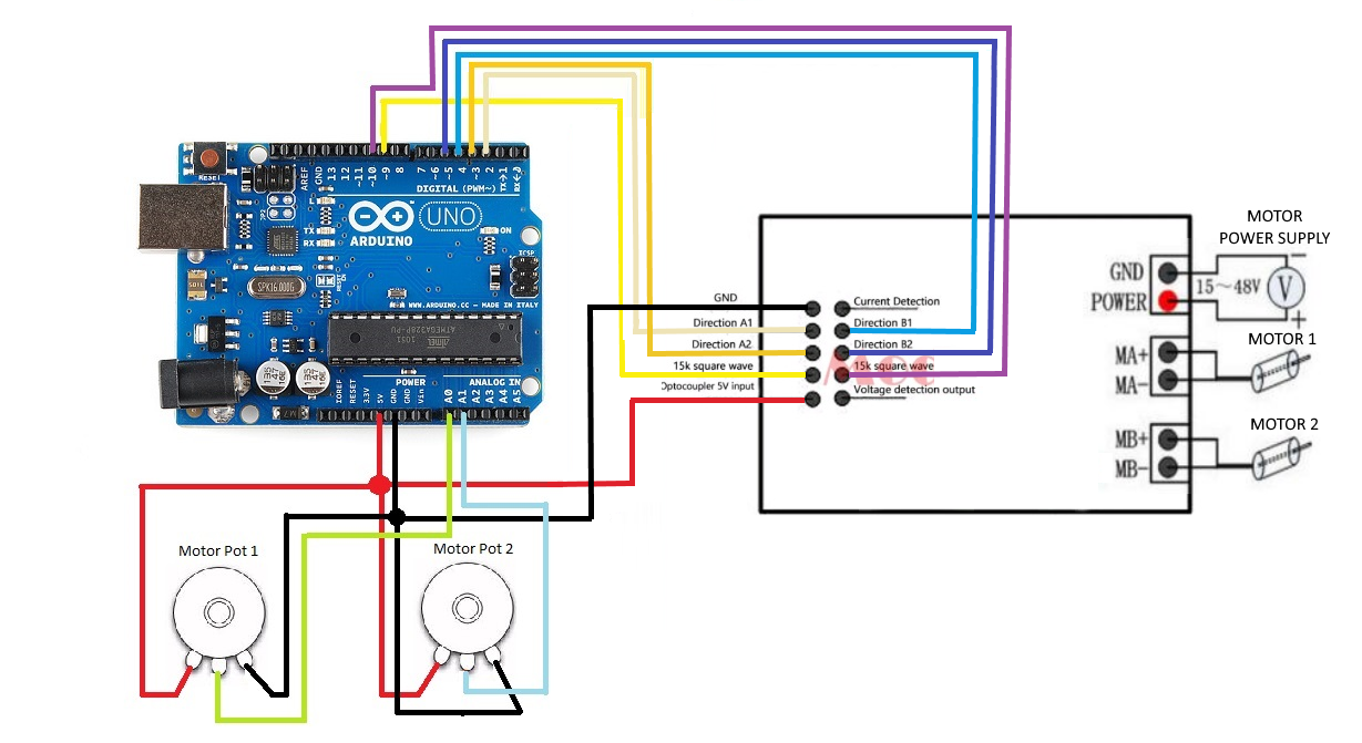

    I purchased a 100A motorcontroller. I entered all the wires correctly, but SMC3 does not recognize them. The wire drawing referred to the drawing on the first page, but what's wrong, it doesn't recognize it even if it's mode1 or mode2. What did I do wrong?

    I believe you need to power this motor driver (connect the power supply to the 'Bat' black connectors)

    I have the same and it need power on the terminal too. It will make some Color LED lit.
    And SMC won't technically see it.

    Thank you very much for your answer. If it's not technically confirmed on smc, can I check it in a different way? Is there any way?

    Thank you for your reply, I didn't even think of a power connection.

    Yes, when the motor controller is powered, there will be a blue led to indicated that. If motor 1 or 2 is supposed to turn in a direction, there will be a red or green led (depending of the direction the motor is supposed to turn) that will lit. The led will lit even without a motor connected.
