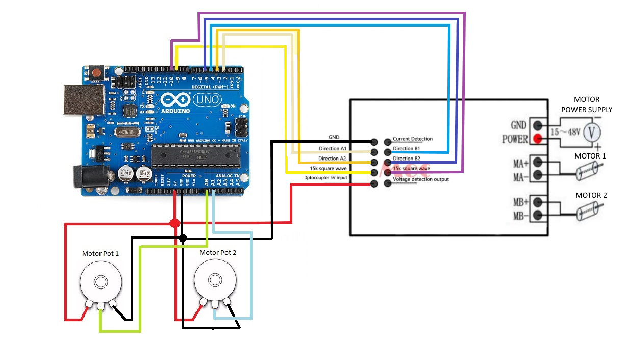

    Hi all, I have been using my motion rig without issue using IBT-2 controllers for a long time, but I have recently upgrated to a higher powered controller that I seen on this thread
    But I am having issues with it. The wiring diagram is for 2 motor controllers and I am trying to wire it up using only 1 motor. I have tried every combo of wiring i could based on this diagram but I am getting the same problem, my motor only moves in one direction when I turn on the sin wave in SMC3 utility.
    One thing to note is when I swap the positive and negative of the motor in the motor 1 part of this diagram I get the same one direction problem but its opposite.
    Another thing to note is that in the diagram it shows A1 and under that A2, but on the motor controller, its actually labeled the opposite. A1 and B1 are below A2 And B2. Which you can actually see is thje case in the product photo in the original post. Which makes me wonder if maybe the labeled A1 on my controller should be going to 3 on the arduino and labeled A2 on the controller should go to 2. I have tried both and i get the same reaction.
    For clarity,
    - I have my pot going to A0
    - Arduino 2 going to the A1 labled on the actual controller
    - Arduino 3 going to the A2 labled on the actual controller
    - Arduino 9 going to the PA labled on the actual controller
    Anyone have any suggestions?
    thanks!

    Did you update the code on your arduino ?
    The IBT-2 use MODE 2, but this board use MODE 1

    I don't use the controller so it is hard to follow your description without seeing the actual wiring.
    For example, is the Direction wiring as per the wiring diagram hooked up as depicted, Digital (PWM) 2-5?

    Oh I did not! I thought I read at the begining of this thread that the default mode worked for this controller. Awesome, I will give this a try @Wagnard thanks!

    @noorbeast It is except im only using half of the wiring becuase I am only connecting one motor. So 2-3 + 9. But I think its likly what @Wagnard mentioned

    That's probably it. BTW default mode is 1, so you probably edited it when you used your IBT-2 at beginning.

    @Wagnard mode was exactly the problem, seems great now. thanks!!

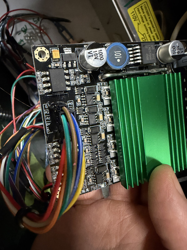

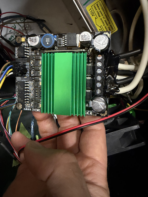

    [​IMG] I saw this thread and decided to order the 100A board from Aliexpress for my motorcycle motion sim and it finally came in. I pulled out my ibt2 boards and wired this one in and opened smc3 with same settings and it shakes like crazy right away. I’ve been messing with the settings a bunch but can’t get it to stop shaking. I did reprogram the arduino to be Mode1 cause I read that here.
    Any advice on the settings on this 100A boards vs the Ibt2
    Attached photos of my ibt2 settings that I am were working before I switched to this new board.
    22,202
    154,675Coins
    +11,209 / 57 / -2
    With new hardware redo the SMC3 setup from scratch: https://www.xsimulator.net/communit...3dof-motor-driver-and-windows-utilities.4957/

    Thanks for the reply. I see that there are 2 different variations of the driver. Does yours have the led's at the terminal block end or on the side?

    You need to refresh the arduino with the correct mode for this board. Ibt2 board is mode 2 and this one is mode 1

    This is the board I received. The wiring was labeled on this board differently than on the diagram on the first page of this thread so I did have to make some tweaks to where the wires connected.
    Also I used a fresh arduino and programmed it in mode1. Still shaking
