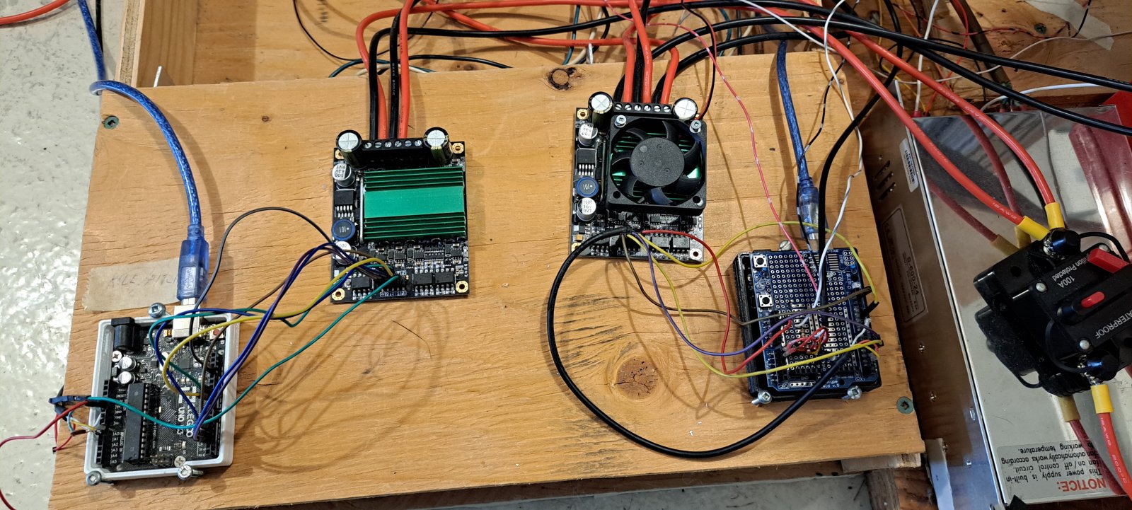

    Hard to tell, maybe something with the wires.
    Here mine.

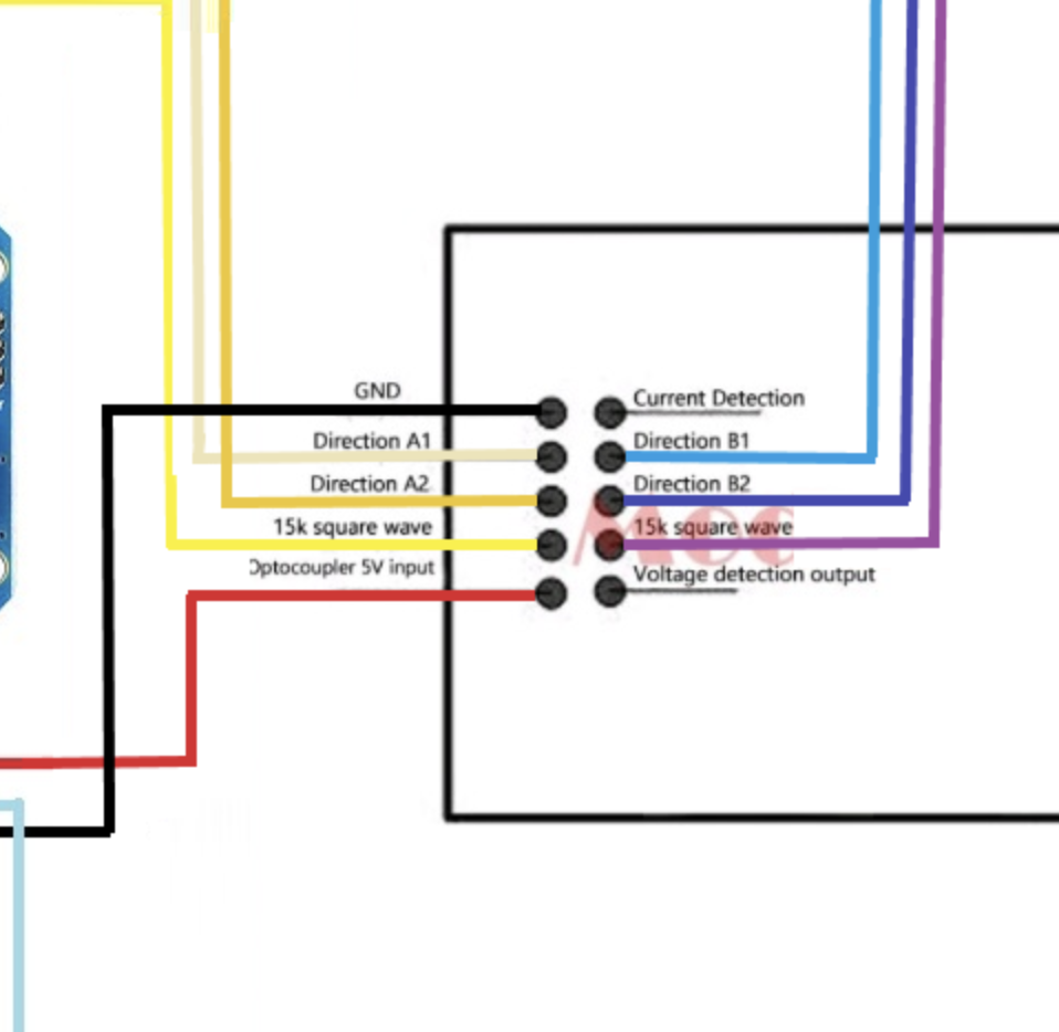

    How did you wire the 15k square wave since it’s marked different than the drawing on here on our boards.

    Not sure what is different other than the a1<->a2 and B1<->b2 inverted.
    The 15k is the same.
    15k of motor a goes to pin 9, and the 15k of B goes to pin 10 just like the example
    They are named PA and PB on mine
    Nothing on AG or PW

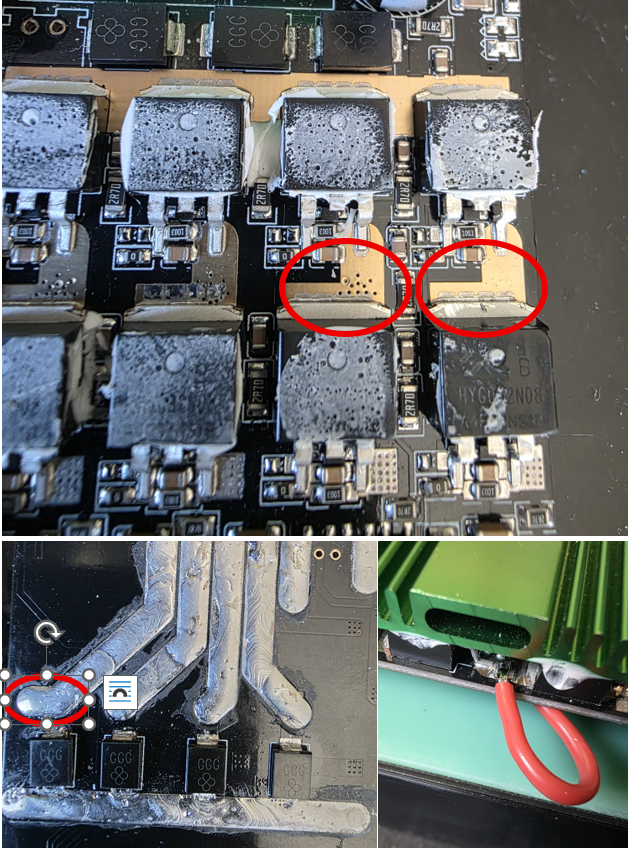

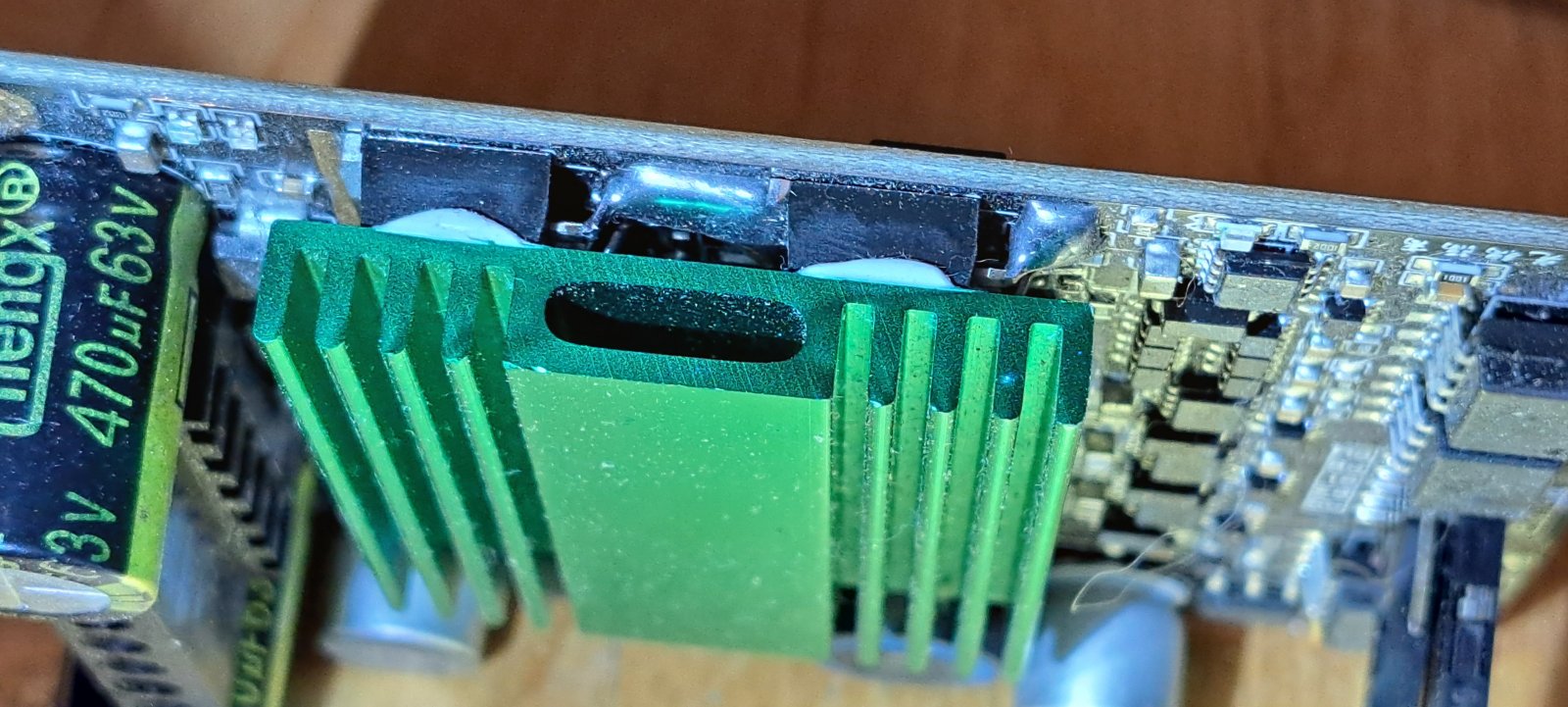

    Did some more investigating and turns out the circuit boards are faulty. There was an open circuit on the last channel. After removing the heatsink I noticed that the pin holes were absent there & that's what connects to the back side of the board. Soldered in a jumper cable & the problem is solved. All 3 boards were the same

    So I got motor on working! Wooot! Turned out I had the wires for the 15k switched!!! Now motor one is tracking and working. Moved on to motor 2 and I don’t get anything out of it. Pot is wired correctly but for some reason nothing out of the board. Triple checked the wires. Maybe my boards fault and needs the solder fixed like the gentleman above mentioned!

    I noticed you circled two areas. Which did you solder the jumper to. Trying to better understand so I can take my heat sink off. Noticed only my channel A works. b does not and I just got my board this week.

    Any pics of the wire you soldered in without the heat sync on

    The one on the right was the faulty one. I think someone is selling faulty boards that failed test. One I had just popped the voltage control chip for no reason so now have no faith in them. I think I'll change to a reputable driver for my rig

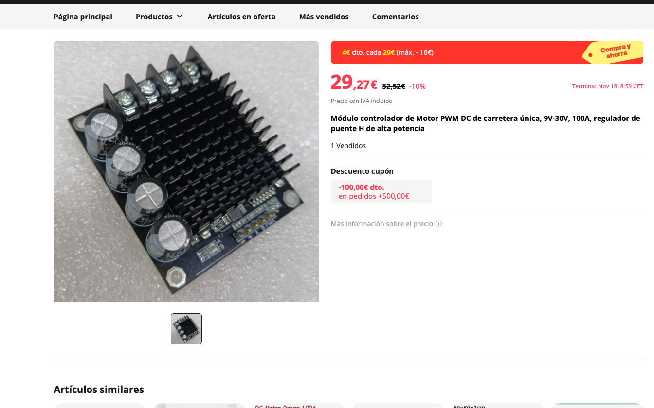

    Is there a part # for this controller? ChatGPT can't seem to find it.

    Hello, hoping somebody can help me, I have motor controllers that are very similar to the one posted at the beginning of this post, I got them off Amazon. They have a blackboard, and the LED indicators are in a different spot if it maters.I have it wired same as the diagram, but for the life of me, I cannot get the second motor to work,with the second motor hooked up both pots control motor 1 but no life for motor 2. If I hook up two of these controllers, it works fine. Is it possible that some of these are only one motor even if they have the pins for two?

    It would likely help if you link the actual product page and specs.
