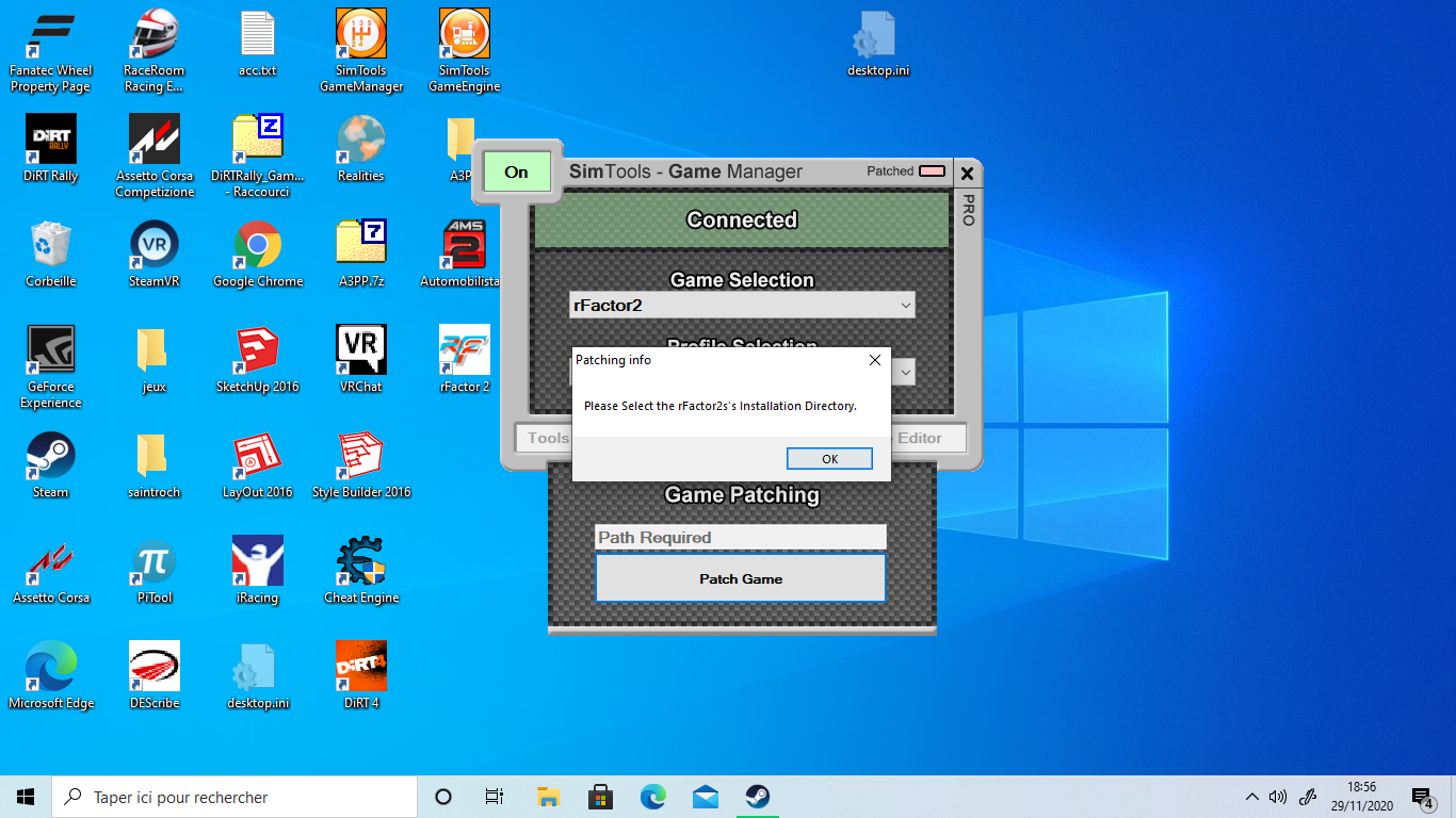

  11. Viktor_s
    Viktor_s New Member
    Jul 12, 2017
    21
    Russian Federation
    - 32Coins
    +15 / 0 / -0

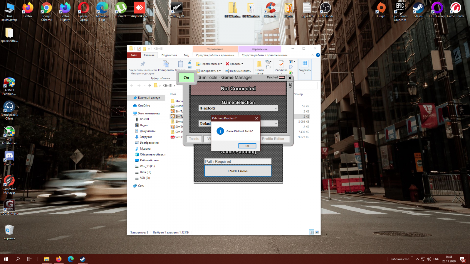

    Hi everyone! I've tried to patch the game but "Game did not patch?". I run the Game Manager as administrator, but it didn't effect.
  12. noorbeast
    22,206
    154,699Coins
    +11,210 / 57 / -2
    You should not need to run GM as admin.
    Did you get a specific message and if so can you post a picture of, along with the patch path.

    Path is ... D:\Games\Steam\SteamApps\common\rFactor 2

    Result is the same((

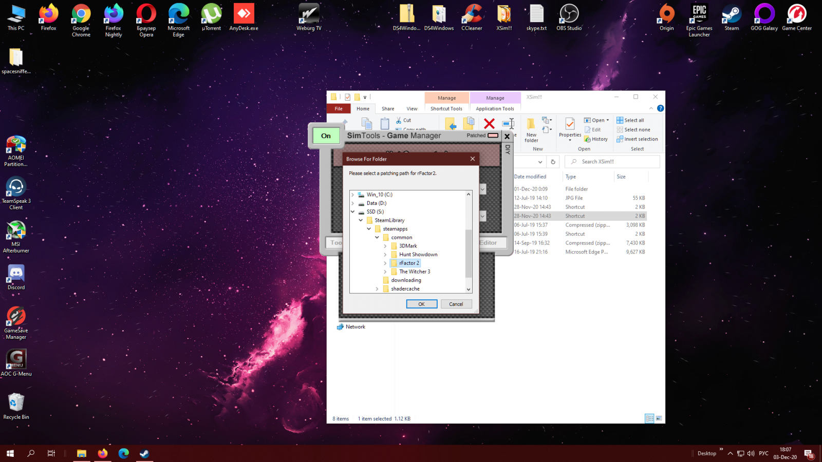

  16. boobabebe
    boobabebe New Member Gold Contributor
    Oct 13, 2018
    7
    46Coins

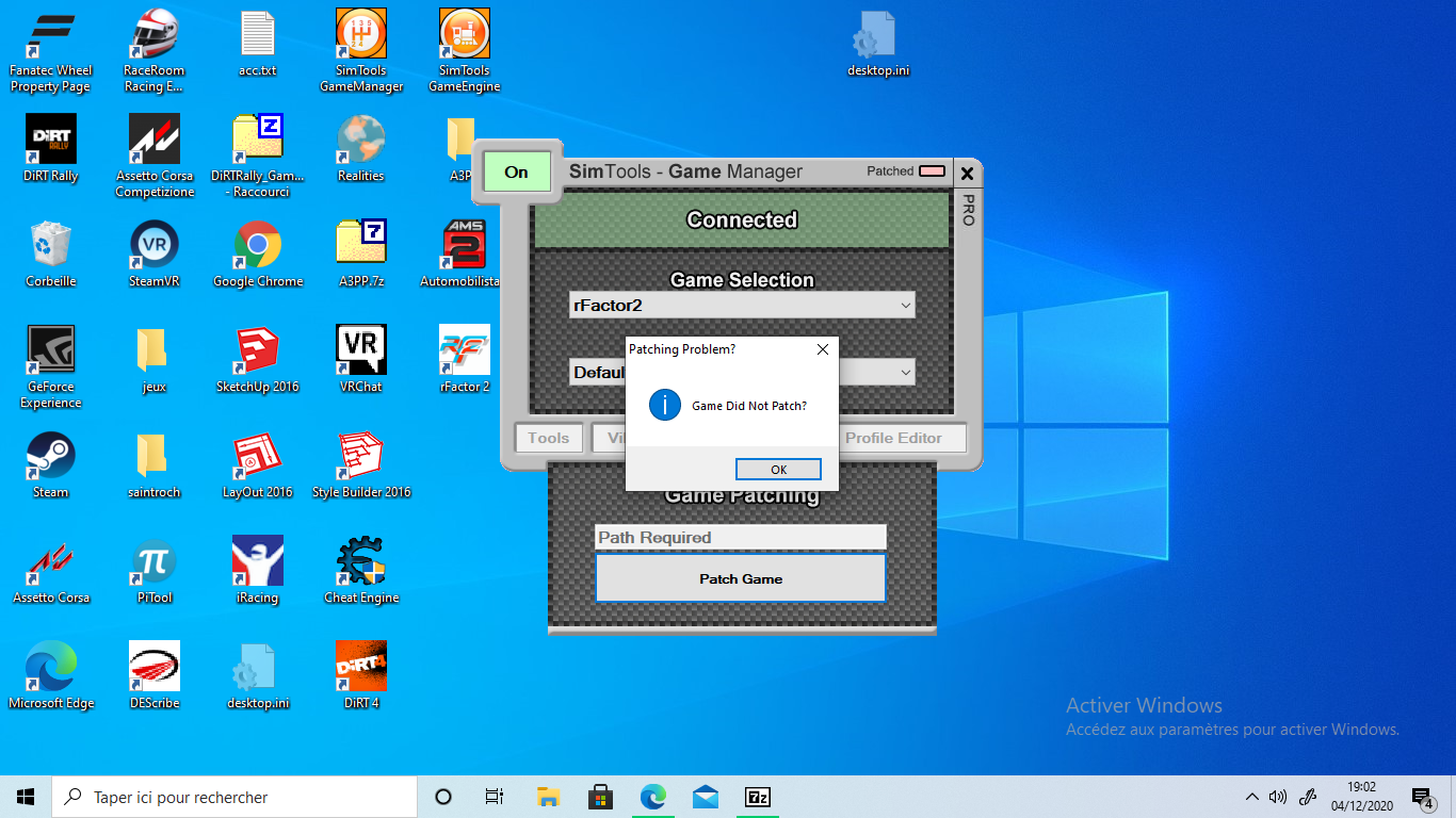

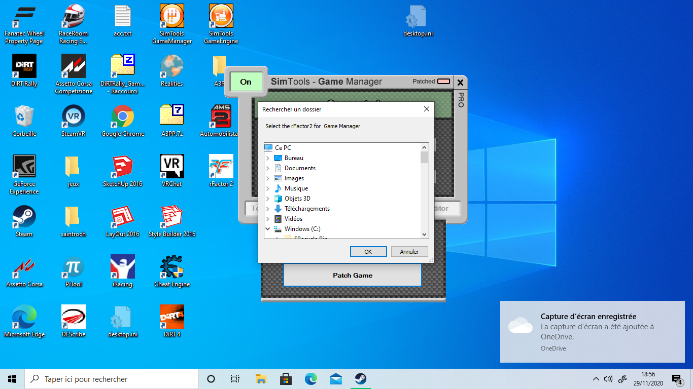

    Good morning all,
    I have a problem patching rfactor 2, it asks me to select a folder, but its not done on my other games. So I'm not used to it.
    See the captures below.
    Thank you for your comeback.
  17. noorbeast
    22,206
    154,699Coins
    +11,210 / 57 / -2
    For some games SimTools needs to know where a game is installed.
    Are you using Steam? If so the default install directory for game installs should be C:\Program Files (x86)\Steam\steamapps\common\ In SimTools find the RF2 folder in there.
    If you are not using Steam the file path is wherever RF2 is installed.

    I've reinstalled the game to my SSD. As well the game has been installed to my laptop.
    The game doesn't patch.
    Maybe someone can test the actual game to patch?

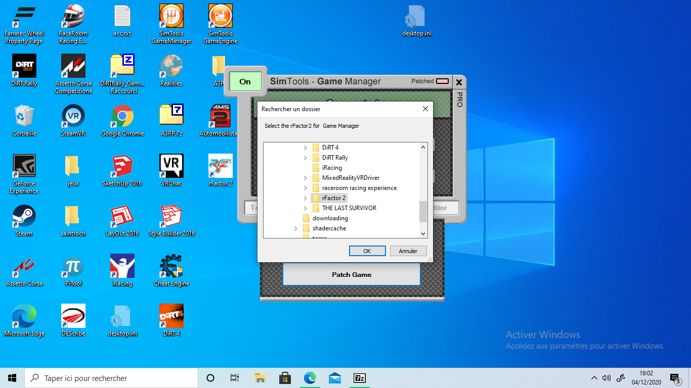

  19. boobabebe
    Oct 13, 2018
    7
    46Coins
    I am trying your solution and the game does not want to patch. see the pictures
    Also in my rfactor 2 game folder, I don't see a simtools folder.
    Thank you for your help
