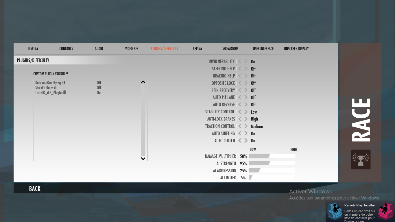

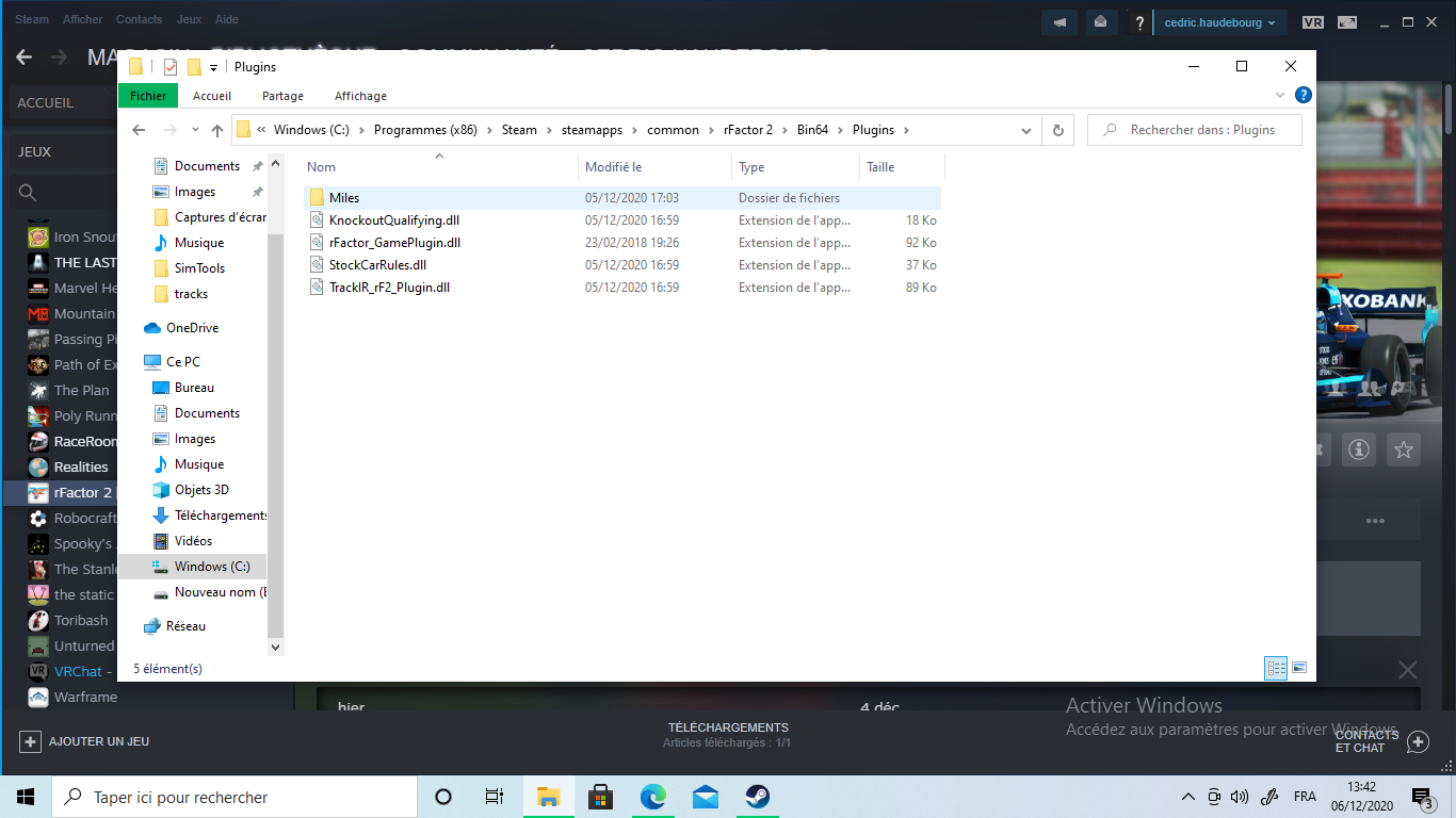

  5. boobabebe
    boobabebe New Member Gold Contributor
    Oct 13, 2018
    7
    46Coins
    Hello When I am in my rfacror2 folder, I can see the Gamepluging.dll and in the game in the options I do not see it appearing, I have the others except this one. See photos
  6. Magus
    Magus New Member
    May 19, 2020
    17
    87Coins
    +12 / 0 / -0
    I don't know if this may be the cause of your issue but you have installed Steam on a 32-bit file structure - Programme Files (x86).
    In all honesty I am only in the process of building my motion simulator and I plan on rF2 being the 1st game I try with it, so am following you developments closely in case I have similar issues.
    You can try to copy and paste that plugin into the 32-bit folder in rf2 and see if it shows in game (?) If it does, then I would reinstall Steam (& all its contents) on the 64-bit file structure, i.e. in Program Files

  8. Magus
    Magus New Member
    May 19, 2020
    17
    87Coins
    +12 / 0 / -0
    I found a solution, might just be because I am a bit dim witted and everyone else knew BUT just incase it is of any use to anyone what you need to do is go to your rf2 install folder and within the BIN32 folder create a Plugins folder. This was removed after the latest rF2 update which stopped supporting 32-Bit version of teh game. The patch will then install in that folder, I then copied and pasted it over to the BIN64 Pluginsfolder. Not sure if that was needed but I did so. Motion is working but needs tuning, however need to sort out my Accuforce settings first as I can't seem to drive in a straight line to be able to do a min/max Tuning session.

  10. Magus
    Magus New Member
    May 19, 2020
    17
    87Coins
    +12 / 0 / -0
    I got it to work. Just go into your BIN32 folder and create a new folder called Plugins. SO the path is :
    X:\SteamLibrary\steamapps\common\rFactor 2\Bin32\Plugins
    After you create this folder it should patch. BUT ignore my comment about copying and pasting the plugin from the 32 to the 64. THAT is a MISTAKE, I didn't realise that both versions were installed.
    Basically, the Plugins folder in the BIN32 is missing, that is why the patcher is not working.
