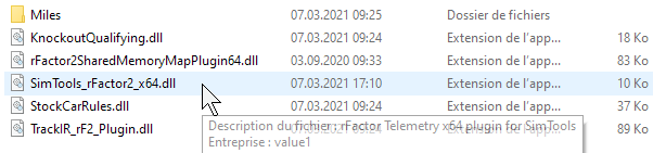

    I had the same problem but after creating the plugins folder in the bin32 folder I could patch and the simtools file was in bin64/plugins

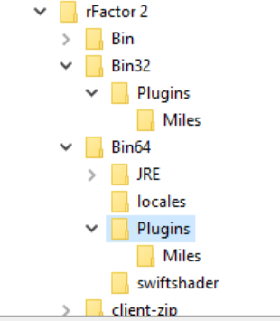

    In folder bin32/plugins upload_2021-3-12_16-3-20.png
    In folder bin64/plugins

    yeh thats there when i go through my file explorer but when i use the patch facility in simtools game manager it just isnt visible

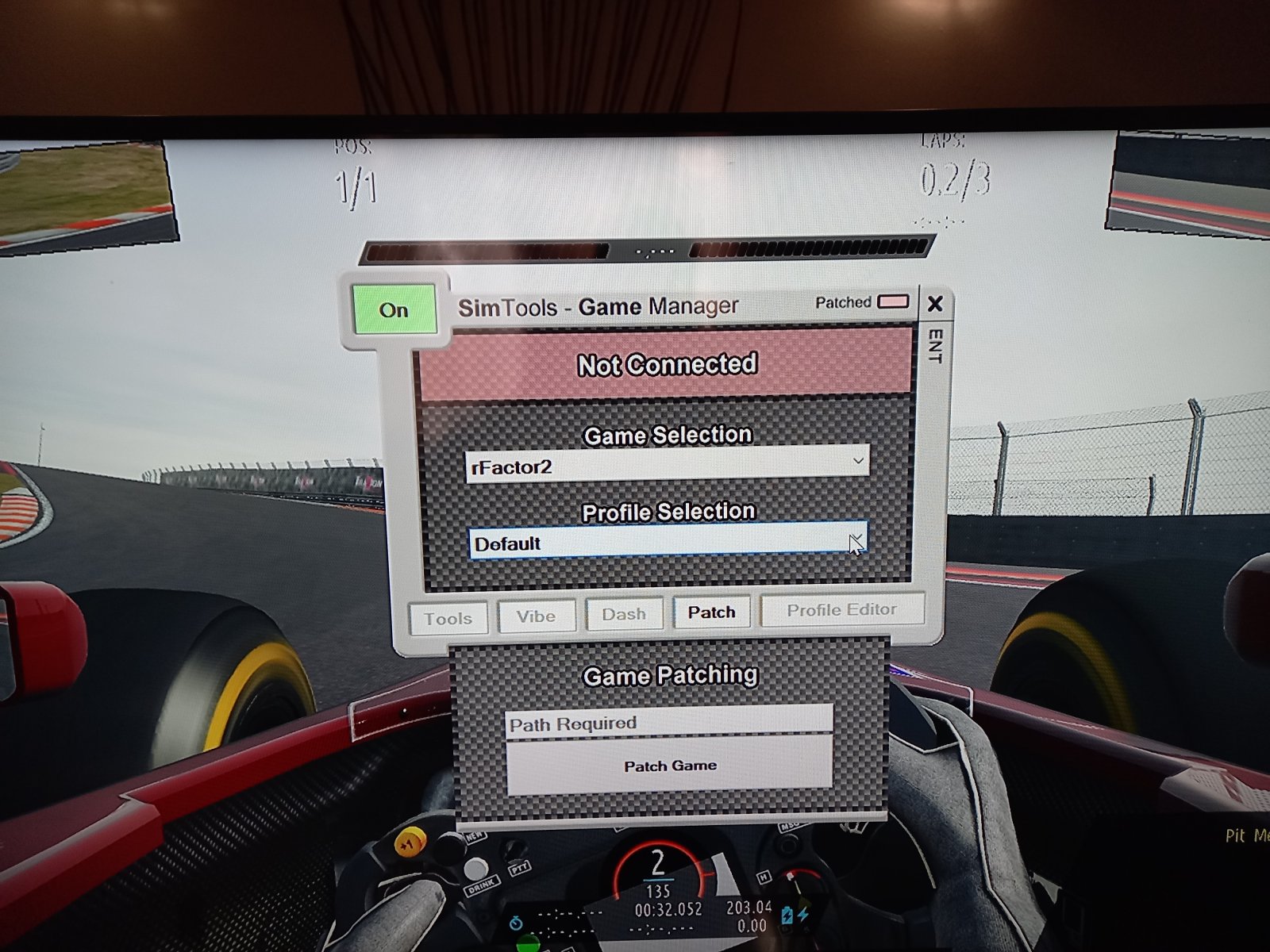

    Hi @value1 please help me with understanding the patch... in game manager where the icon on top of the window says patched and it's still red in the box ... does that mean there no patch.... excuse my inadequate knowledge...any advice will be appreciated to get my my simtool software setup right to start my adruino setup...very new lol

    Can you please post pictures of all of your settings, including the Tuning Center while the game is running.

    Morning Noorbeast well atleast morning where I am ... thank you for your reply ... I'm very new at this so be patient with me ..
    I'm a machinst by trade fairly new to software and electronics.. pls see this picture I'm setup at home getting all the software setup with Rf2 .. but I can't seem to patch the game maybe I've done it wrong or missed a few steps ..
