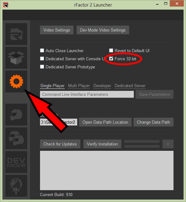

    maybe you can help me again Value1, IN the video option's under resolution its listed it in .32 bit Not 64.......any tips....I dont understand how to FORCE the game to run in .64 i see the blip you have about refering to the forum for details but they dont give much, just says "Experimental 64 Bit builds added. Manual rename of 64 bit executables to 32 bit names required so the launcher can successfully start 64 bit "

    rFactor (since build 798) runs automatically x64 mode if possible unless you force it in the Launcher (Launch rFactor.exe)

    thats kinda what i figured when i seen that option in the launcher, but why does it say 32 bit in the Video options. ? thats what got me curious.

    Isn't that the colour depth? So there is nothing more than 32 bit?

    Nope Only show's 32 bit, YES im on a 64 machine. ;)

    Fine, but even on a 64 bit machine your colour depth is 32 bit max.
