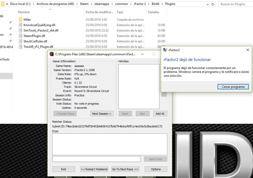

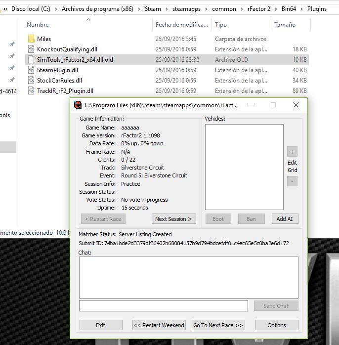

    I need help, I have the Steam version of rFactor2 and the rFactor2_Dedicated.exe crash me if I have the plugin SimTools_rFactor2_x64.dll or SimTools_rFactor2.dll in ... / SteamLibrary / common / rFactor2 / bin64 (or bin32) / Plugins ...
    I just patch the latest version v3.0.6.1 rFactor2_plunig but also with earlier versions crash dedicated server.
    If I delete SimTools_rFactor2_x64.dll or SimTools_rFactor2.dll in ... / SteamLibrary / common / rFactor2 / bin64 (or bin32) / Plugins ... dedicated server works well.
    Is there a solution?

    Works without plugin:

    Nobody has this problem ?.
  19. Chumet1
    Chumet1 Member
    May 10, 2014
    59
    - 2Coins
    +16 / 1 / -0
    2DOF, JRK
    Someone I can confirm that the rFactor2 dedicated server works properly with the patch simtools?
