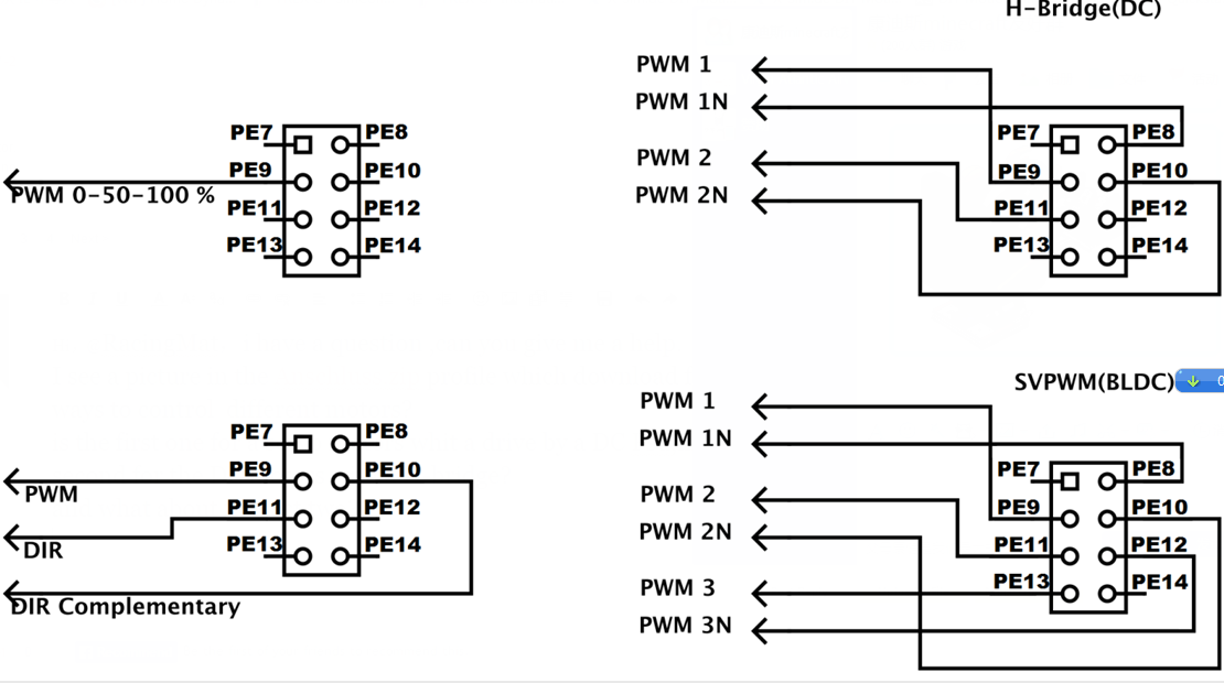

  10. welen123
    Jan 10, 2015
    98
    HongKong
    35Coins
    +57 / 0 / -0
    Hi,@RacingMat,i have a question ,can you give me a help.
    I see a picture in the Anschluss.zip profile which download form virtualracing.org . is this the 4 ways to control different motors?
    is the first one for a servo motors whit a drive by a DC Psu,like the VSD-E?
    second for the DC motors with a H-bridge?
    and what about the last two?
    Can the third one used for a stepmotor?
  11. RacingMat
    2,234
    21,094Coins
    I don't think it's usable for stepper motors
    the third is for DC motors with HBridge with two pins for direction
    the fourth SV PWM is for AC motors
    http://www.academia.edu/6495069/Space_Vector_Pulse_Width_Modulation_SVPWM_
  12. welen123
    Jan 10, 2015
    98
    HongKong
    35Coins
    +57 / 0 / -0
    Thank you very much! I want to find another drive to instead the VSD for the 130ST-M10010 servo, because the VSD is not convenient to buy.
