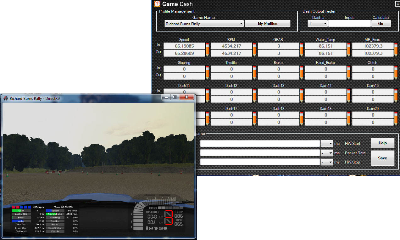

    thanks for your work on the Plugin and also adding the new features like Handbrake and Boost etc.
    I just tried it with my dashboard.
    But its the needle isn't going very smooth. Worked better with Soraz exe.
    I don't know if this has something todo with the plugin or my code. But i think its my bad code. :)

    I don't know what was the problem. But the behavior of both outputs was very different on my motors. I left arduino Code and gamdash alculation untouched. Now i modified it and it works a lot better wih Pirlads Plugin.

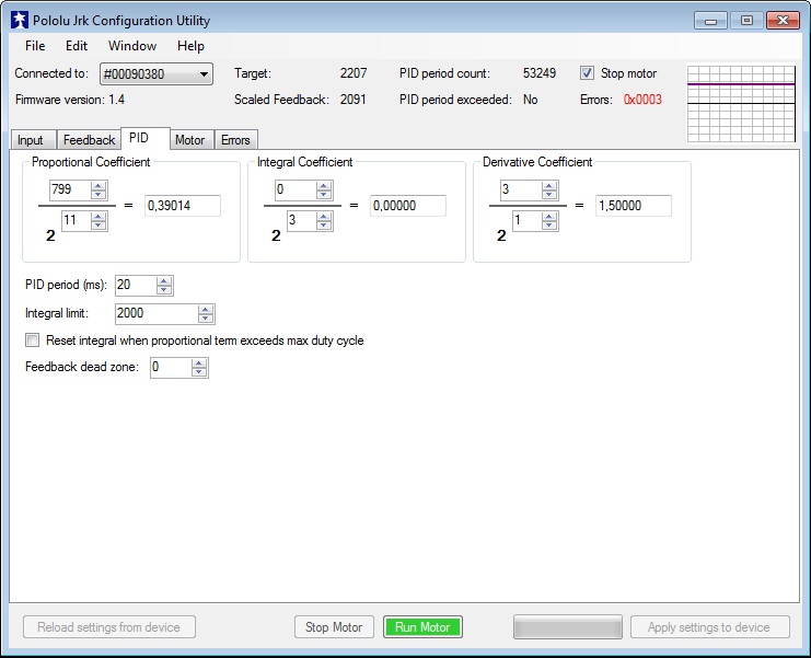

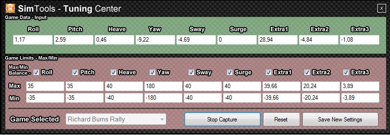

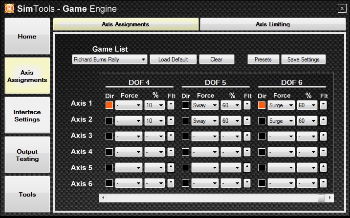

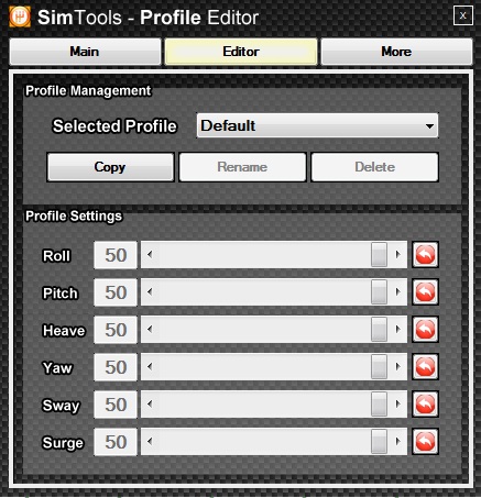

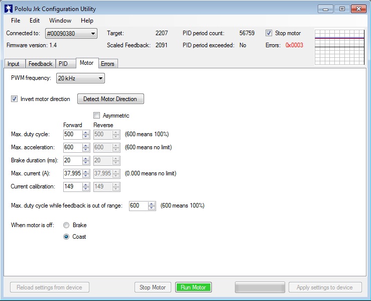

    TC.jpg GE.jpg GMPE.jpg JRKCUMOTOR.jpg JRKCUPID.jpg Thanks for this great plugin!
    I have a problem though: I don´t get any game data input on the surge axis and no surge motion? All other axis´work perfectly.
    Here som screenshots to show values captured in tuning center and my settings in game engine and game manager profile editor. Main level is at 100%.
    As you can see all other axis´give input but surge is at 0.
    I´ll also show my motor and PID settings in the JRK configuration utility although I don´t think that´s the culprit here.
    My hardware i JRK´s, ZYT-90 motors and bourns 360 deg pots in a seatmover setup. I´ve prepared everything for traction loss but chose to get the seatmover up and running before proceeding to that.
    Thanks in advance! :)

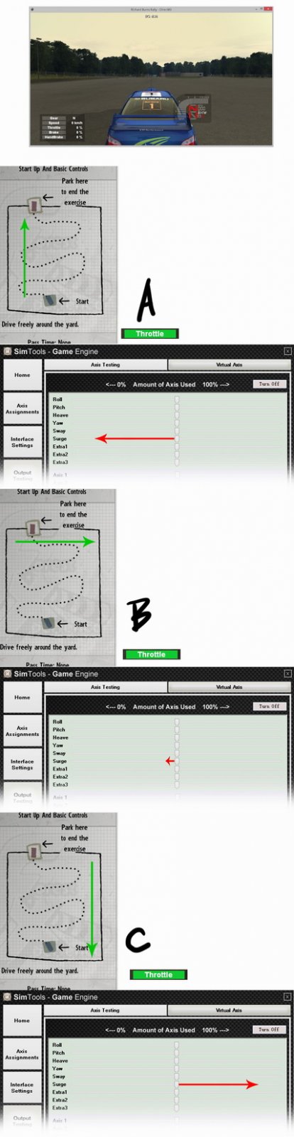

    i thing i found bug in yours plugin, its in surge movement, when i accelerate simulator is going up, and in braking down, thats ok. But when a car rotate a 180 degreses on map it working conversely, when i accelerate car simulator going down and when braking it goes up. Seems like a compass is confusing this value. Or is it my mistake and plugin is OK ? thanks for your help :)
    Sorry for my english, Iam a Czech.
  18. noorbeast
    22,184
    154,726Coins
    +11,194 / 57 / -2
    Is that on a particular map or all maps?
  19. stepus
    stepus New Member
    Jul 8, 2015
    14
    Czech Republic
    158Coins
    i am using same settings for WRC and GTR game and axes working perfect, but on RBR is a bug in plugin i thing. Yes, i had tested, driving school ( something like parking lot ) and some races in FR. So i thing others maps cannot affect this bug.

    prilad Hello! Thank you very much work!
    After my test, I found some abnormal surge, the surge of direction is not a car coordinate their movement, but the movement to coordinate world system?
    I do not know if only I had this problem.
    The following is a case of the test: The green arrow is the direction of car travel, the direction of the red arrow is the surge, the length of the red arrow is the intensity of the surge.
    A few days later I again run rbr test results returned to normal. Really pleasing.
    Now changed and does not change the regional language is set to test, are not following errors.
    I think the problem might be due to an error the operating system, you need to turn off the power, restart the system down.
