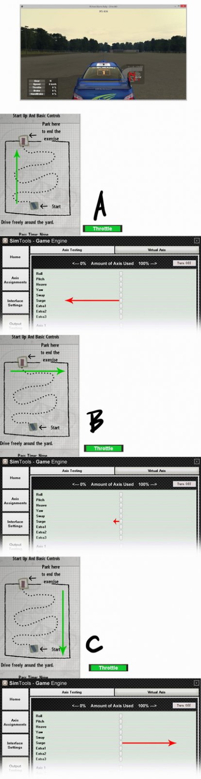

    Hi. These days i'm having this type of problems with RSRBR 2015. The movements of surge effect are inverted. On brake the seat move backward ad on throttle the seat moves forward. I've just tried to invert the axis and repatch on Simtools but without results. Any help?
  15. noorbeast
    22,211
    154,729Coins
    +11,213 / 57 / -2
    Please post details to your own build thread here and post pictures of all your settings, it is not a plugin issue.

    @noorbeast i've the same problems of @fzxj520. In some position of track the surge works fine but not in other direction/position. I'm playing very well with other simulator as Assetto Corsa, rfactor, dirt rally... anyway the problem is only with surge effect.

    Thanks for the plugin, but definitely it has a problem with the surge direction. Sometimes it work right way, and sometimes inverse way. I thought I had set wrong surge direction but it is not. It changes its direction on its own. Hope to be corrected soon
    and
    Can anyone confirm it is working with RSRBR2016??
    it works when I run the game with Richardbunrsrally_sse.exe, but not working with rscentermenu.exe..
