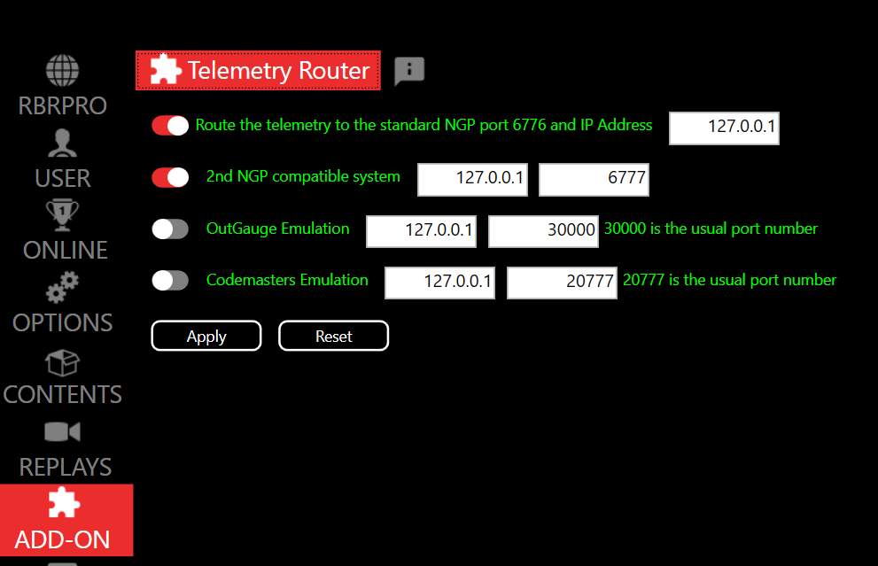

  8. arcelivez2
    arcelivez2 Arthur
    Feb 12, 2020
    7
    145Coins
    3DOF, SCN6
    Hello, does this plugin work with RBR Pro? I've set it up, SimVibe/SimCommander works fine, but I can't get SimTools to work.
    It shows as patched and it doesn't complain when removing the patch or repatching it again - shows all successful. It also indicates "Game Running" when RBR Pro is running.
    Somehow there's zero telemetry output in the tuning center and no motion... I don't understand it. It used to work fine without RBR Pro as much as I remember...
    Can you at least tell what plugin files have to be put where in the RBR folder exactly and with what name? Maybe then I would be able to correct the patch manually just like I had to correct for RF2 once...

    What routing numbers are you using? Yes it works in pro with simtools.

    I have enabled the telemetry router in the contents and I have the following options active there:
    I have no idea what the ports are supposed to be - these are the default ones by RBRPro

    Try to change port 6777 to 4123 or manually in Richardbirnsrally. Ini and try launch from RichardbirnsrallySSE. Exe

    You must run the sim tools as administrator for it to work for you in RBR PRO ...

    Thank you very much guys. As for the ports I am not so sure what helped. I added 4123 instead of 6777 in the RPR Pro Telemetry Router 2nd NGP compatible system section and applied. In the .ini file I only see:
    udpTelemetryAddress=127.0.0.1
    udpTelemetryPort=6775
    and no matter what I set in the telemetry router or if I modify this file manually, it always reverts to 6775 in the ini file.
    Any way at some point it started working after everything, but with very low output (my calibration was from 2 years ago for normal RBR, not Pro), I recalibrated and it was working well. But the next time motion didn't work again...
    So Ocatvio's reply helped on the last part at least, after starting SimTools Game Manager as an administrator it now seemed to consistently work.
    I'll keep testing if all stays like that, but thank you very much everybody for your support and I do hope that this summary will somewhat help anybody encountering issues with RBR Pro similar to mine.
