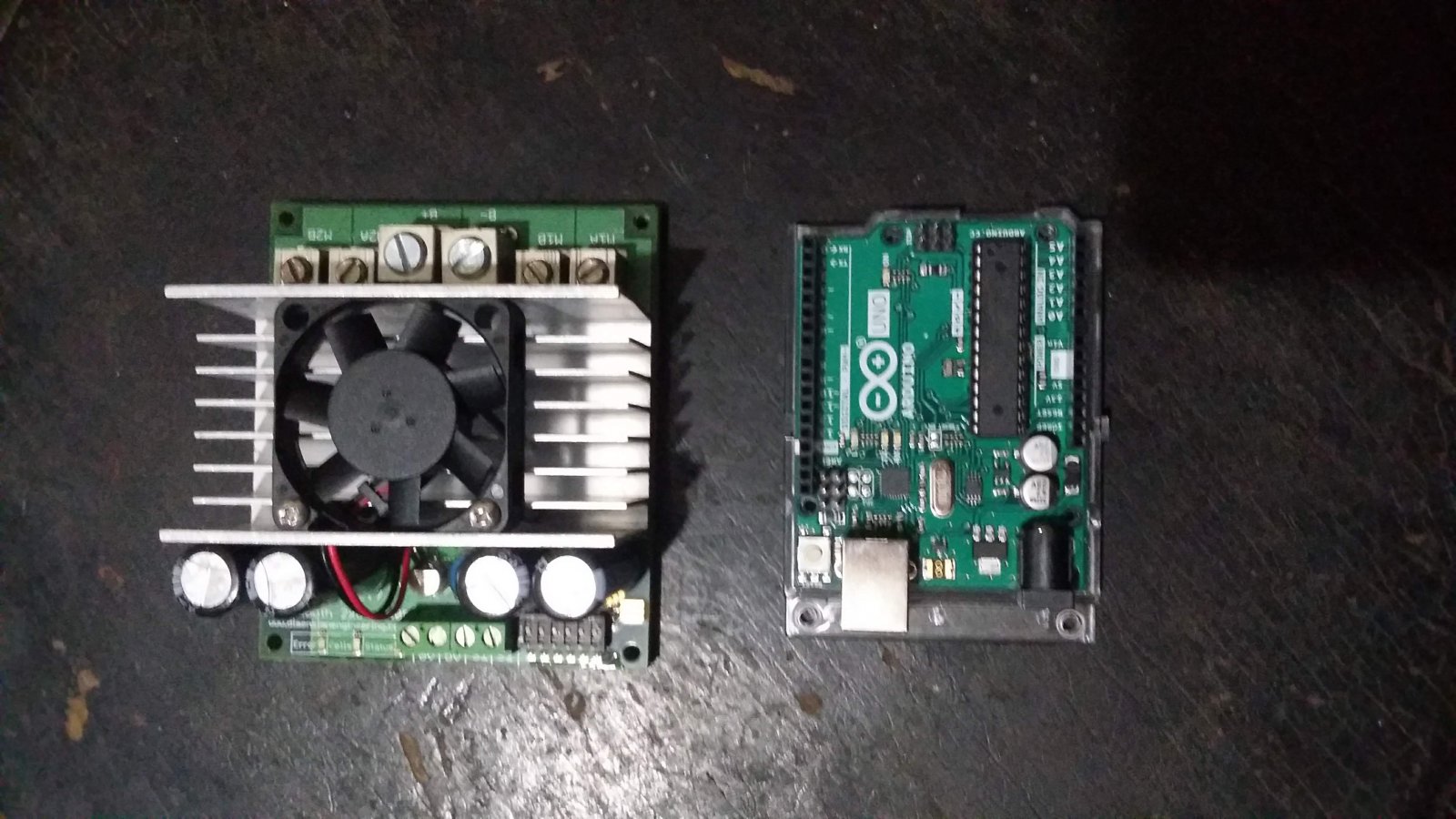

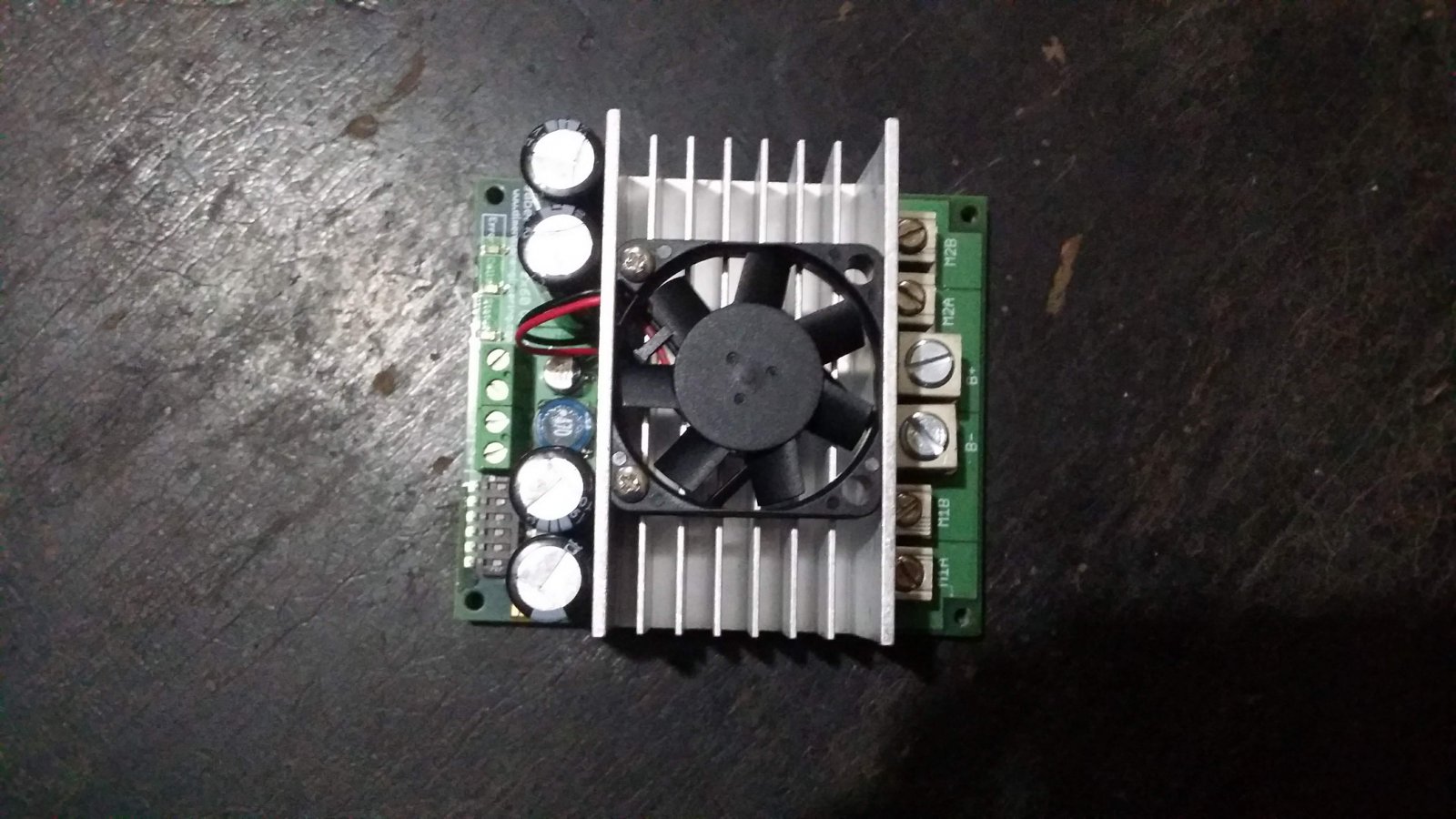

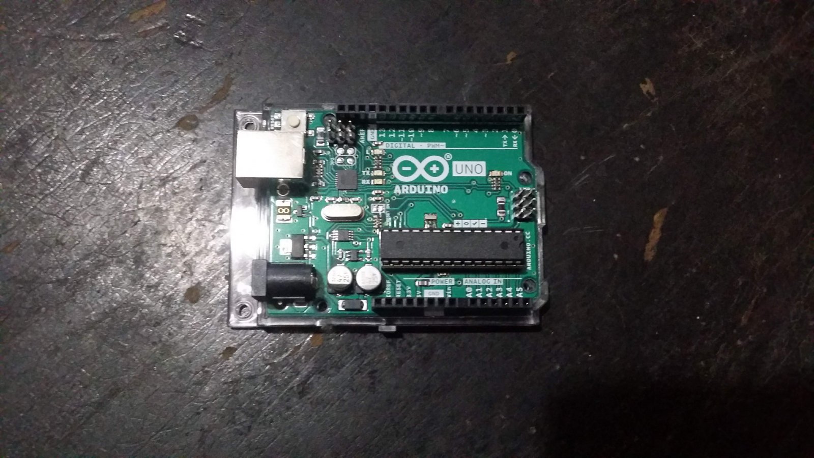

    Okay guys sabertooth 2x60 and genuine adruino have arrived. The quality of both are much better.

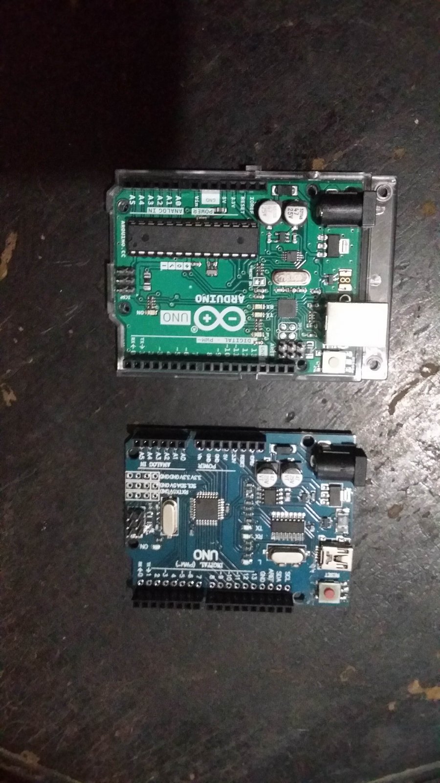

    Just if anyone is curious. Heres a pic of the genuine adruino beside a clone. Genuine is on the top.

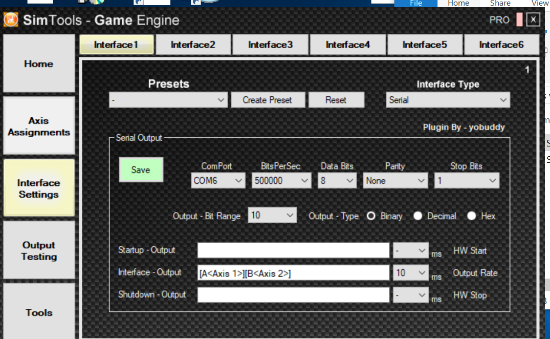

    I need help. I uploaded the smc3 code for the sabertooth and used the smc3 utiliy and everything works great, but when I go to Simtools game engine and try and test output, nothing happens. What am I missing? Here are screenshots of my settings.

    With SimTools 2 setup in the Interface Settings instead of axis defined like this <Axis1> it now has designate grouping for a or b in SimTools 2 for each axis assignment, like this [A<Axis1a>][B<Axis2a>]

    Thanks, its working now, but the power supplies keep shutting off after awhile. Gonna try and change some settings and see if I can figure it out.

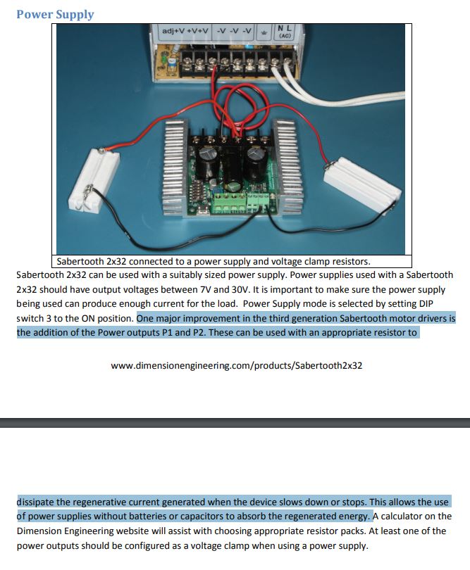

    Ok, so I used the calculator and it has given me the following recommendations:
    1: 0.8 Ohms dissipates 180 Watts at 15 Amps
    2: 1 Ohms dissipates 144 Watts at 12 Amps
    Does this sound correct for the pgsaw motors, because the problem I am having now is that locally the biggest resistors are 25 watt, so I would have to by a bunch of them and series them. Where do you guys get resistors?

    I am getting some resistors, but how do I wire to the 2x60 because the pic shown is the 2x32 and where the wires go from the resistor isn't on the 2x60.

    Please help, I don't know how to wire the resistors to the 2x60

    I didn't realise you were using 2x60, I had presumed a 32, you will need to use a battery to dissipate the regenerative current, as the 60 does not have the same features as the 32.

    Be mindful the 2x60 has no regenerative current control, as far as I am aware you need a battery so it has somewhere to go.
