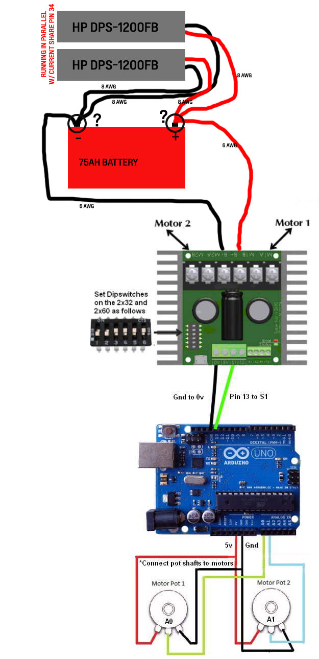

    Hey, what's the issue if you don't have a battery connected. I have been running my sim without it for about 3 years now with no issues that I can tell.
    21,695
    151,815Coins
    +11,058 / 56 / -2
    As per my quote, the Sabertooth 32s are designed to handle regenerative current, "the auxiliary power outputs can be configured to allow the Sabertooth 2x32 to operate from a power supply without a parallel battery": https://www.dimensionengineering.com/products/sabertooth2x32
    The 60s are designed differently, "the regenerative topology means that your batteries get recharged whenever you command your robot to slow down or reverse.": https://www.dimensionengineering.com/products/sabertooth2x60

    Thanks for your reply, I read and understood all of that, what i'm trying to determine is if there is a draw back to not having any batteries in the system, because I don't and haven't had any issues so far, but would prefer to avoid a issue in the future if it could cause one.
    21,695
    151,815Coins
    +11,058 / 56 / -2
    Are you using Sabertooth 32? If so no battery is required.
