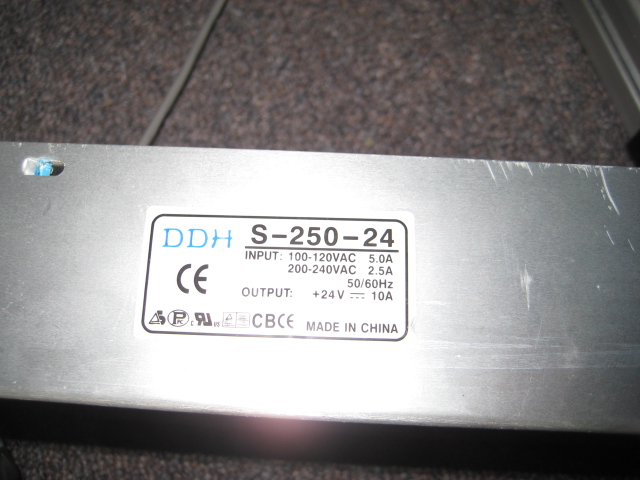

    Hi so I made it home. I verified my setup and saw that 2 thick wires were leaving my scn5 to go to a adapter that was converting them to the usb to go to my tower. The power box has 1 plug that goes to the wall for power and several thin ones mixing up with the wire that is converting to the usb. So I just have 2 usb plugs to connect to my tower and one power plug that goes to the wall. I also have a on/off switch which I never used as this was to freeze the seat so that the actuators do not move around.

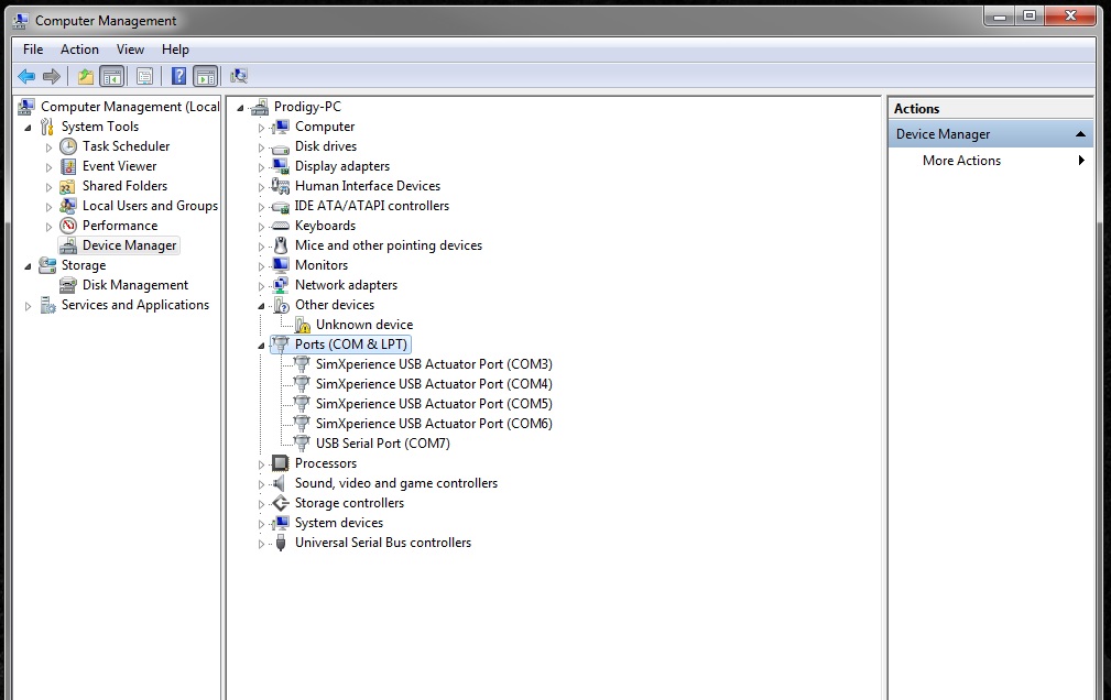

    When you connect all your stuff and plug it in your PC, what does it do? Does it install the drivers?
    In fact, what do you see in your Device Manager under Ports?
    Do you see any SimXperience COM ports like here:

    when I plug in my 2 usb's I see under device manager com3 and com4 (no mention like yours the word actuators next to them just com3 and com4)but no drivers or anything are installed. Is this normal? Am I forgetting a step?
    Also, don't I have to do something with my actuator serial numbers?

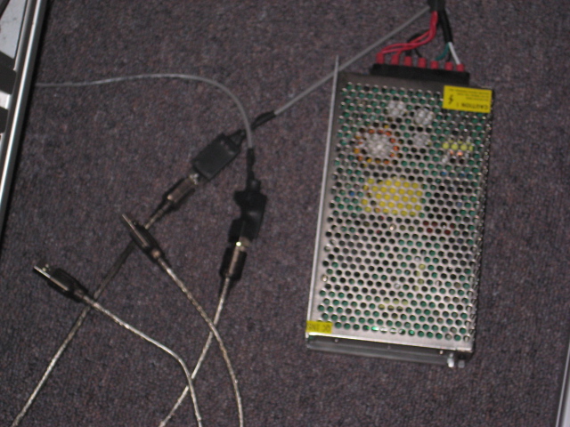

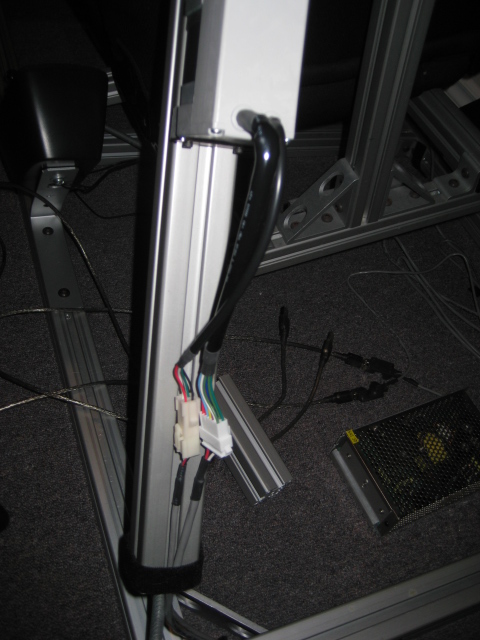

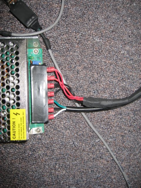

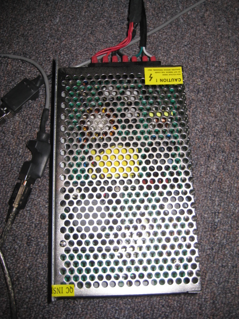

    Ok, i took apart my wires and here is my setup. 2 x actuactors with 2 wires each. One going to a plug that converts to a usb(pic) and the other going to the power box in the pic. From the power box a thick black plug that goes to the electrical source. I also have one grey thick plus that goes to an on/off switch (this just prevents the actuators from moving)...yes I tried turning that on and off and it didn't work. Besides, I have never used this on/off switch before.
    Any brave takers to help me out? Thanks

    It looks like basic wiring / conversion of SCN with RS USB adapters, pretty much same thing like in tutorials. So COM3 and COM4 are probably your SCN's, from what it looks like, it should be pretty easy to run it with Simtools. Maybe changing of one SCN ID will be required but first try to test it as it is now.

    Is your power supply working?
