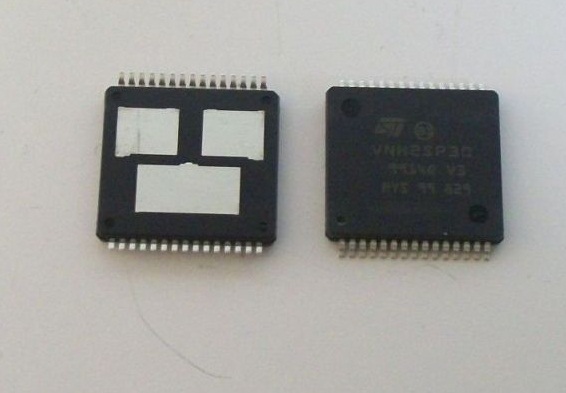

    or i could repair all the boards I have manually with these http://uk.farnell.com/stmicroelectronics/vnh2sp30-e/ic-driver-motor-h-bridge/dp/1739418
    Think I may just replace chips as most of the boards 1 side is fully working.

    @Alexey I have just made 2 working out of 4 :) swapped bad for good on either boards. Got a lot more to test see how many decent chips I can use.
    I'm good with a heat gun and some flux ;)
    The thing is some these chinese ones have no solder under the chip on the 3 pads at all ?!?!? These are proper just shite cheap lol.

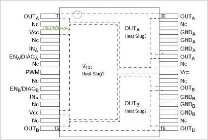

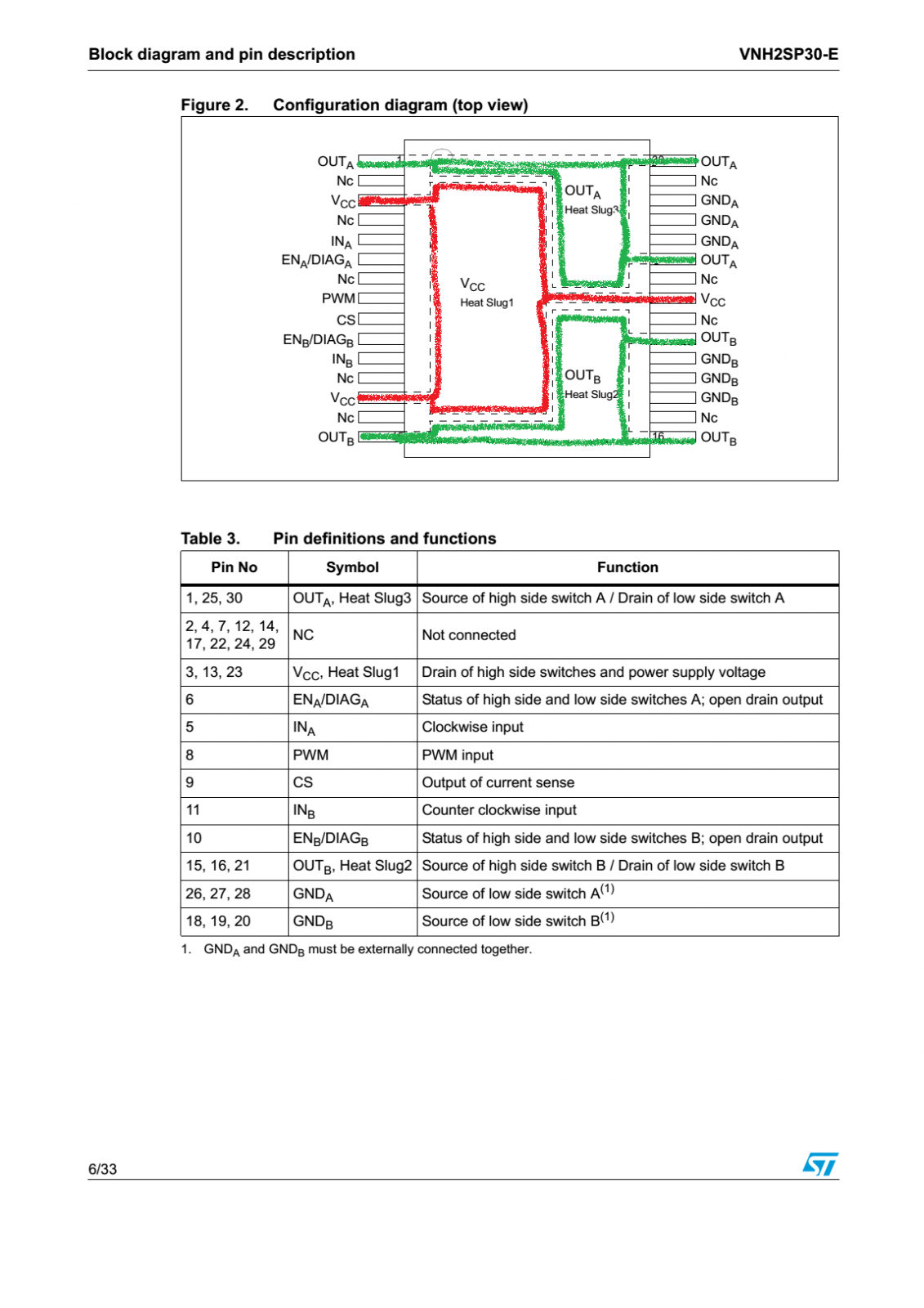

    These pads mainly are for the Vcc and the motors connections big Amp .

    Wow @speedy didn't think to check the Datasheet just thought that they were for heat like @Alexey said.
    I thought it was funny I could actually see right through underside of the chips from one side of the board to the other.
    I'm wondering if the may all just need reflowing and perhaps why some are only driving at half power ? I don't know ?

    @SilentChill ... They are for heat dissipation as @Alexey said :thumbs but not for totally cooling the chip. It still need a heatsink above it ...
    And, This question should be asked to the Chineses ?
    Where do you think the main power big amps terminals for supply and motors are connected to in this tiny legs chip ?
    WE have to be Extra payed for this information if they don't know it and still refuse to admit the faulty MM's .

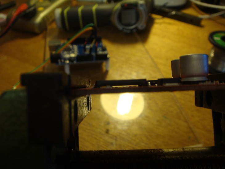

  12. SeatTime
    2,572
    Nice find :thumbs. Unfortunately pushing hard may not always work as look at the gap under this one:eek:. (The bridge you can see to the left side of the chip is not solder under the chip, but the direction leds on the board before the chip) - it is just one big air gap:(. They are not all this bad, but it makes you wonder how they were tested for release and if they even know how these should be placed on a board. This seems to be a big issue for products coming out of China, they are great at just copying stuff, but often without the knowledge/understanding to go with it.

    Yes @SeatTime exactly the picture I was describing .

    That's an evidence of a faulty MM as AliExpress require for all the MM's in one photo @SilentChill
    -They have air gap under the chip . So, it will shut down or damaged by "Chip Over temperature protection" ...
    As in datasheet these are the primarily thermal pads ... and clearly assigned in the datasheet these pads should be soldered too to give the 30A stated performance by the final assembled MM module ... Even in one working direction ... Especially "if @SilentChill would like to keep the product that still has certain value " .

    Yes I did try to reflow a couple of them with a heat gun and infrared temp meter, but with no success and if there is no solder under them, then this is not surprising.

    Correct @SeatTime there is no solder at all :( its amazing how far this rabbit hole is going.

    WOW! There should be ZERO (near to) air gap with this chip. I would say all these cheaper monster motos have been hand assembled and thus why they are so cheap. I've looked at mine and I can't even fit a sheet of paper underneath.
    Is it just me or have those legs been re-bent? They look like they angle too far down giving that raised height.
