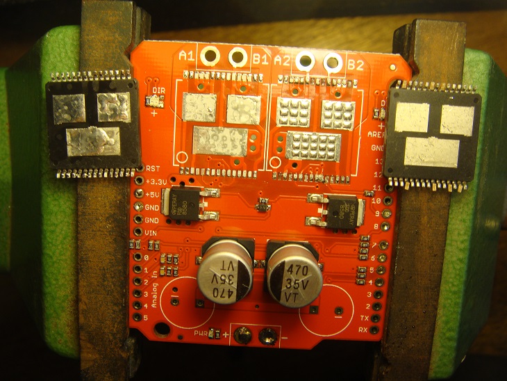

    Just for anyone who is interested, I had removed two chips from the MMs (with a heat gun) to see if they had been soldered (this one did not have a gap that I could see but measured total U/S), the one on the left I think I had flowed myself when removing it, so purposely only heated the right one enough to remove the pins and yes, not soldered at all. Still the original solder pads on the board :rolleyes:. So the one on the left is how it should be, with the one on the right showing how it was manufactured ...:sos @SilentChill will try and not pollute your thread too much, but I think it is good to have this information in one place - Maybe its own thread, so people could find it in a search - sticky even with the costs/frustration involved:think?

    Thtas terrible again mate such poor quality and all the ones coming from China are like this. I bet anyone who needs to get some proper AMPs flowing through will struggle as they will just shutdown

    this looks like realy bad quality. :( But looks like a simple reflow can solve this Problem.
    I have a selfmade reflow station for xbox and ps3. With that i have reflowed many consoles for friends with good success rate.
    If anyone is interested you can contact me via PM.

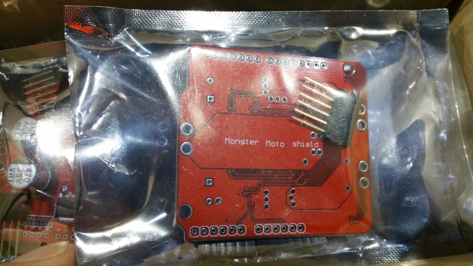

    OK 15 new MM's arrived and they are not sparkfun copies. They are Monster Moto's
    Never had these before so fingers crossed .

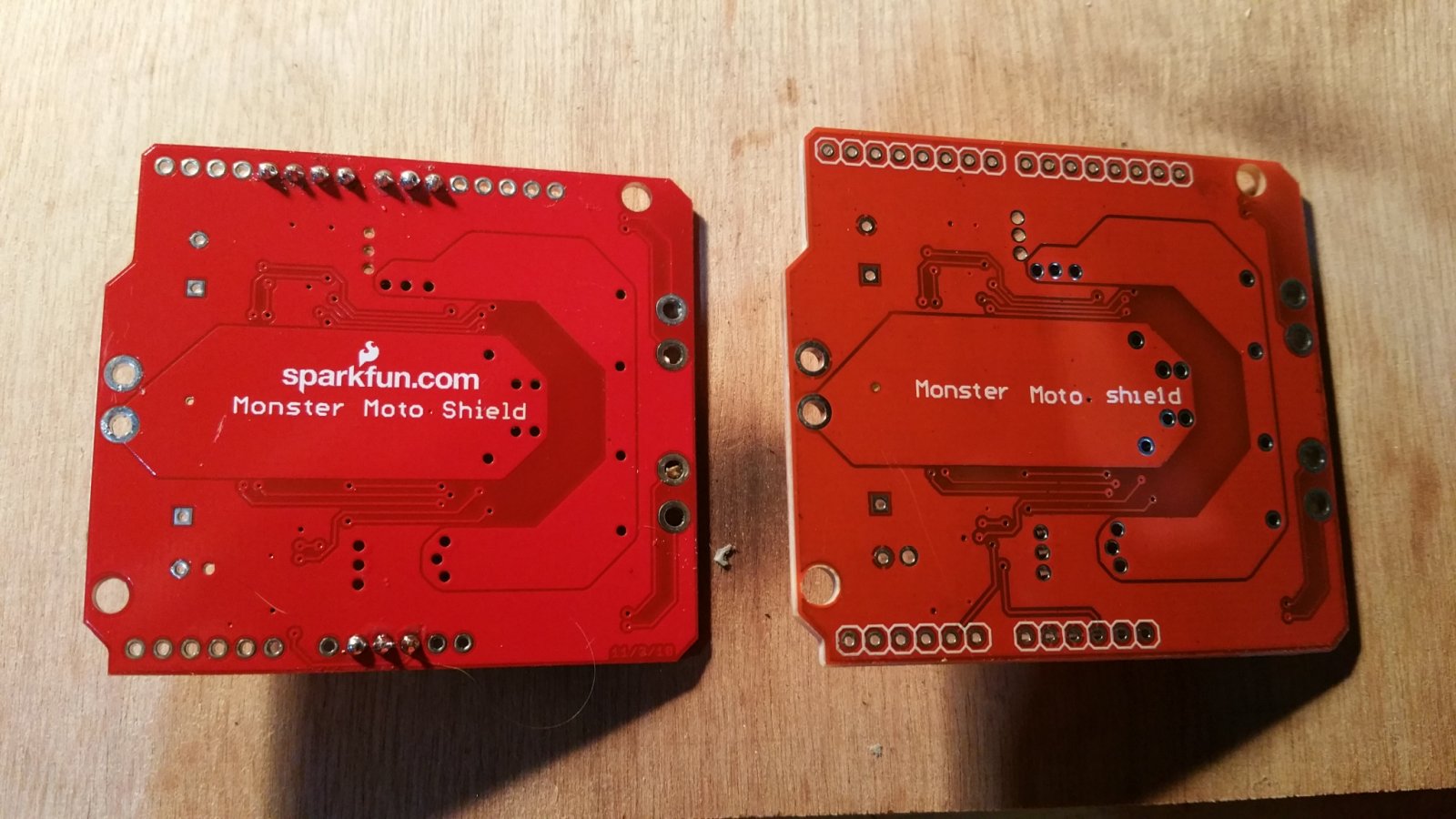

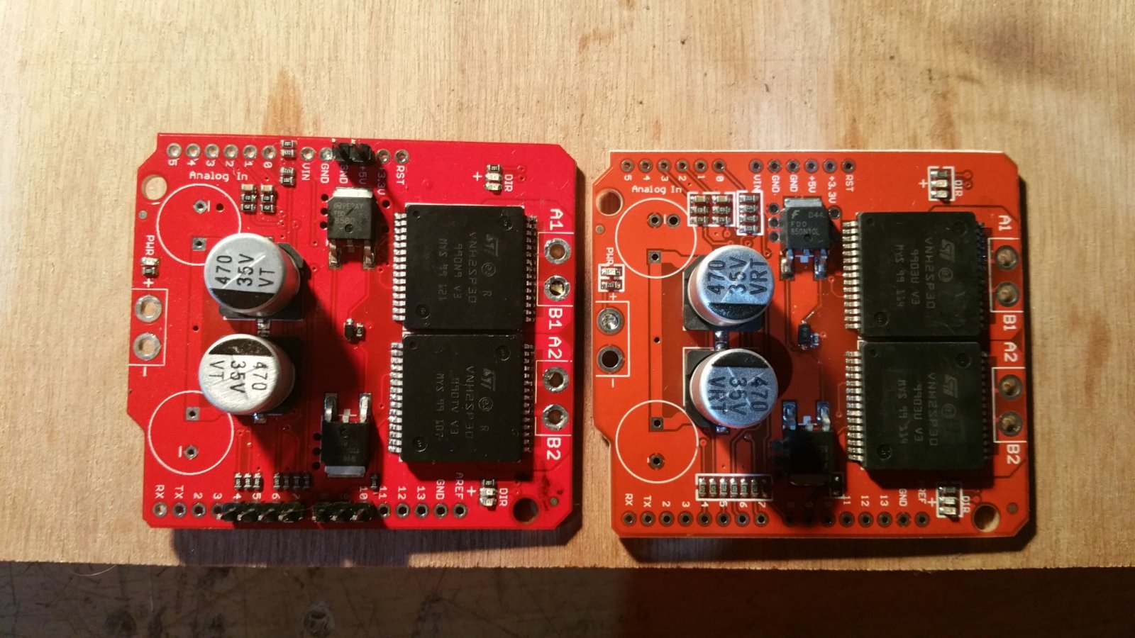

    14361981767241817373419.jpg 1436198255234-81244297.jpg 1436198557940383672198.jpg
    Obviously new ones on the right. Slightly different pcb and the chips are flat to the board.
    Oooooooooooooooo I'm excited need to test ASAP !!

    old ones are clones and new are copies. what i mean is that some Chinese want to copy the brand too (clones) except the patent and some copy the patent only(copies).
    i prefer to buy copies(not only MM). i have seen that they are more quality than clones.
