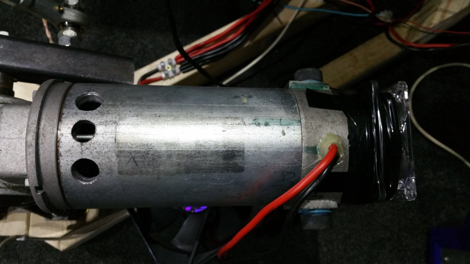

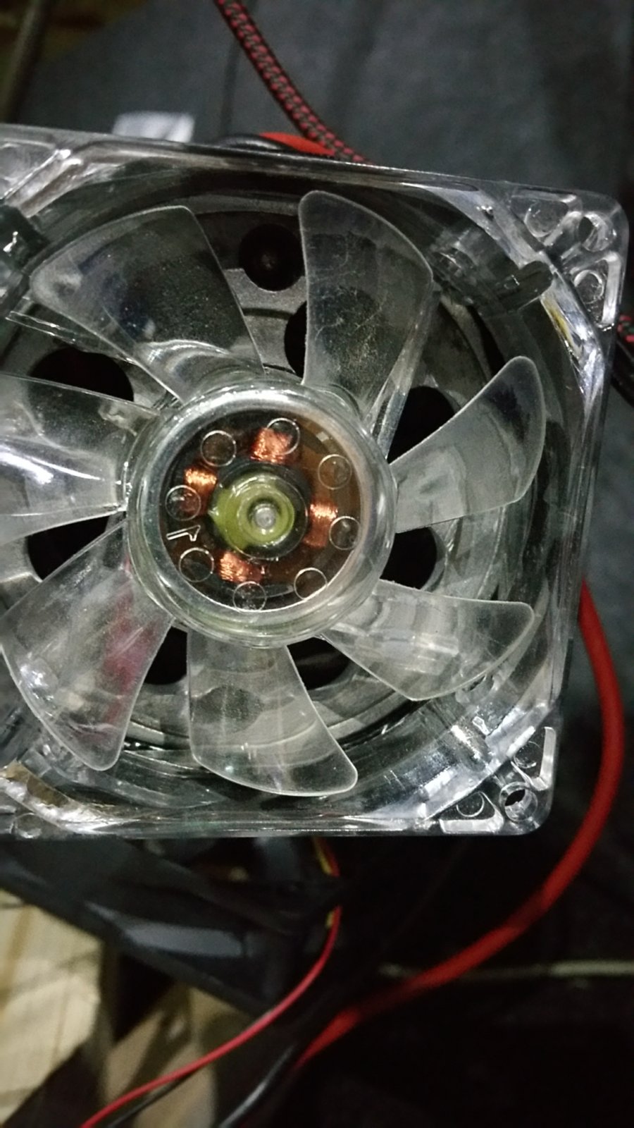

    Ok initial testing on the cooling looking good. Had about an hour last night on Dirt Rally and it was tuff and ruff on the motors but they were just luke warm to touch, thanks @Alexey
    Let's see how these go I may be able to move back to 7o or even 90 CTC which would be loads better for Prepar3d

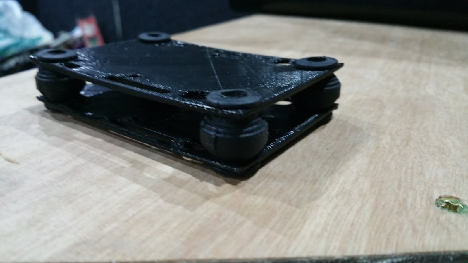

    And here is my new Rift cam platform, it's not going to work I can tell already lol. Will try and see I guess

    these do a great job on a quad copter, but i Also agree that they might be a little too small/weak to deal with the Oscillations were dealing with. worth a shot tho. :thumbs

    Well I was right the rubber bung platform does shite all its rubbish lol. Oh well back to the drawing board.
    On a brighter note the fans cooling the motors are spot on still only getting luke warm after hours of play. May try extend the CTC tomorrow see how they cope :)

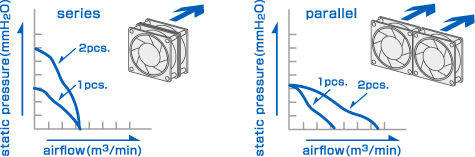

    Attaching another fan in series for each motor will make you forget that problem like Forever ...
    • Informative Informative x 3
  7. SilentChill
    2,645
    20,590Coins
    +3,567 / 34 / -0
    Ooo nice I can do that they are all just 80mm fans , awesome thanks !!! @speedy

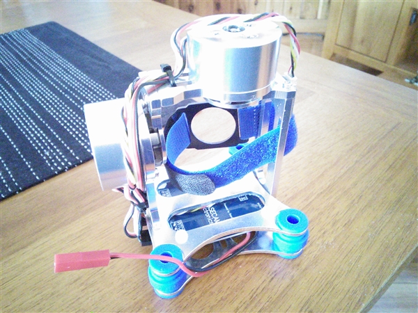

    It is still on my todo list but at some stage I will get around to testing this gyro stabilizer with the Rift camera.
  9. SeatTime
    2,573
    Your dead right, neither this, or the gyro stabilized platform will work by themselves.

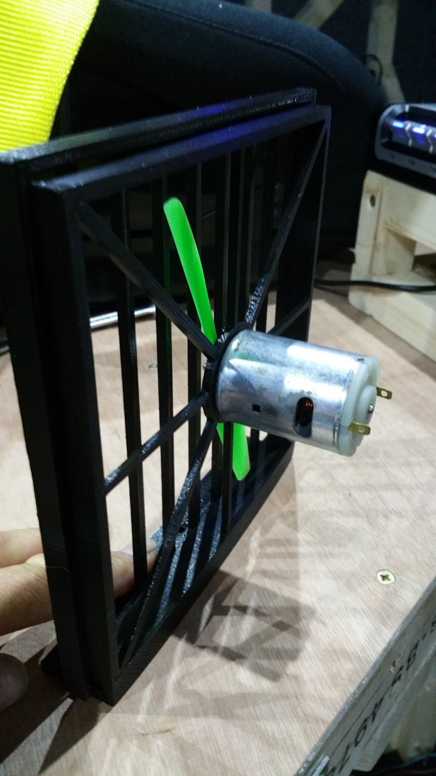

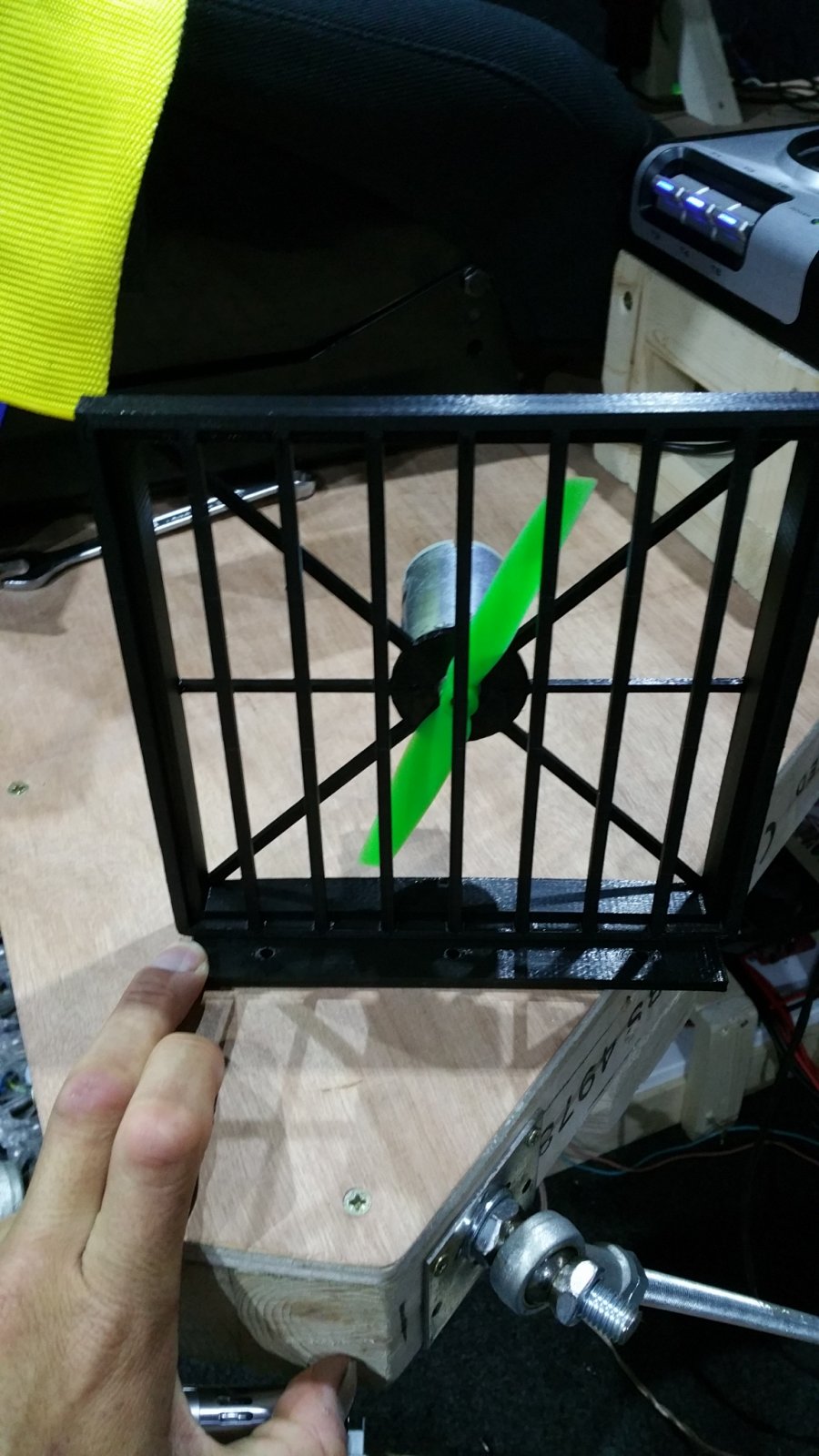

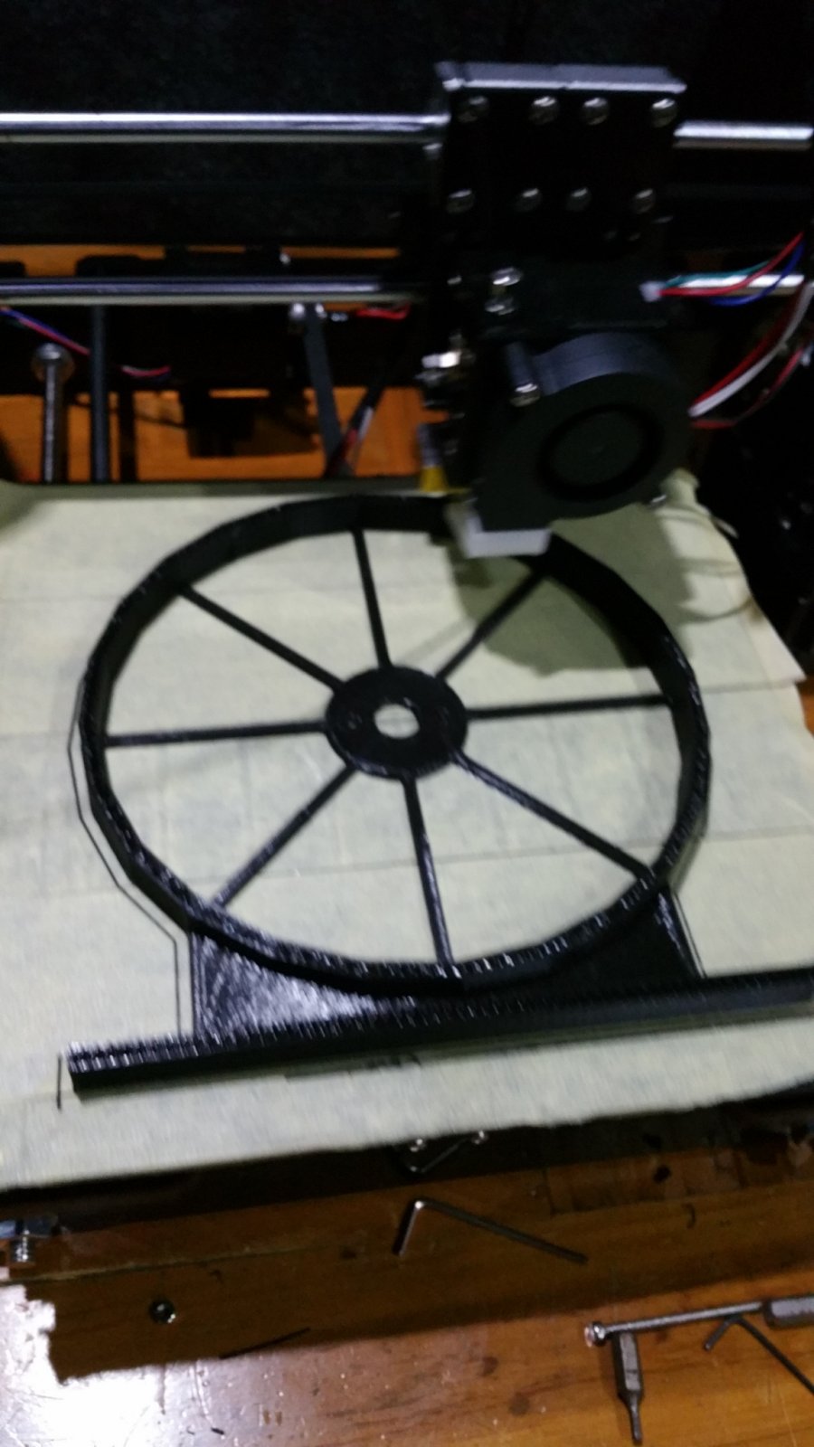

    Got my 3d printer up and running so time for some custom fan holder/grills this is Version 1 a bit square lol
    And this is Version 2 printing as I type :)

    Thought I would give it a lick of paint whilst I was printing 1439576338451-359428053.jpg

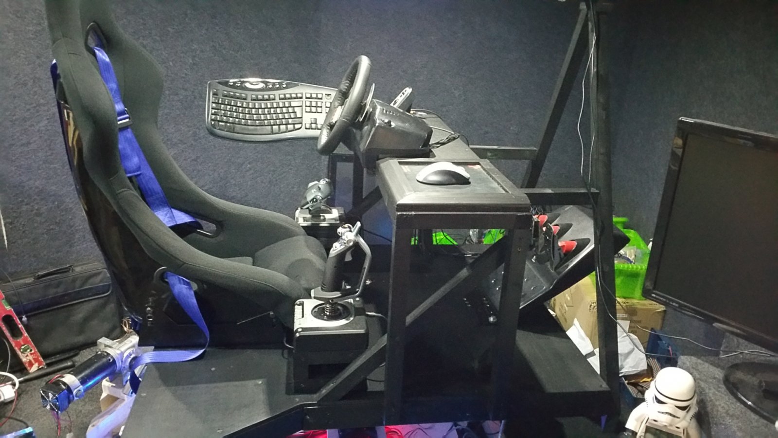

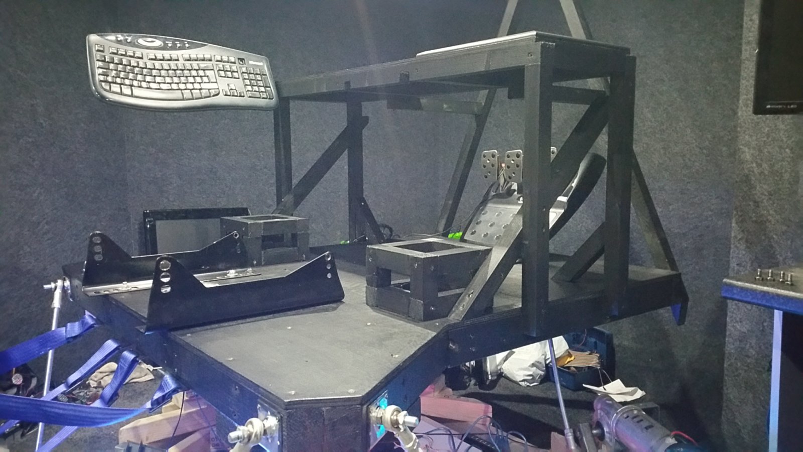

    Sorry for the lack of updates but I have been busy away on holiday in the sun and tweaking and adding to my rig.
    I have added some gas dampers to the rig (4 of them) and I have no gone back to 95mm ctc arms. What a difference, I can play for hours and the motors don't get hot at all. Thanks and credit goes to @mrbeginner for pointing me at the video of the dampers in action. I could go with even longer arms and just add more dampers its such an amazing but simple solution to all the weight. For flight simming the extra length arms are needed and makes all the difference. I will get a FlyInside Prepar3d video done soon, but for now just cars and rollercoasters.
