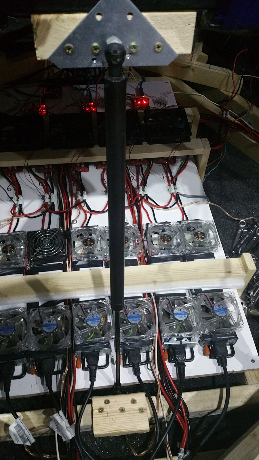

  5. wannabeaflyer2
    Jun 12, 2015
    724
    london uk
    8,350Coins
    +958 / 7 / -0

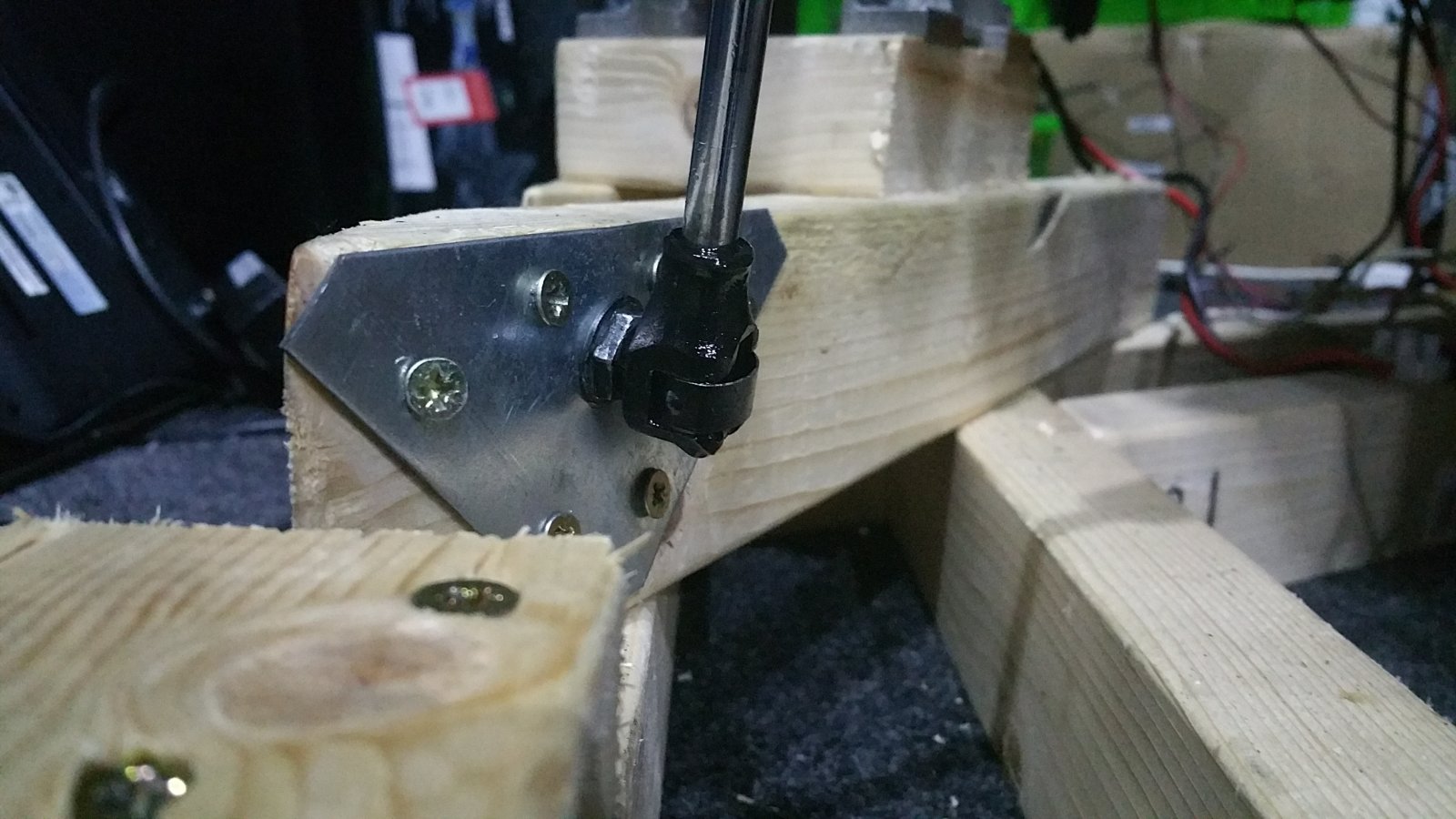

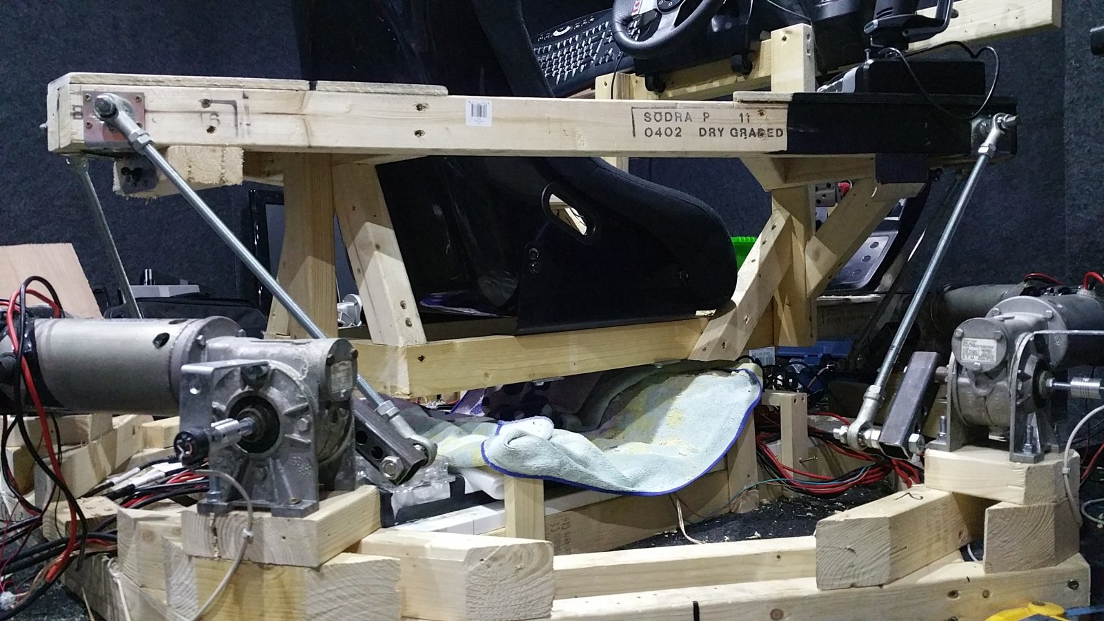

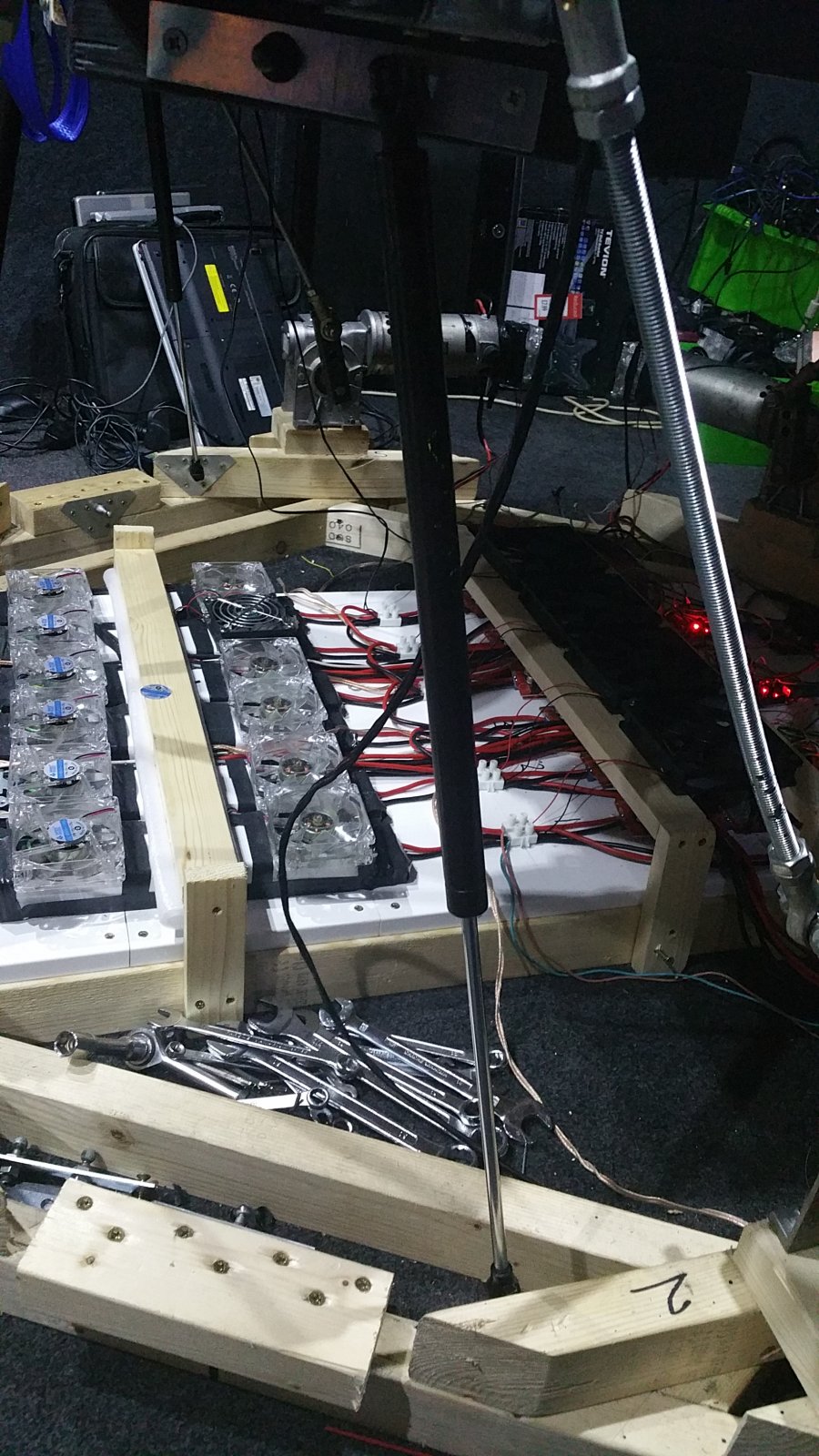

    Hi Craig . gotta be a pest and ask for a picture showing the placement of say one of the gas struts setups :) , you mentioned gas struts to assist the motors ? i finally manged to see them in one of your videos but just need a closer shot Beg Beg Please :) my sim is still waiting for Controllers to be sorted so i thought i may be able to copy / introduce your gas struts method while i have some downtime.. im sorry if it was already stated , but are these undampened ? and you mentioned car breakers ? do you remember what type of car they came off ? this is me pushing my luck , i know but P3D to be ordered and would like to get back to contributing here with my 6DOF rig project any sketch or section pic will do Cheers
    Hi Speedy , i looked at your version but may have missed something in the way its configured and how i'd apply that concept to my 6 DOF design ..
    Just checked the Speedys video again .. my mistake that video is quite clear as to how they are fitted , i must have looked at another video the last time as im sure it was difficult to see the mechanism /.. my appologizes Speedy
    feel free to post any answers in my build page as i dont want to detract from Silentchills project but this could be a key development for my units if im to use the 75-100 CTC Actuator arm positions

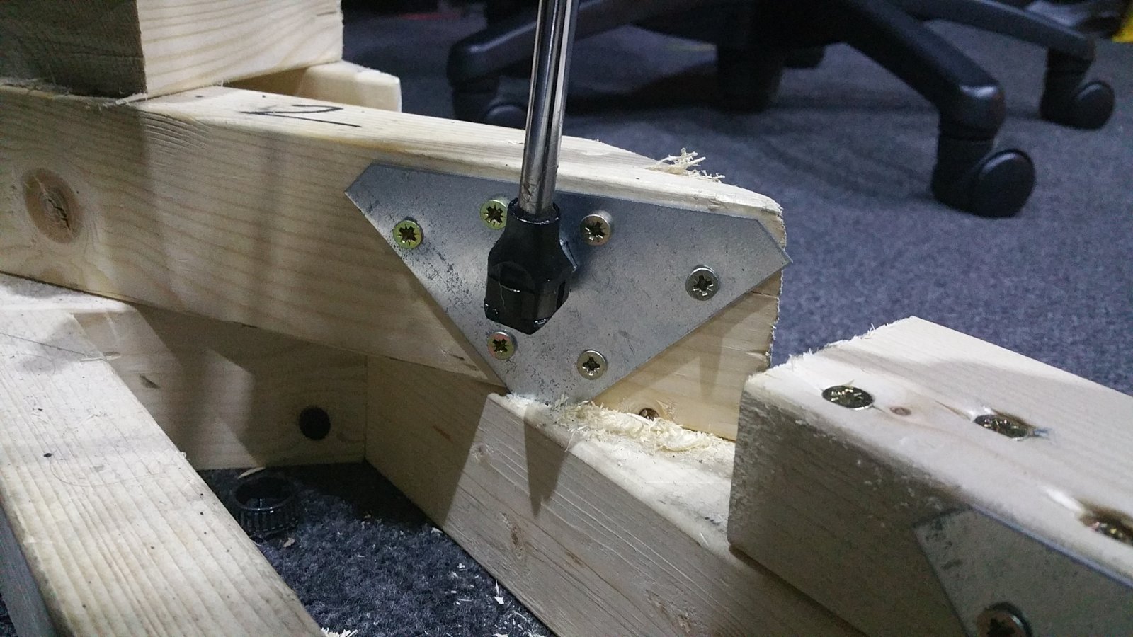

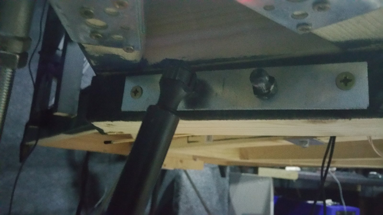

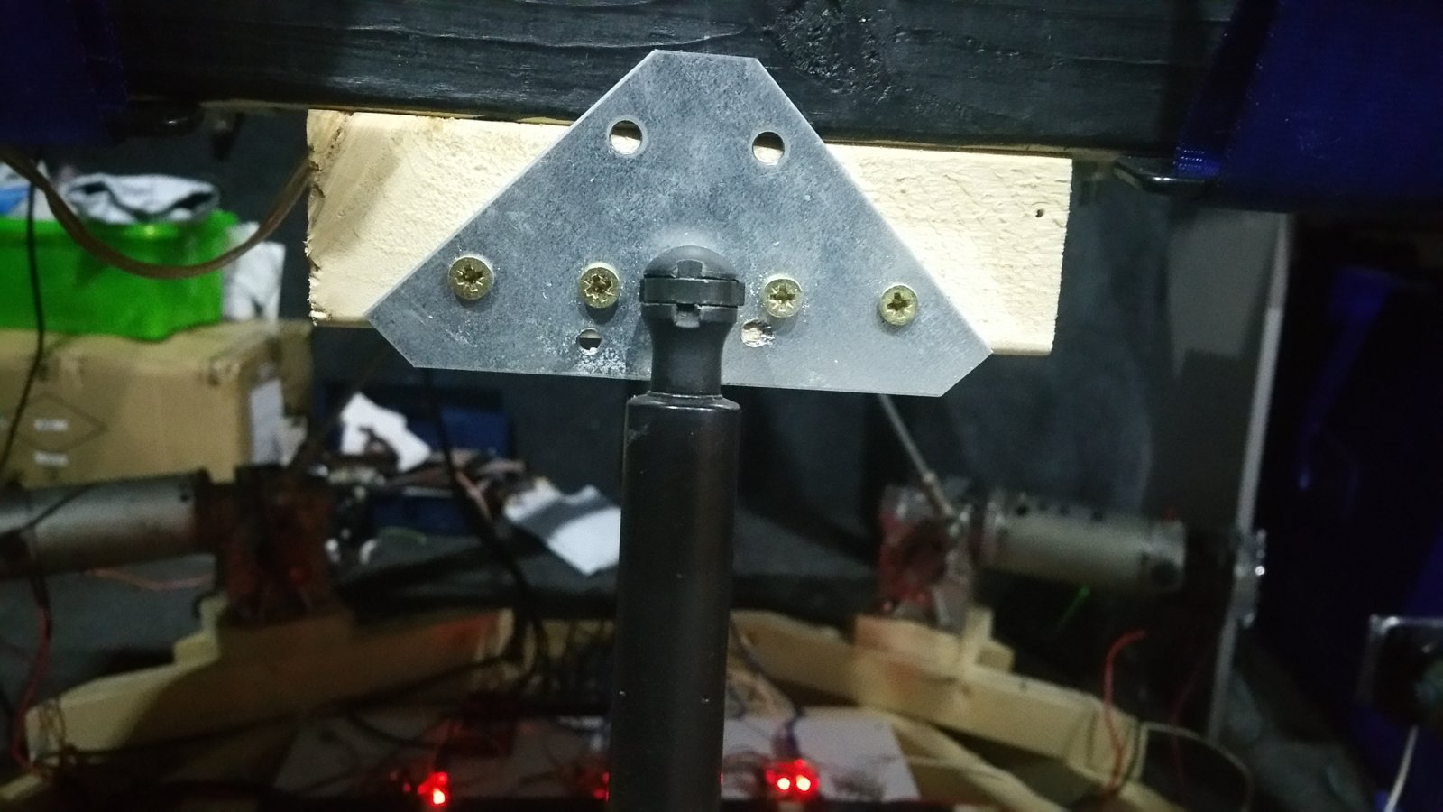

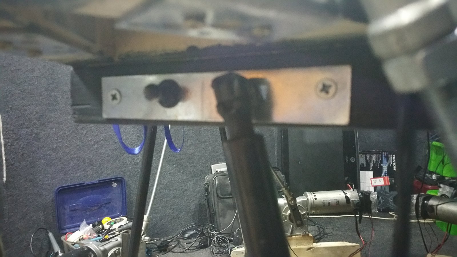

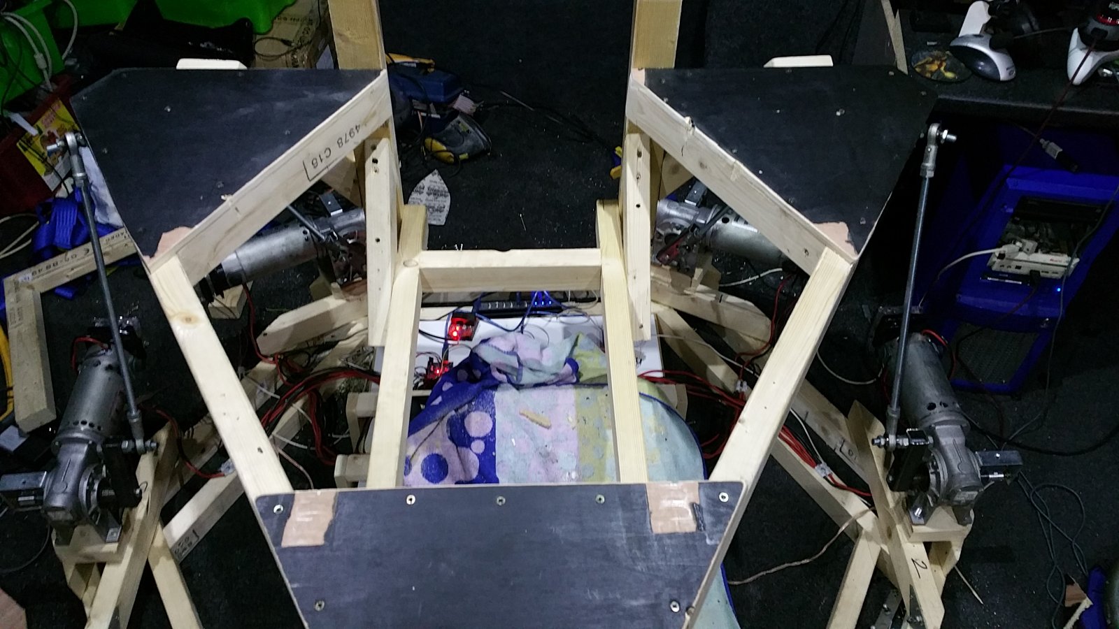

    F.A.O. @wannabeaflyer2 really sorry it taken me so long kept forgetting but finally taken some pictures of the gas struts :)
    20151216_195310.jpg 20151216_195302.jpg 20151216_195206.jpg 20151216_195252.jpg 20151216_195135.jpg 20151216_195235.jpg 20151216_195315.jpg

  9. wannabeaflyer2
    Jun 12, 2015
    724
    london uk
    8,350Coins
    +958 / 7 / -0
    Craig My Man you are a star, those pictures nailed it for me , i bought a couple off Ebay . brand new for £10 a pair .. Took a flyer just to see what the actually looked like , these are the test ones i bought , i they have 200 mm travel length , 18 mm cylinder Diameter , and 8 mm shaft diameter, closed length maybe a 260 mm ,, are http://www.ebay.co.uk/itm/190601275665?_trksid=p2057872.m2749.l2649&ssPageName=STRK:MEBIDX:IT,
    Wont hog your post good buddy just wanted to say thanks for the Idea , still waiting to sort out Controllers , but this upgrade may well be just what i need to get more out of the Platform when its back up and running .. Just realised i need to By the Ball ends separetly D'oh , Once more unto the Ebay life line . Cheers

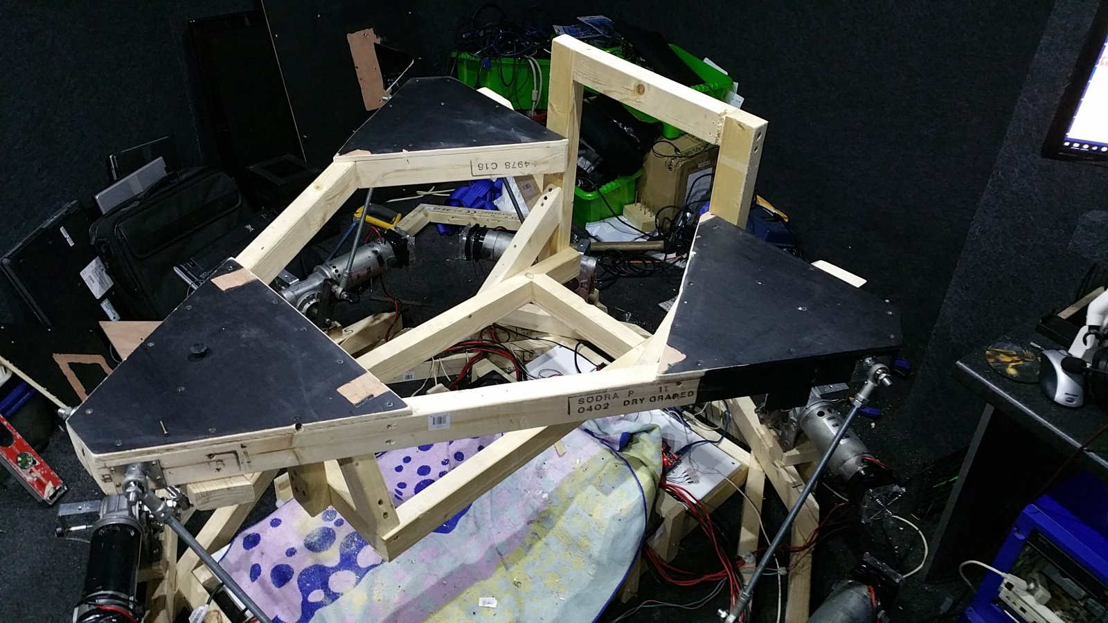

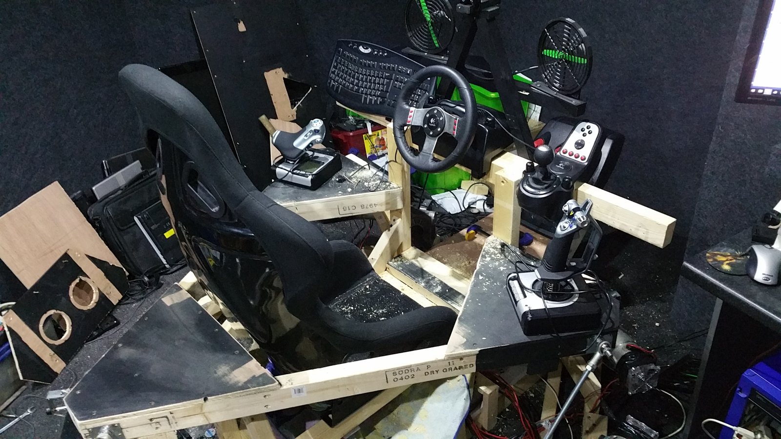

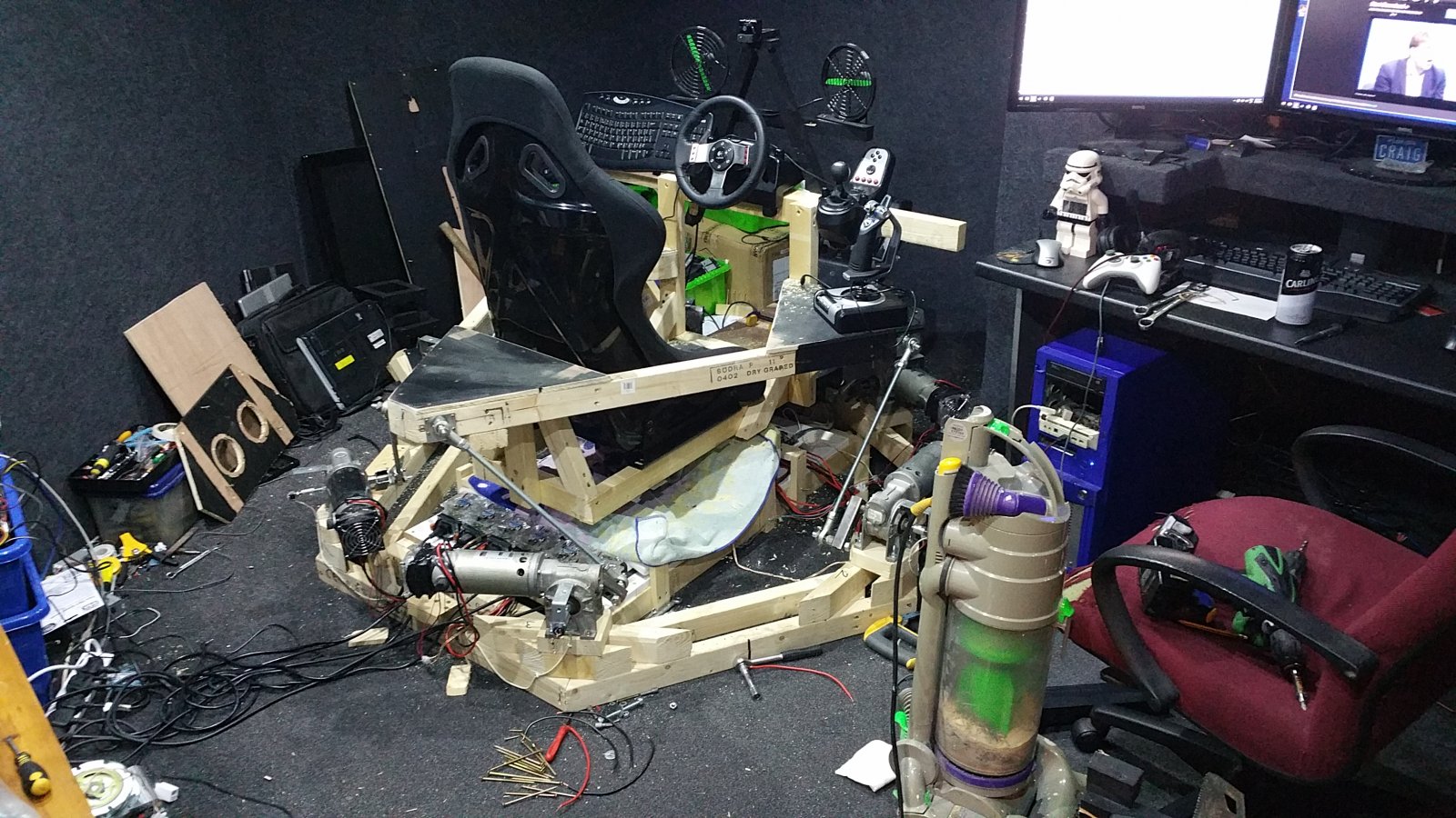

    Quick update, Ive been watching @SeatTime videos and I kinda understand this centre of rotation malarkey. So I decided to copy his a little :D No maths involved just centered my seat and lowered it quite a lot .
    My sim has been butchered but soon will be back up and running and looking a little nicer, I hope.
    Still no maths involved unfortunately but I hope it will be ok. Time will tell.
    Edit: did I mention no maths involved lol I should check before I post

    Getting there just needs some paint and I really need to use that Dyson !!!! 1452808184055153681172.jpg 14528082413031027137710.jpg 1452808344348-517565483.jpg
    Room is like a bomb has gone off time to clean up.
    Just need to wire controllers and stuff and attach the struts and I'm ready to go

  20. SeatTime
    2,572
    @SilentChill I think you will like the change. Having the correct roll center is a positive for realism and your stomach :). It will also lower the load on your motors:thumbs. IMO, the more a sim is able to move the more important it is that you get the roll center correct.
