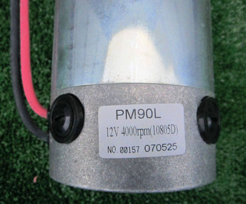

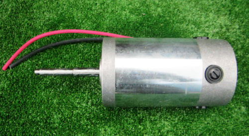

    Well looks like its time for me to upgrade :)
    I'm going to attempt to copy @SeatTime actuator design more or less and using @wannabeaflyer2 changes.
    At the moment I'm collecting Parts:
    6 x BNIB Parvalux PM-90 Brushed DC Electric Motor. 12V 4000 RPM. 270W
    £125.94 (Bargain off Fleabay)
    6 x SFU1605-500mm-Ball-Screw-Rolled-ballscrew-1-pc-SFU1605-L-500mm
    6 x Ballscrew-Support-1pc-BK12-1pc
    6 x LMK25-LMK25UU-for-25mm-shaft-linear-bearing-square-flange-ball-bearing-bush-for-25mm-rod
    £217.02 (Aliexpress got a price direct off seller)
    12 x Roller-Lever-Arm-PCB-Terminals-Micro-Limit-Normal-Open-Close-Switch
    £2.11 (Aliexpress)
    6 x 40-Teeth-GT2-Timing-Pulleys-Bore-6-35mm
    £9.62 (Aliexpress)
    6 x GT2-Timing-Belt-Idler-Pulley-20T-20-teeth-Aluminum-Bore-5mm-With-Bearing
    £8.93 (Aliexpress)
    GT2-6mm-10M-3D-GT2-Open-Timing-Belt
    £8.03 (Aliexpress)
    Timing-Belt-Fixing-Piece-Aluminum-Alloy-Tooth-pitch-2mm
    £10.74 (Aliexpress)
    Bought :
    [​IMG][​IMG]
    Still to acquire:
    6 x BI TECHNOLOGIES / TT ELECTRONICS 8146R5KL.25 Rotary Potentiometer, Position Sensor, 8146R Series, 5 kohm, Linear, 10 Turns, 2 W, Bushing - Will these work as I have no idea ???
    http://uk.farnell.com/bi-technologi...kl-25/potentiometer-7-8-10-turn-5k/dp/1520679
    £ 84.90
    6 x Black-Steering-Universal-Joint-Motor-Coupling-Shaft-Coupler-ID-12mm-OD-25-mm
    £35.16 (Fleabay)
    6 x 25MM-OD-x-22MM-ID-Carbon-Fiber-Tube-3k-500MM-Long-with-100-full-carbon
    £80 (Aliexpress hopefully get these cheaper)
    Nuts and bolts and some threaded bar to hold it all together. Oh some wire and other stuff :D

    Those Parvalux are incredible cheap and powerful. Saw them on ebay UK and other places in UK.
