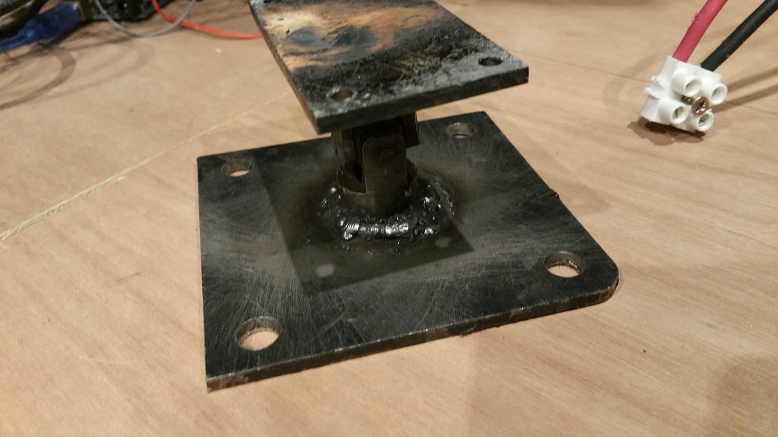

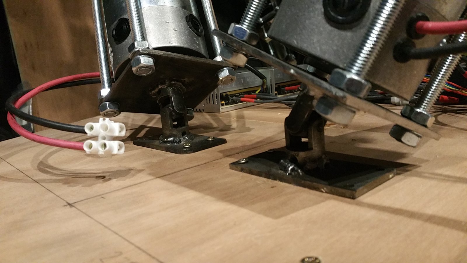

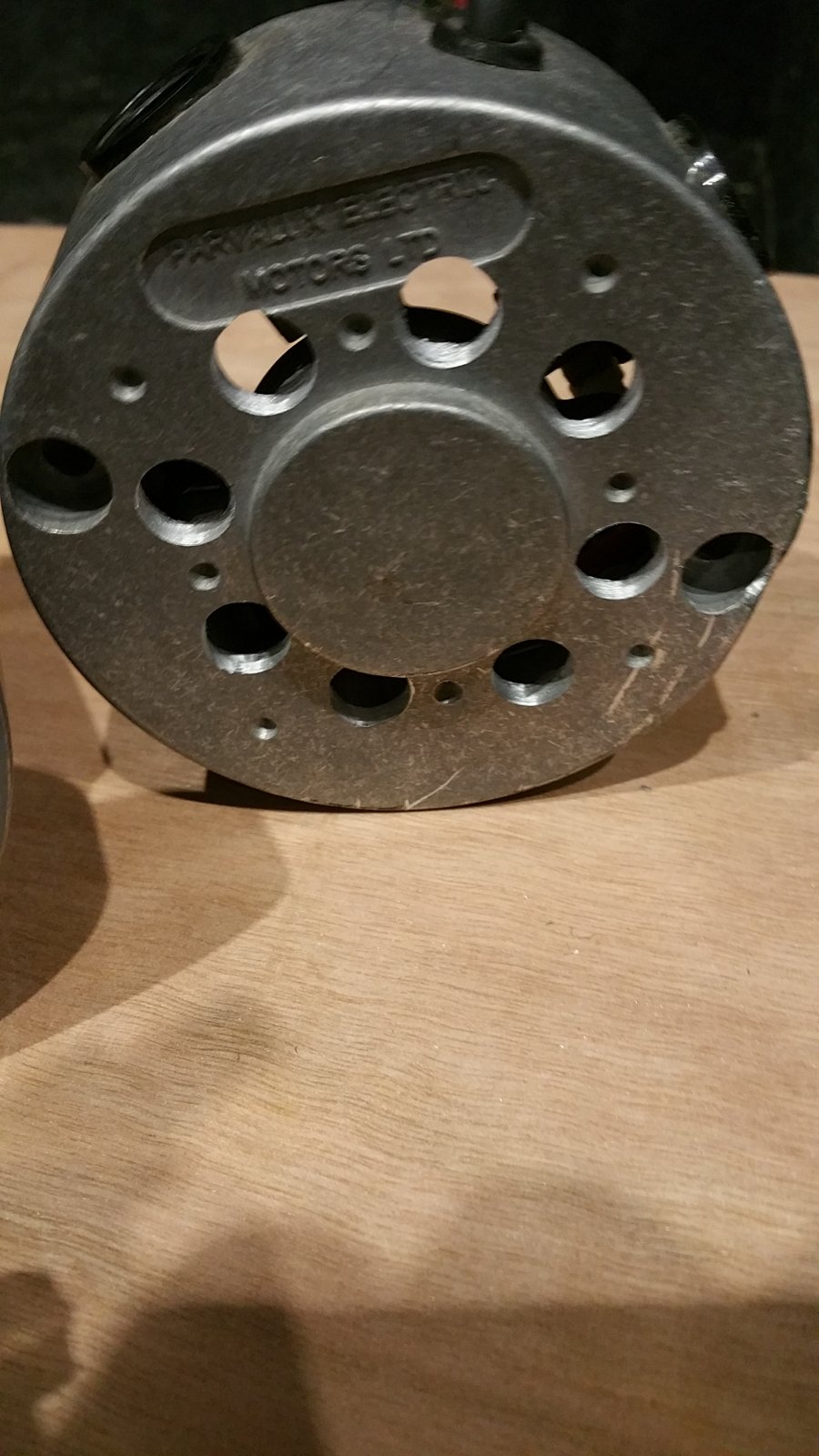

    I'm increasing the angle of the actuators and I think it will help just by feeling the weight of the load with 1 actuator disconnected from the rig I can tell that it feels lighter which deffo should help my cause. I have also drilled holes in the motors to let some air in because they are totally sealed there is no chance of any air to get in and circulate. Also taken the opportunity to make some proper base plates to weld the UV joints to on the bottom of the actuators with 4mm sheet steel this also gives me an extra 35mm to play with whilst raising the angle. I reused my old brackets and bolted them to the top of the platform which gives me an extra 120mm so with the greater angle the platform is actually at the same height :)
    Pictures to follow :)

    Well the rig is back together new angles and holes in motors :D
    20161216_102410.jpg 20161216_102423.jpg 20161216_102500.jpg 20161216_102512.jpg
    Excuse the welding never had to weld in a circle before :confused:
    Just need to get cleaned up and get testing ............... again :think

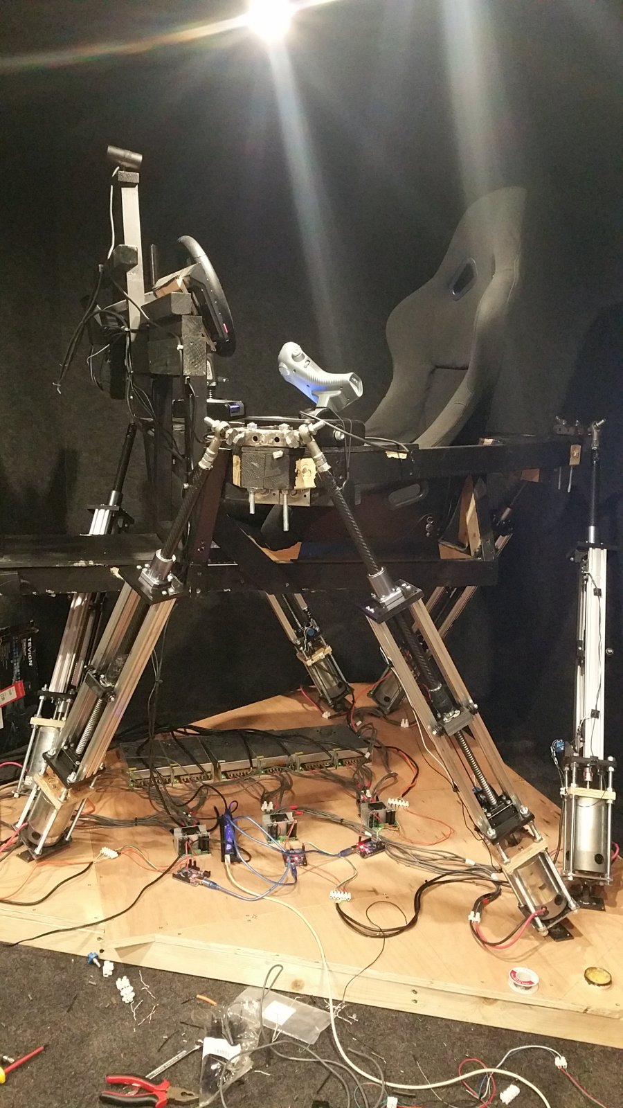

    Its definitely better with the increased angles and holes in the motors. Testing going really well and I am getting more and more happy with it, I just need to tweak all the tuning centre settings now I have the PID somewhere near where I want it to be.
    Little video of NoLimits2 wind is working great although you can't tell from the video
    More DirtRally soon as that will break it or make it :)

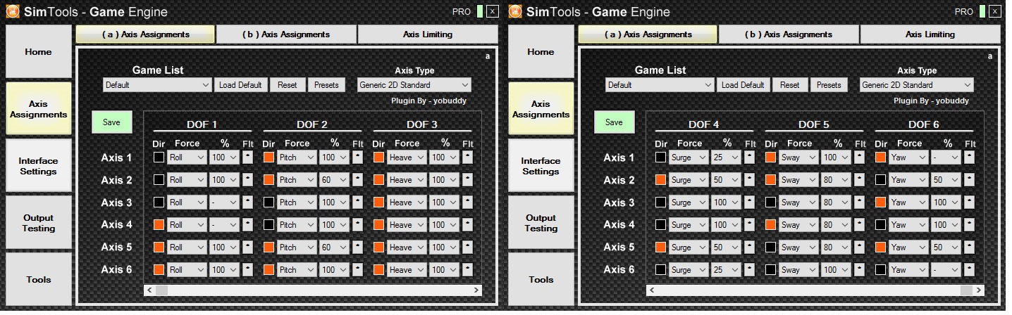

    @SeatTime me bothering you again :) Could you have a look at these Axis settings do you have something similar or am I way out lol
    Think I've got the rotation in the right spot and it feels pretty good. Yaw is actually traction loss just easier to test it using Yaw
    EDIT: Axis % is purely for testing I don't use that amount in games :D
  16. SeatTime
    2,572
    Depends how you have your actuators numbered/placed in relation to the outputs in simtools, Might be telling you to such eggs, but just do one DOF at a time and it should be obvious if something needs adjusting. Your been down this road before :) just linear actuators this time.

    Yeah I did setup one at a time took me ages as usual, i did have a few totally wrong. just wondered if you had similar values. I think and I feel like it's nearly spot on
