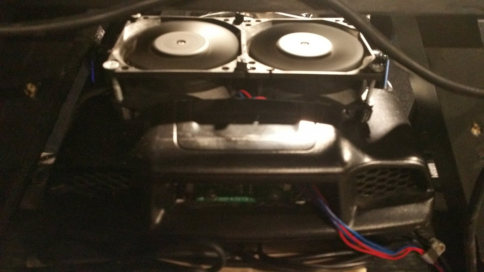

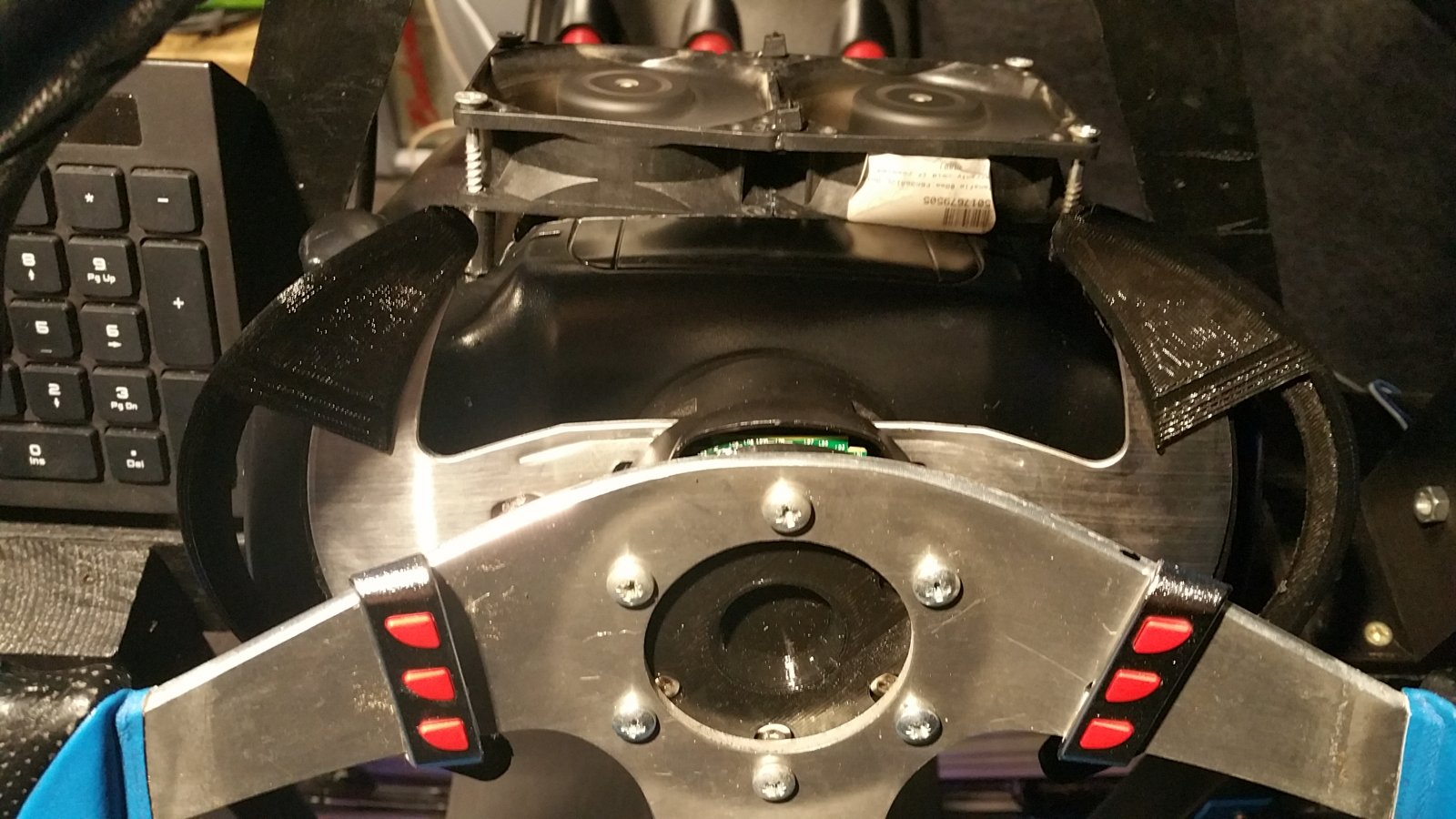

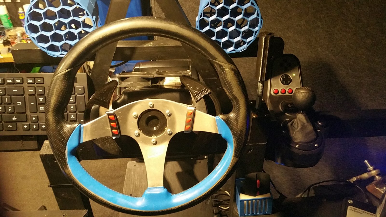

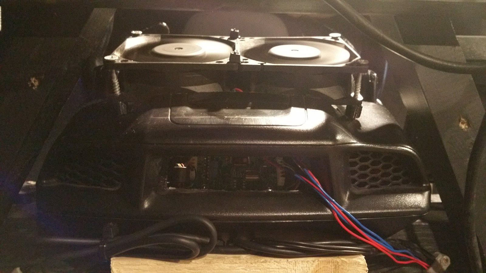

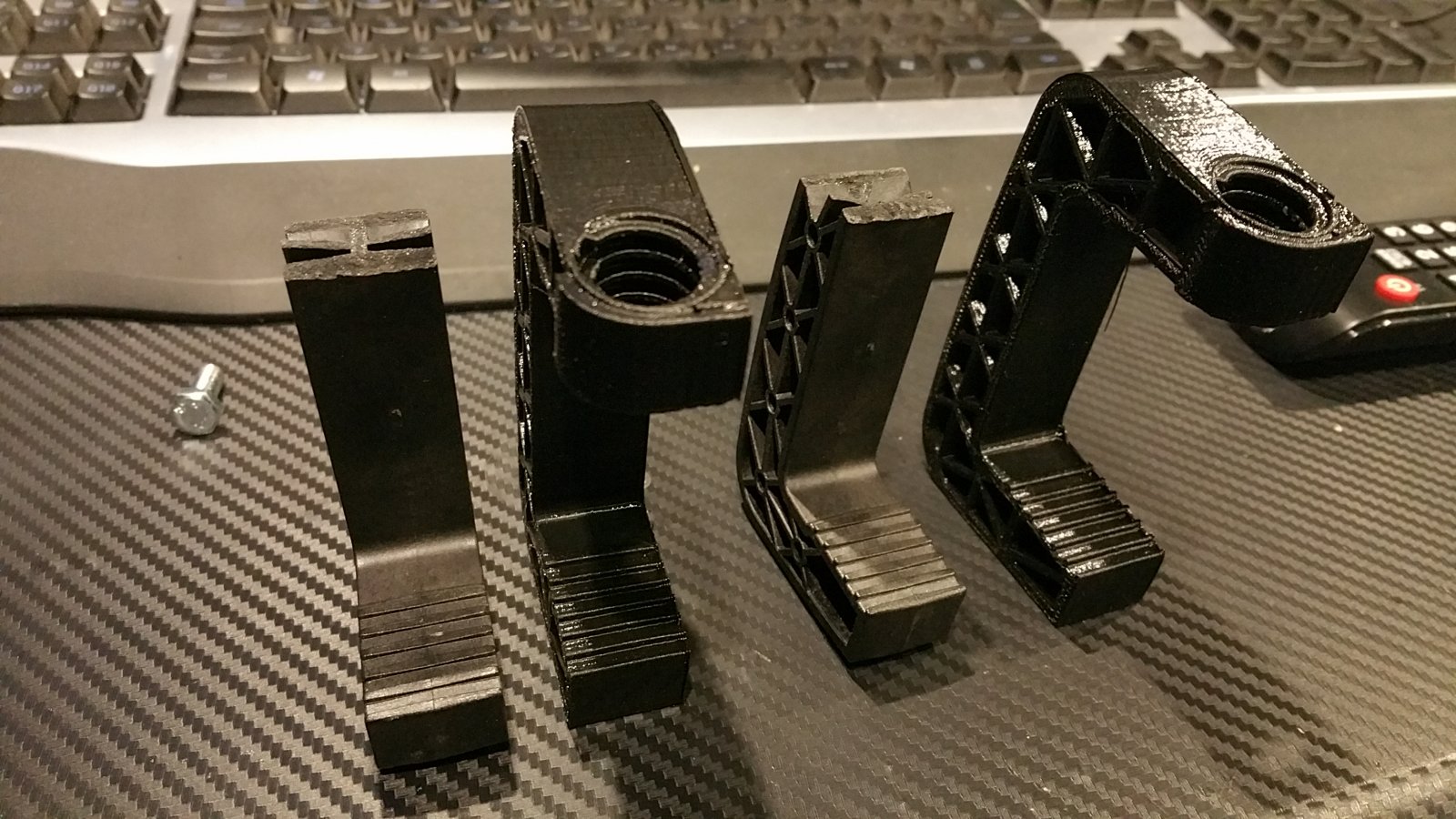

    Ok so I've done some repairing and upgrading :D
    Seen as I was taking the wheel apart thought I would put a new wheel on it :) and also I got a 24V 5amp PSU turned the power up to 28v cut some holes put some fans on it and printed parts to make it all fit together and work. Still got all the buttons working so happy days. 20161229_112716.jpg 20161229_112736.jpg 20161230_185846.jpg 20161230_185855.jpg 20161230_185959.jpg 20161230_190005.jpg
    I've just had a few stages on Dirt Rally and all I can say is wow what a difference. On its last legs but the old G27 it's not going out without a fight lol.

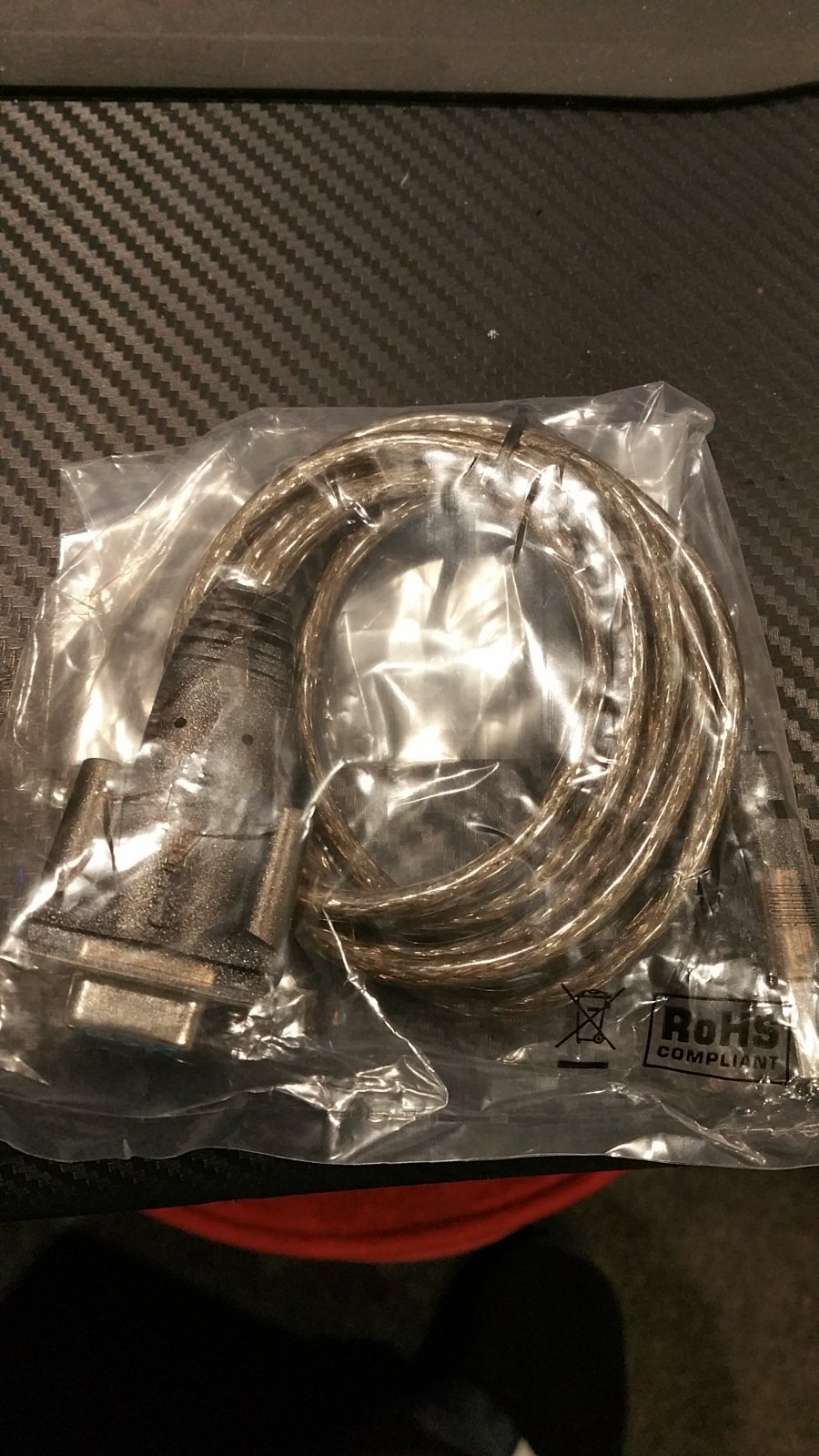

    Also got a Leo Bonar cable for my pedals and I have ordered some nixim pedal springs and rubber thingy. Still waiting for those to come.
