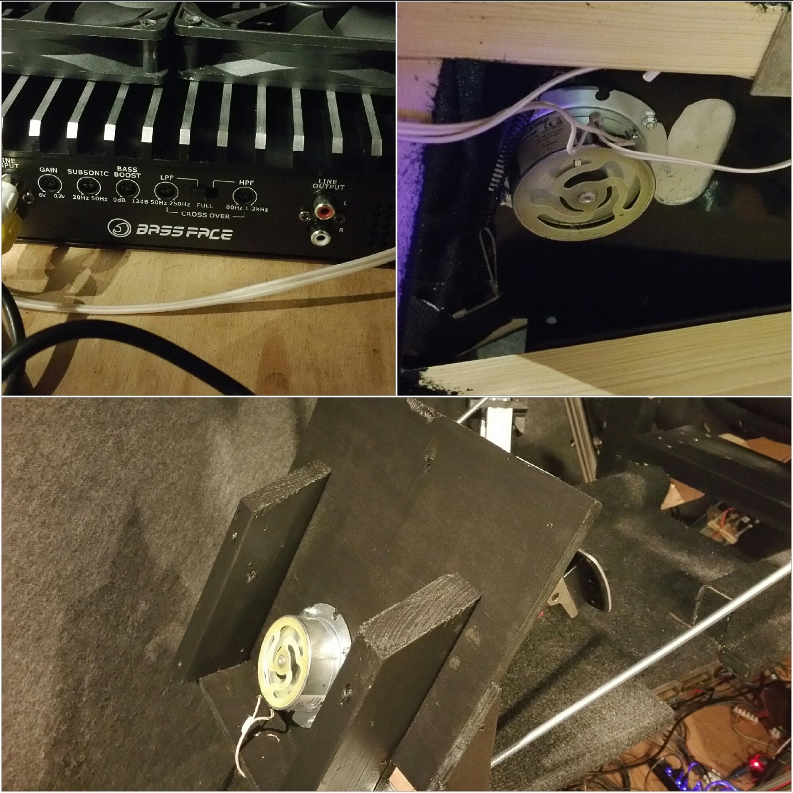

    Forgot to post these pics, I got a new 800w amp and got my transducers hooked up.
    The effect was pretty amazing just using the LFE on the amp, the revs and bumps are just great. Feel the vibrations on the pedals and all through the rig and under legs/bum/back :D
    Can't wait for gamevibe to be ready @yobuddy hint hint.

  7. SeatTime
    2,572
    Nice . Reminds me that I must hook up my Buttkicker one day - still sitting in its box from when I used it on my old rig :rolleyes:.
