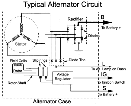

  10. SeatTime
    2,572
    Not saying it 'will' be a problem :) , but it is not good design to have a charging circuit with no regulator to stop the battery being overcharged (can even be a safety hazard). I would just run the power supply at 12vDC, you are really only using the battery as a big capacitor/filter.

  14. SeatTime
    2,572
    Well yes and in your case it is obviously not a problem, but all car charging circuits do have a regulator. Just wanted to make sure that everyone understood what is going on.

    Totally agree and my Regulator is the PSU's they will only ever output 13.8v. To my understanding this is the minimum an alternator will ever output and will only really be a trickle charge, so in theory (in my not so brilliant brain) it should be safe ????
