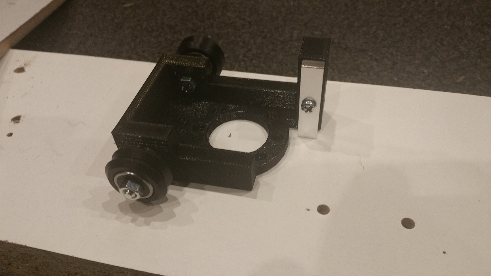

    @SilentChill I have a question about this part:
    This is 3D print right? What's the filling percentage you used for it?
    Thanks.
  6. SilentChill
    2,645
    20,601Coins
    +3,570 / 34 / -0
    I cant see the picture matey ? But from what I can remember I used 50% for most of the stuff I printed apart from the wheel QC which was 100%

  8. SilentChill
    2,645
    20,601Coins
    +3,570 / 34 / -0
    I directly attached the carbon tube to the ballscrew with carbon. The v-wheel mount is to stop the ball screw spinning and also to connect the belt for the Hall sensors.
    Wheel QC was suppose to be QR lol sorry :D "Quick Release" for the steering wheel
  9. Pierre Lalancette
    Dec 11, 2016
    1,009
    Tech Artist
    Quebec, Canada
    8,043Coins
    +945 / 6 / -0
    3DOF, DC motor, Arduino, 6DOF
    I wouldn't have understand QR either, so don't sweat about it.
    That means it was 50% filling, but not fully supporting the bond between the carbon tube and the ball screw. Make me wonder even more...
    Thanks for the info.

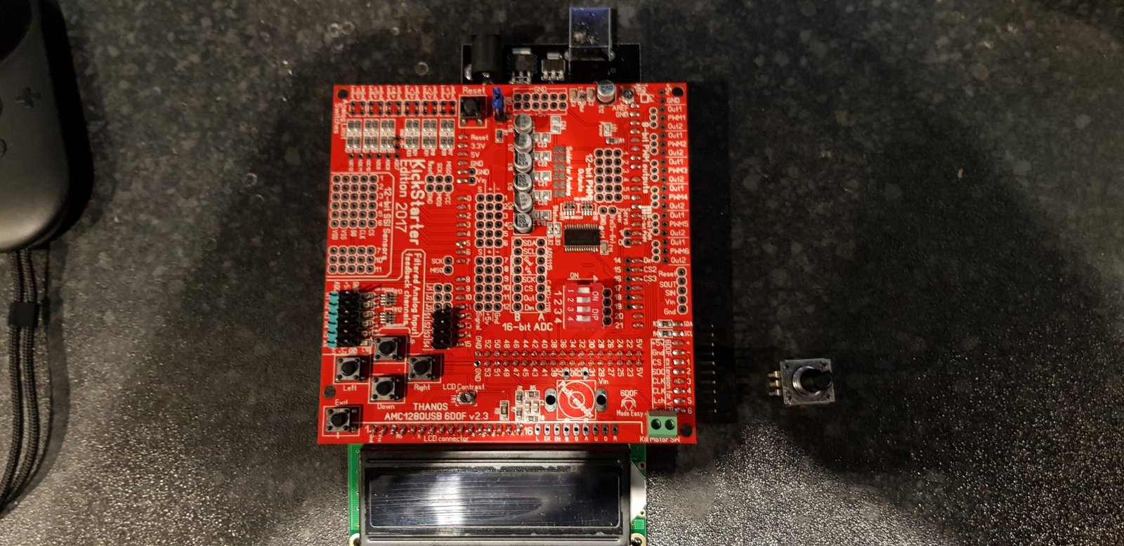

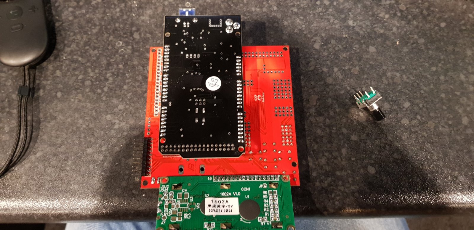

    I received my Thanos board last week only just got round to opening it now. It is pretty sweet however I have No idea what to do with it :D
    Time to go read up and figure out how to install it.
