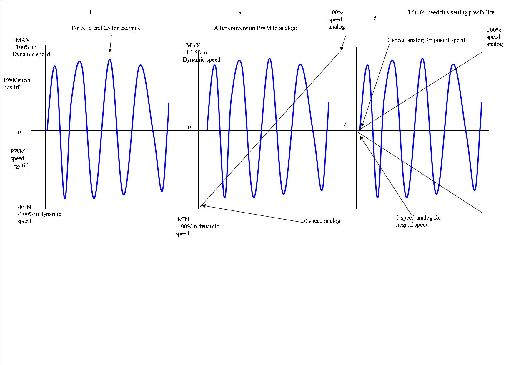

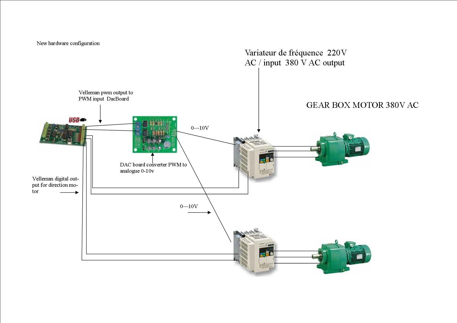

    after discussion with Nima, I discovered a problem with speed.
    I use Dynamic speed, but my variable frequency speed analog use.
    conversion of analog PWM is not good, x sim uses + / - 5V to an axis in positive and negative, and x sim can not give good indication of my speed engines
    I think this is not possible with x sim.
    should be a real management in x sim for analog speed
    For example:
    output for the + X axis: 0 to 100% speed with variable speed from 0 to100%
    output for the -x axis: speed 0 to 100% speed with variable speed from 0 to100%
    ditto for Y ....
    I am looking for help
    Here are some schema to include:
    thanks for help

  13. riton
    riton Active Member
    Jul 6, 2007
    600
    1,006Coins
    +103 / 3 / -0
    Re: Riton' 2DOF with AC gearhead motors/ need help for speed
    i need help, have you somes idea, informations....
    in dynamic speed :
    -100 %................ 0 have the speed to the negative axis and 0 .................. ......+ 100% was the rate for the positive axis
    but the trouble is that converted to analog, it gives a variation of speed completely sucks, the -100% seems to be 0 and 0 becomes 2.5 V
    and 100% becomes 5V
    You need a change from 0 to 5V per axis makes
    thanks

  15. riton
    riton Active Member
    Jul 6, 2007
    600
    1,006Coins
    +103 / 3 / -0
    it's really easy to understand!
    not require technical documentation
    I use the velleman card , the digital output for the direction , and the analog output for the speed, I transform the PWM signal to analog with the small card (DAC BOARD PWM converter ) (the analog output gives the same result directly)
    just looking at my diagram above for the links, we understand.
    Xsim not give the speed of analog output, PWM only, that's my problem.
    section dynamic speed in synaptrix
    there is no other way in XSIM to have a speed control Dynamics Output Card
    speed effect is given
    speed effects:
    -100% .............0.................+100% for PWM
    -100% = 0V ........................0=2,5V ..............................+100% =5V
    for example for X axis:in PWM
    -100% = 0V ........................0=2,5V for the negatif axis ( for exemple, i think it's correct ...)
    0=2,5V ..............................+100% =5V for positif axis
    but for me, in analog output i have just only one speed : -100% = 0V ........................0=2,5V
    my maximum speed i 2,5V , not 5V
    I have not properly accounted for the speed
    I need a real speed analog output for each half axis
    for - X analog variable speeds from 0 to 5V, 0% to 100%
    + X for an analog variable speed from 0 to 5V, 0% to 100%
    for - Y analog variable speed from 0 to 5V, 0% to 100%
    + Y to an analog variable speed from 0 to 5V, 0% to 100%
    is very simple, but nobody understands me .....
    I don't understand why someone can not just answer to my problem!
    It is said that XSIM works this way:
    3 Reference 4 picture
    http://www.x-simulator.de/wiki/Pneumatic
    my setup is the same, but with a variable frequency, and a motor. (look my diagram)
    people here are all very intelligent and capable of manufacturing simulators! It's easy to understand what I did!

  20. riton
    riton Active Member
    Jul 6, 2007
    600
    1,006Coins
    +103 / 3 / -0
    I need official explanation for dynamic speed
    how dynamic walking speed, which corresponds to -100 %....... 0 ........+ 100%
    I think -100% = 0v and 0 = 2.5v and 5v = 100% is correct??
    Is there 2 variable speed PWM? one between 0 and2.5v and one between 2.5v and 5v?? is correct?
    Who uses dynamic speed here?? I need to speak with someone who understands this function and uses
    thank you
