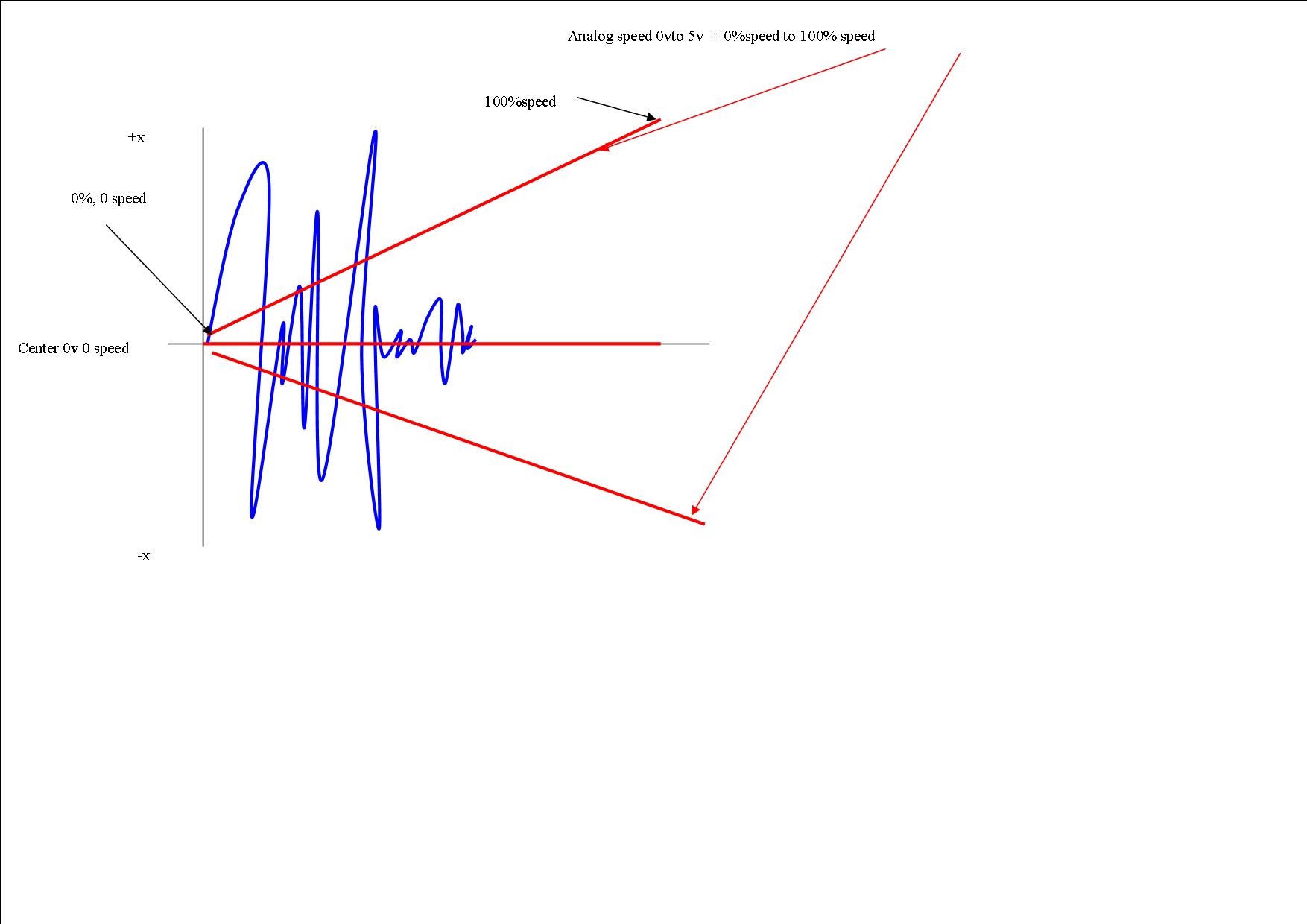

    when I testing with the program Velleman, Iwas a variation of 0 to 5V analog, with x sim is different, there is a change from 0 to 2.5v and 2.5v to 2.5v with 5v set on 0 axis. This is not a correct analog variation.
    for analog output:
    should be 0 ... 5V, 0 volts to the center and 5 V + X (for example)
    for 0 ....+ x = 0v ...... 5v
    0 .......-x = 0 ... 5v
    0 ....+ y = 0 ... 5v
    0 .....-y = 0 .... 5v
    .........for other axis

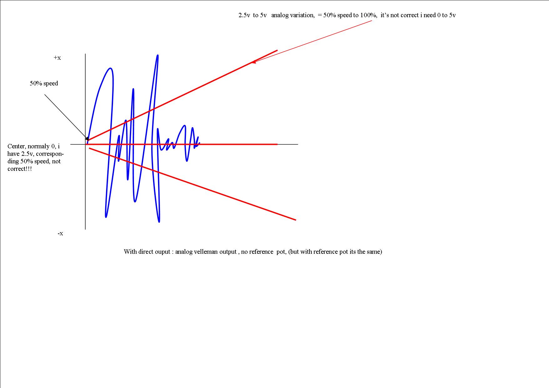

    i test just with 1 axis , in direct output my analog output velleman, no reference pot , i have 2.5v allways! no sequence direction nothing, just analog speed, i press start and i have 2.5v
    becaus the center axis send 2.5v in output.
    the information sens left , right and stop (2.5v) are send in the same output it's not correct in velleman card VM 110 or VM140 its the same problem. i think its the same problem with other card, the reason is XSIM just manage PWM simulator, output analog not suported....

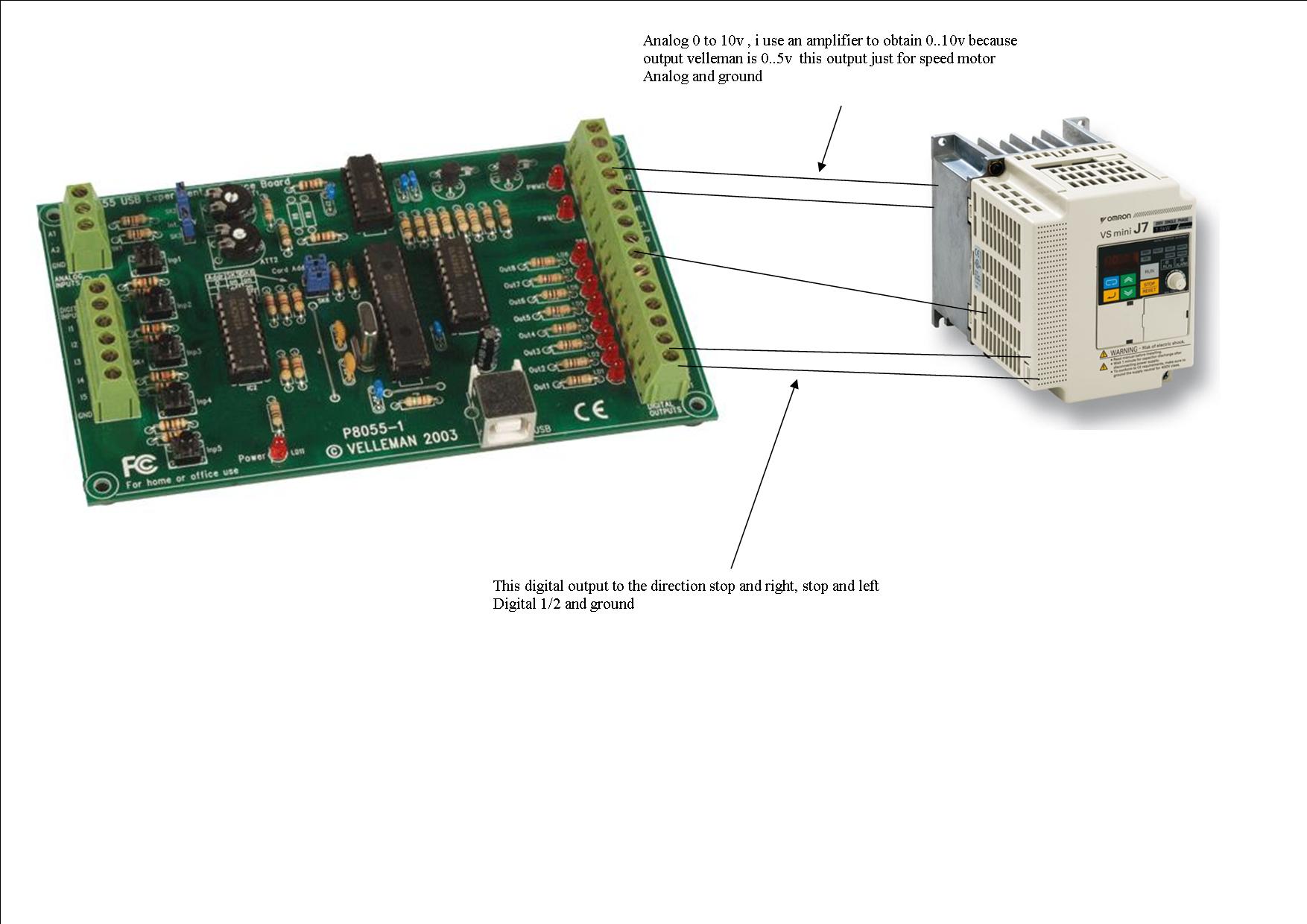

    yes it is
    Velleman card also has two analog output, 2 solution are ok
    PC -> welleman card (PWM gets converted into analog voltage) -> analog voltage output -> AC motor driver -> power to the motors proportional to analog input.
    welleman card (SYNAPTRIX SEQUENCE FOR DIRECTION MOTOR) -> DIGITAL OUTPUT ->AC motor driver -> DIRECTION motors.
  13. riton

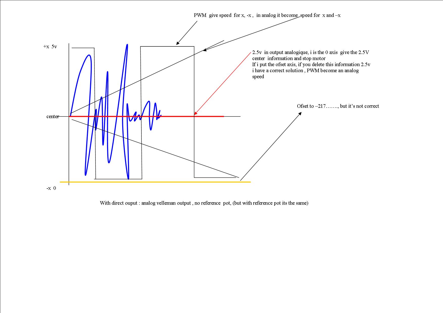

    actual bad solution :
    good solution:
    I repeat my problem:
    with all the tests possible, I have the same problem:
    I have a fixes volltage in Analog Output Card velleman = 50% = 2.5V to the stop reference PWM , and it's not correct to manage my speed
    no no, its not correct its verry verry easy
    direction by the digital output
    speed analog output
    is very simple, very easy
    There is nothing complicated

    I assume you have separate direction outputs from the X-Sim, right?
    With a PWM signal, you can only transmit a value from 0% to 100% duty cycle.
    Your in-game force data will be scaled to fit in this number, therefore:
    -128 = 0% = 0V
    0 = 50% = 2.5V
    127 = 100% = 5V
    You have to offset this number so you get
    0 = 0% = 0V
    127 = 100% = 5V
    If you have to determine direction from the PWM signal, more processing needs to be done.
