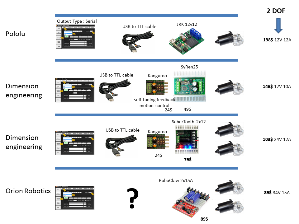

    I compared prices and specs (V and A) for a 2 DOF... interesting :)
    but I'm not used to these motor controllers:
    so I'm not sure about interfaces, could you please correct it if needed?
    Nota : Roboclaw cannot use Hall pot
    __________________________________________________________

  3. eaorobbie
    20,506Coins
    +1,687 / 23 / -2
    Adding in peak current too could help people making a decision.
    Ah Kangaroo needs a DLink2 to convert serial to dual rc signal , that's what mine came with from dimension.
    http://www.dimensionengineering.com/products/delink warning picture shows the older card.
    Better comparison if all produce the same constant amps levels too, a truer comparison.
    Well done , do like.
  4. RacingMat
    2,233
    21,088Coins
    Amps are the closest as possible... sadly no exact matching indeed!
    I'll add peak values ;)
    About Kangaroo, I haven't seen the Dlink mentionned in the @BlazinH's tutorial...
    @eaorobbie Are you sure it's mandatory?
    Maybe only if the Kanagaroo is setup as RC interface...
    How many people succeeded in using Kangaroo?
    I have seen also Abdul's post here
  5. telfel
    telfel Active Member
    Feb 16, 2011
    170
    4,739Coins
    +118 / 3 / -0
    hi @RacingMat
    The Dlink or a usb to ttl converter is required to connect the kangaroo to pc via usb,
    The new Sabertooth 2x32 has built in usb to connect to the pc, then connect the signal lines from the sabertooth to the kagaroo, so then the usb/ttl converter for the kangaroo is not required. (from the 2x32 manual)
    regards Terry

    Hi Everyone! Thanks for your input. I have deduced a conclusion based on the current information we have available at the moment.
    First, there appears to be contradictory information in the documentation supplied from Orion. One is on potentiometer usage. One place it says pots can be used in analog and rc mode and in another it says you can’t. Also in one place it states that you shouldn’t use this controller with fast direction changes and in another it says you can. This may have something to do with different versions of the RoboClaw family however.
    But lets assume that the document is correct that says you can use position mode with serial, analog, and rc modes. Well, while they say position mode will work with analog and rc modes, they must not expect anyone to do it because all the doc tells you is how to set the RoboClaw to position mode, not how to use it with them! But if we don’t want to use an arduino with this since it defeats the purpose; unless simtools can output a voltage or servo pulse (it can’t), then that leaves analog and rc mode out of the picture anyway. That just leaves serial mode then. In serial mode we do have a little information on how to use position mode with it. It is what I posted in a previous post from Orions pdf and appears to be the only command for position mode along with #66 for motor M2.
    All you have to do is read this and it is appears clear that this will not work with motion simulators! As with most all of these controllers, they were designed to drive robots and wheeled vehicles; and not with motion simulators in mind. It appears the pid settings are for speed and holding purposes only. Velocity pid settings for moving, and position pid settings to hold in current position.
    My assumption is that positioning works similar in analog and rc modes as well! However, if you were able to substitute a voltage or servo pulse as an absolute position instead, then with an arduino, this still might be a viable option if the pid control would work as a servo controller.
    Also I noticed that the jrk is referred to as “ a closed loop servo system”, not merely “closed loop position control”! Any controller stated to be a servo controller should work for simulatiors, but not necessarily one that is for position control.
    As per usual, I reserve the right to be incorrect though! :D

  9. RufusDufus
    RufusDufus Well-Known Member
    Jul 21, 2013
    681
    Adelaide Australia
    16,501Coins
    +1,016 / 10 / -1
    Well what I was really trying to say is the “control interface” does not seem to be “ideally suited” for motion sims. I think there is a bit of work required to get them going which could end up costing more than other solutions.
    If you want to use as a H-Bridge together with your own Arduino (or similar) PID controller I would say the easiest way is to put it in the simple serial mode. You would change your Auduino code to simply output a serial byte instead of a PWM duty cycle and dir pin – the software serial library should be fine for this. Basically translate the -255 to +255 PWM output value to a 1 to 127 value for motor 1 and to a value of 128 to 255 for motor 2. So the resolution is much less but because it has its own speed control built in maybe isn’t an issue. Also I’m not sure how responsive the internal speed control PID algorithm is so again this may have a side effect.
    If you wanted more resolution you could do the same with the packet serial.
    The built in motor position modes (using packet serial) appear to work by counting the encoder pulses to determine motor position. While this is a valid solution and used in many control systems the disadvantage is that you have to somehow set the start center position at startup, I couldn’t find any info on this – In robot applications it would simply be the position you are in at startup so not a big deal in that type of application I suspect.
    If you can get the packet serial mode and position encoders working then you could look at using the USB and communicate from Simtools – It would appear to be basically just a serial port like an Arduino when the windows driver is installed. The challenges you will have here are again getting the start position set, but also the packet serial mode needs a checksum on the data packets so Simtools would need to be modified to do this – as far as I know this is not currently possible in the interface output string.
    Given there doesn’t seem to be any real world examples supplied it really comes down to testing and seeing what you get… may be fine.
