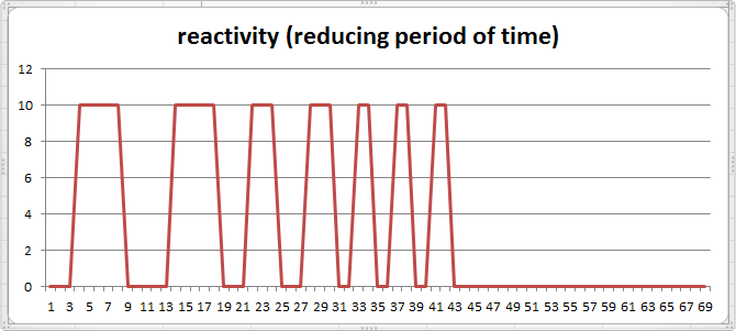

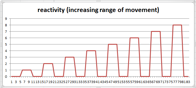

  9. RacingMat
    2,233
    21,088Coins
    Yes, benchmarking would be a nice (and challenging) feature ;)
    I was wondering if Simtools could play a "standard" serie of data with shifts that would be noticeable (or not!) on the sim.
    By using this smart tool from @RufusDufus, we could look if the signal replicated physically.
    http://www.xsimulator.net/community/threads/simple-digital-scope-for-motion-sim-testing.5485/ :cool:
    The calibration signal would send shifts that would have reducing period of time: does the sim has enough reactivity to follow the signal? We could visualize this. And counting the number of first visible periods could be factual.
    In a complementary manner, the signal could increase range of movement and see at what point the sim hasn't enough reactivity to reach the ends of movements:

  10. RacingMat
    2,233
    21,088Coins
    @value1 @yobuddy : Do you think it would be possible to make Simtools (or a plugin) play a preset of data to benchmark our sims?
  11. bsft
    @RacingMat , what do you mean "benchmark"? in actual motion in the unit? Or actual processing of data via the controller?
  12. RacingMat
    2,233
    21,088Coins
    Final result: actual motion via pots reading (as described by Rufusdufus)
    But this could let us to fine tune our sims through the whole processing chain
    - windows com port speed,
    - Simtools : delay of packet rate (ms) is it efficient to reduce it ? until when?
    - code improvment (Arduino),
    - voltage of power supply (12V -> 24)
    - using a battery in addition of PSU
    - using pot or hall sensor?
    - adding springs?
    - moving the center of gravity
    - changing the rod lentgh (shorter or longer)?
    - with or without additionnal loads (screens...)​
    things like this :D
