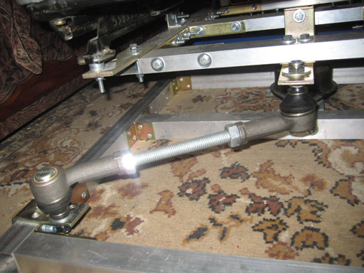

    Nice work so far. I see that you are getting alot of seat rotation. Your simulator will feel much better if you either use a universal joint or rods and ball joints (such as in the Frex) to prevent seat rotation.

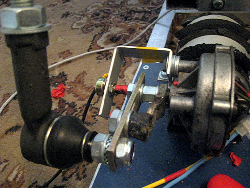

    Hi!
    To prevent rotation of seating we have used tie rod ends:

    Are you able to rotate the seat by hand if you try? Unless it's a illusion in the video, it sure looks like it's rotating somehow.

    Due to the geometry of the tierods, there is an inherent rotation associated with Roll. You cannot ONLY rotate the seat, the rotation comes with the angular movement of the base, or vice versa, depending on the force vector. The closer together you put the rod ends on the seat frame, the more rotation there is.
    Just picture the base on the above picture rolling to the right. Because the length of the tie rods cannot change and one end is bolted to the frame, they will push/pull on the seat base accordingly as it's angle (and also distance to the frame) changes. This will cause the yaw rotation when the seat tilts, or it will cause the seat to tilt when the seat is rotated, the two are tied together and their relationship depends on the geometry.
    This is a similar geometry to a 4point off-road suspension, except here only 2points are used with a fixed universal joint.

    However, the rotation looks like to be caused by a design flaw. I experienced this as well, and got rid of the rotation by changing the rod end positions.
    The rod ends on the seat frame should rather be connected together on a vertical screw, than side by side.
    As well the rod ends connected to the base frame should be aligned with the pivot.
    Other than that, the rubber pivot may be too soft perhaps.

    Thanks for the tips to improve our simulator. Tie rod ends that I use too big and difficult to connect at one point. But I want to try to connect them as closely as possible and move away from the pivot point.

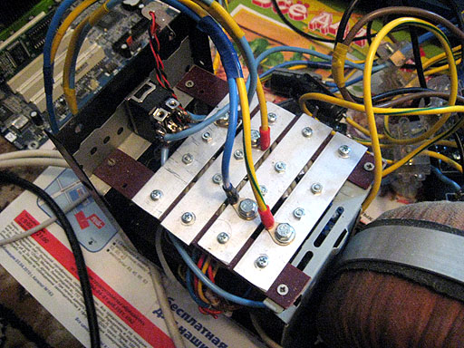

    We use Thanos H-Bridge with IRLZ44N mosfets. Now hbridge working properly. Another minor modification is that the motors are connected to the mosfet coolers to reduce electrical losses.
    Potentiometers are connected directly to the engine axis. This is temporary, as I'll put hall sensors

    benshelmars
    Thank you! :cheers:
    M10 at screw side and M14 rod side. From ford focus 1998-2005.

    I rebuild rods to prevent rotation. Very simply and its really work.

    Yes, this is the final design changes to limit the rotation. It's simple and it works. However, after the beta test, I decided something else changed in my sim. So I can not, at this moment to make a video. But I'm working on my sim all the free time and I hope the results will be soon.
